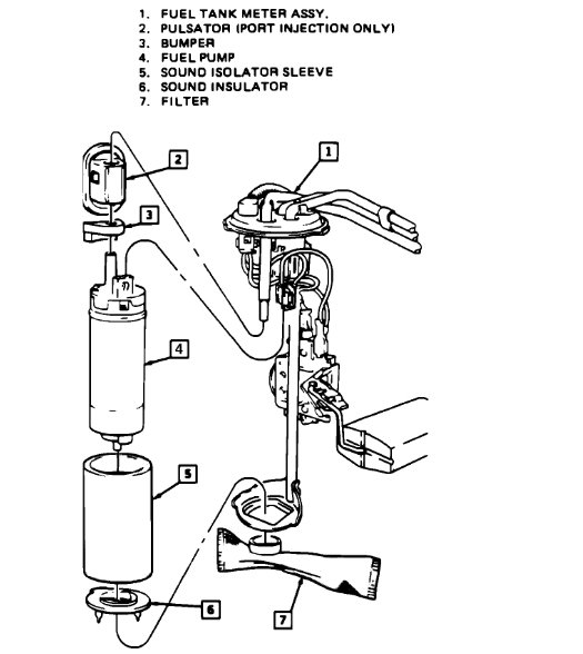

I can't figure out if there is an easier way to get to the fuel pump than dropping the gas tank. Also, where is the fuel pump located, in the gas tank or somewhere else?
Apr 2, 2019 at 5:55 AM
Good morning,
The fuel tank must be dropped and the pump is located in the tank.
