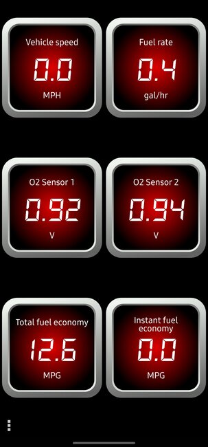

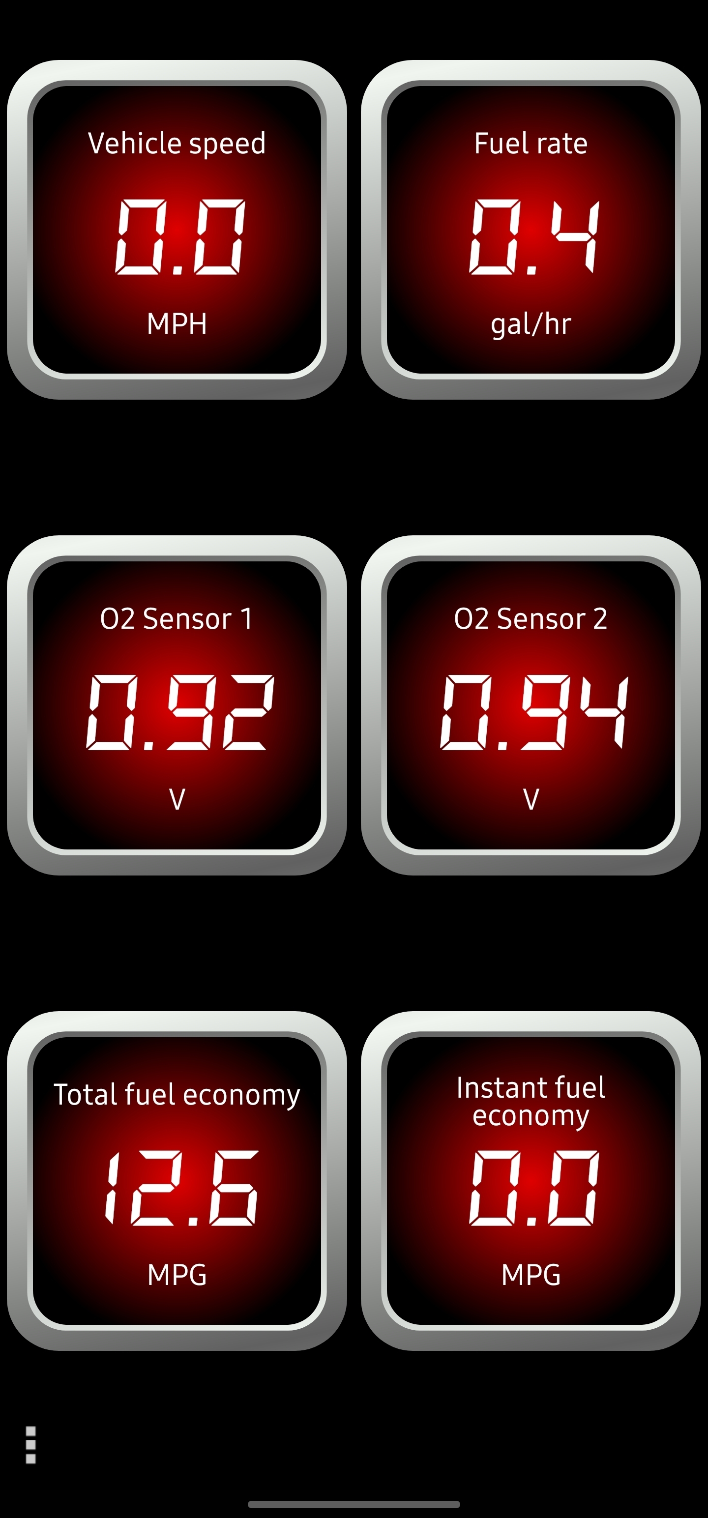

That was a lot of info that I really don't understand. I'm just a figure it out kind of guy, haha. But this is what the o2 sensors are reading at an idle.
Sep 25, 2023 at 4:37 PM

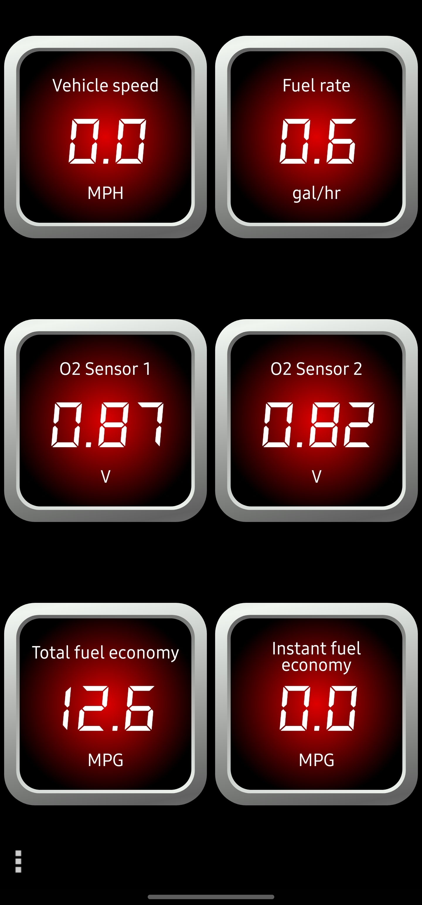

GMILLER
  • 13 POSTS
Sep 25, 2023 at 4:38 PM
GMILLER
  • 13 POSTS
As I'm sitting here it's getting higher.
Sep 25, 2023 at 4:39 PM
AL514
  • 5,587 POSTS
Are those voltage levels just staying at that level and slowly rising? The 02 sensor 1 is not fluctuating from 0.2 to 0.8v? And if you raise the rpm do the 02 sensor voltages, come down a little? You may be correct about leaking injector(s). Sorry about the overflow of info there. Do you see any data PIDs for Fuel Trims? and what are the other 02 sensors doing? It doesn't say whether these are the Bank 1 02 sensors, There should be a Bank 1 Sensor 1 and a Bank 1 Sensor 2, and then the same for Bank 2. A front and rear 02 sensor for each side of the engine.
Sep 25, 2023 at 4:45 PM

When I raise the RPMs the readings do go down.

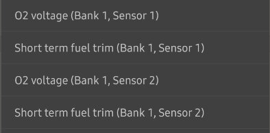

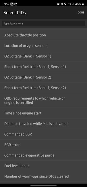

GMILLER
  • 13 POSTS

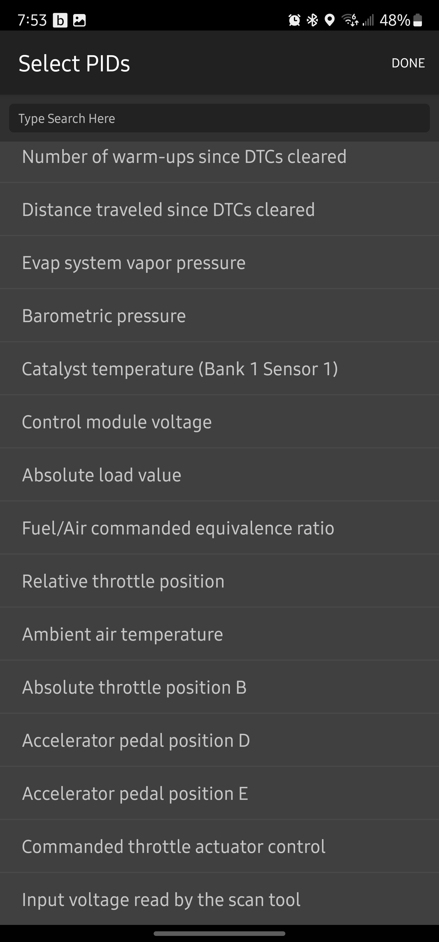

Here are my options on what to put on the screen. What should I select?
Sep 25, 2023 at 4:53 PM
GMILLER
  • 13 POSTS

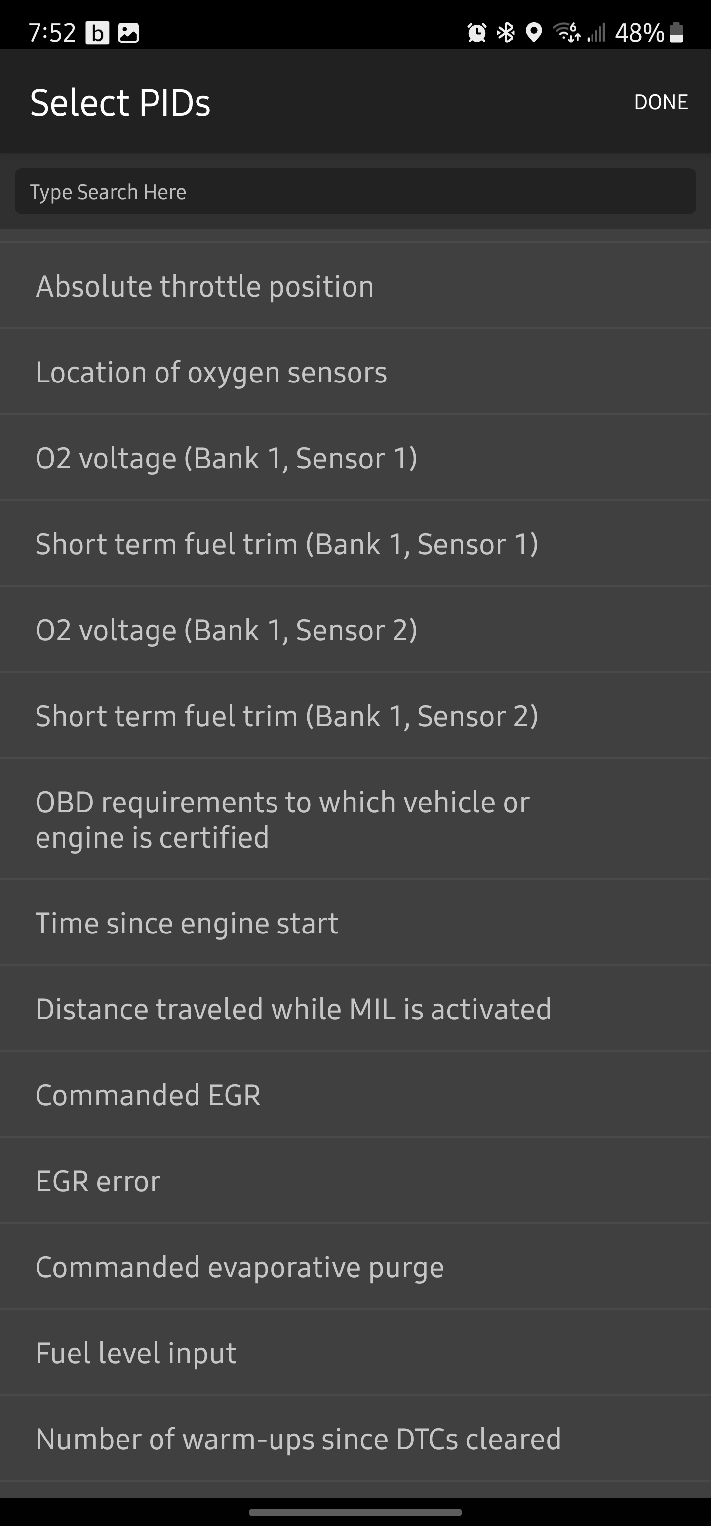

Or
Sep 25, 2023 at 4:54 PM

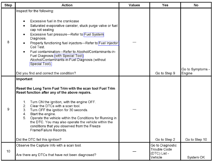

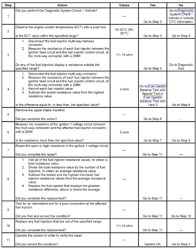

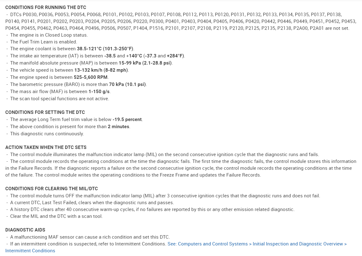

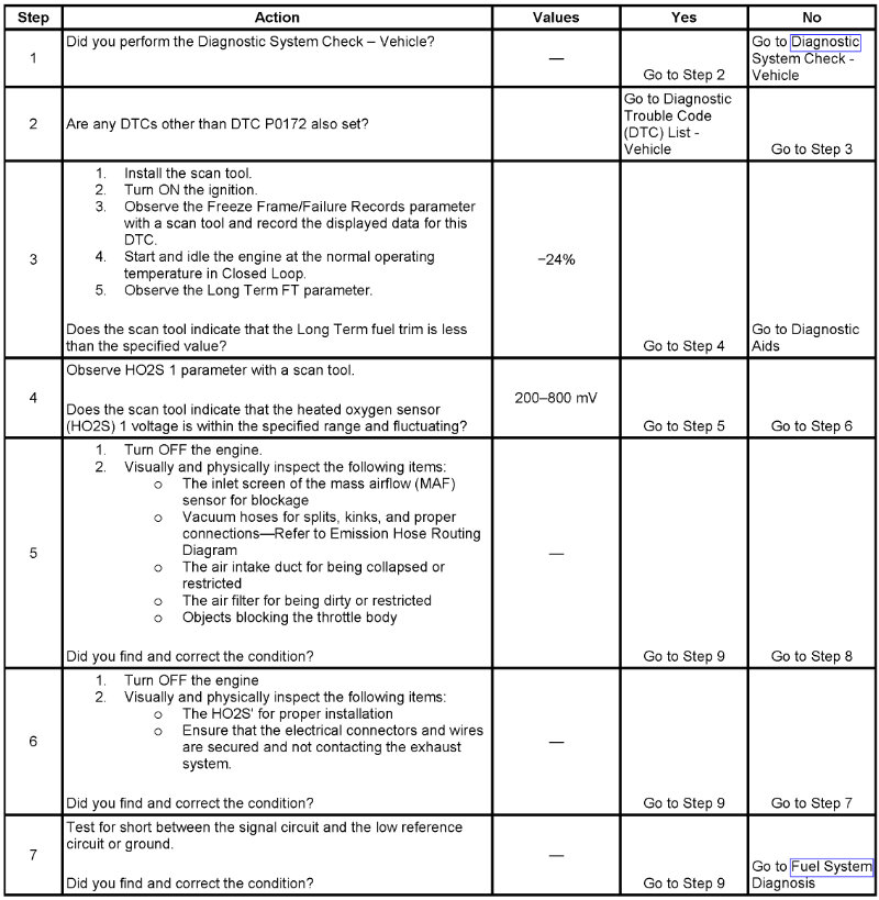

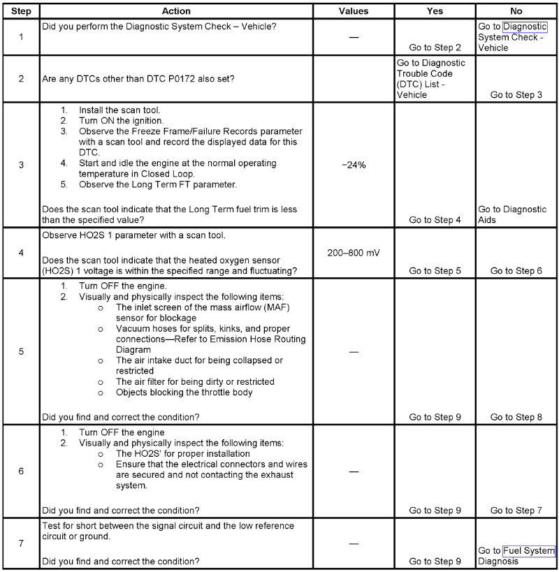

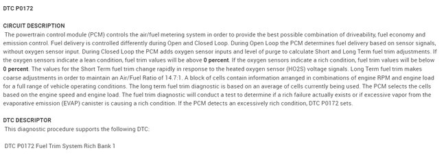

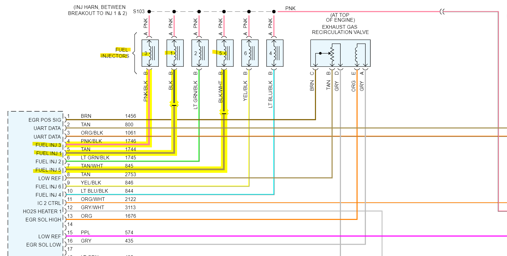

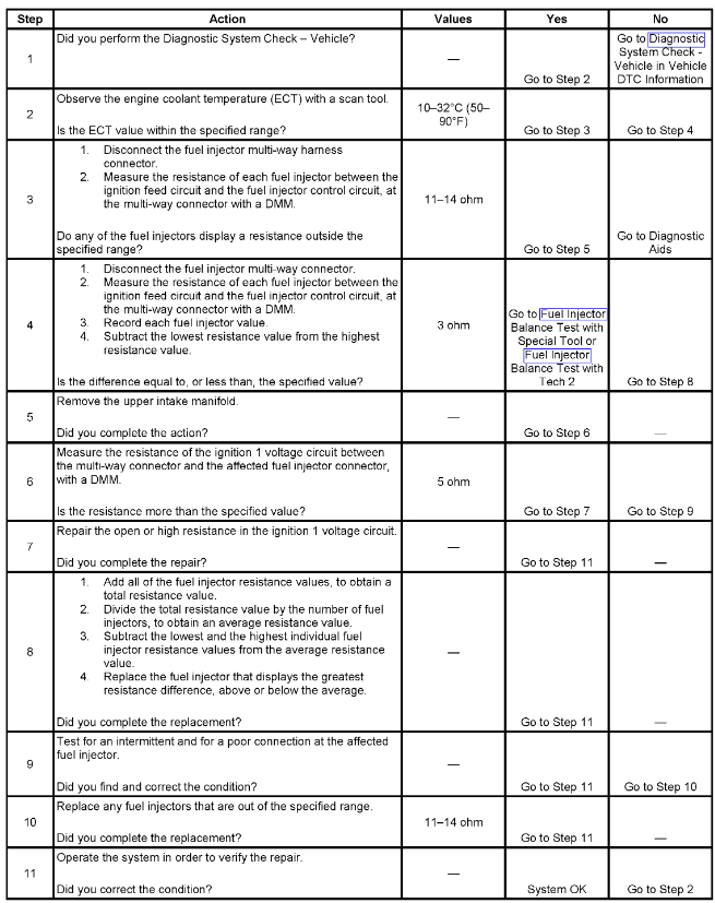

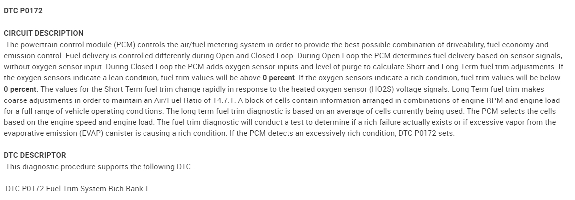

Here is some additional service info on this code and fuel injector testing, The wiring diagram shows you what the wire colors are for the Bank 1 injectors, you can try unplugging those 3 one at a time, it will cause a misfire, but won't damage the Catalytic converter. See if any of them being unplugged for a few seconds makes any difference. Those 02 sensors are definitely reading rich at 900mv.
With the 02 voltages going low, that means the higher rpm is able to use up the extra fuel somewhat. But this condition can damage the Catalytic converter if not repaired before driving too much more.
The only real way to check the flow rate is doing a balance test with the pulse tool. But it sounds like fuel pressure is dropping off a bit too quick. But you may find that the spark plugs are even wet on that side of the engine if the injectors are actually leaking down when the engine is off.
There should also be a Long-Term Fuel trim for Bank 1 as well.

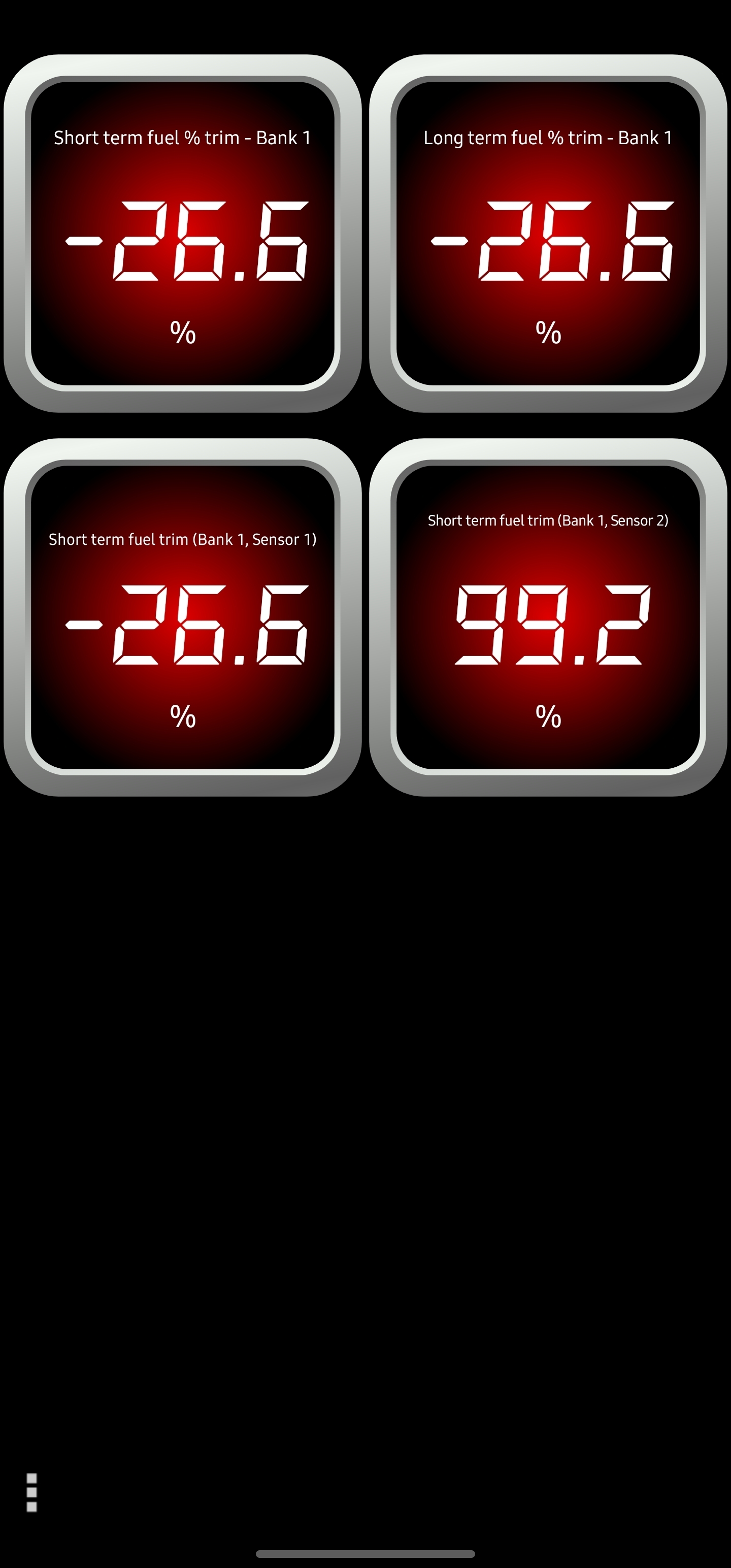

GMILLER
  • 13 POSTS
Sep 25, 2023 at 5:06 PM
AL514
  • 5,587 POSTS
Yeah, those numbers are maxed out rich. Do you have a voltage level for the Bank 1 Sensor 2 Oxygen sensor? I think the 99% is a substituted value, so if there is a high voltage reading on B1 sensor 2- 02 sensor, that's also shows an actual over fueling condition.
I will be back with you shortly, not sure what time zone you are in, but if you can check the spark plugs on that side without too much trouble it will help in diagnosing leaking injectors,
It looks like this vehicle has a mass air flow (MAF) sensor and a Map sensor, The MAF will read in g/s (grams per second) and should be around 3.4-4g/s at idle, so if it is over reporting air flow, such as 7-8 g/s of air flow, the ECM will add fuel to the mixture due to that, if there is a data PID for the MAF.
It looks like the 02 sensors are reacting to the rich mixture correctly but see if you can find MAF data (Mass Air Flow).
But the -26% is pegged out. With the front B1 sensor taking away so much fuel, and if you find that the B1 sensor 2 is reading 0.9v (900mv) as well, then you know there is way too much fuel being dumped into the intake manifold, your oil is now diluted with gasoline as well. So, you need to change your oil as soon as you figure out what's causing this.
