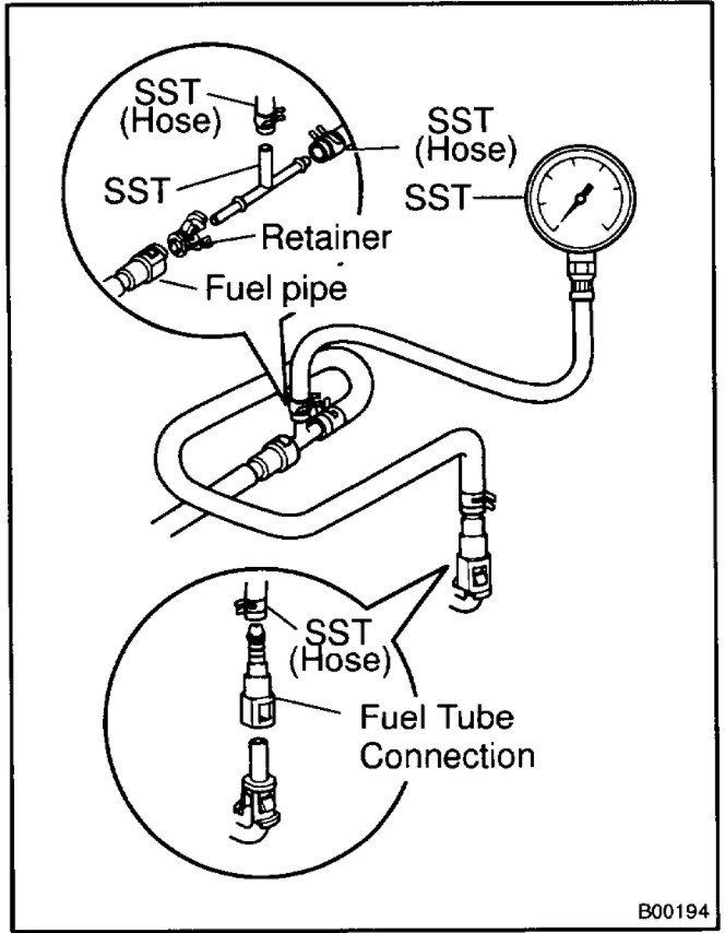

Where is the fuel pressure port located?

I have not been able to find the fuel port to test fuel pressure. Car has 170,000 miles.

That car doesn't have one, instead you need an adapter that connects inline to the fuel line connection on the fuel rail. It should be from 44-50 PSI. key on engine off.
