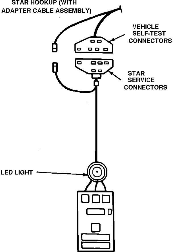

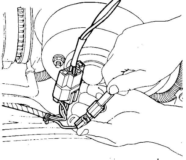

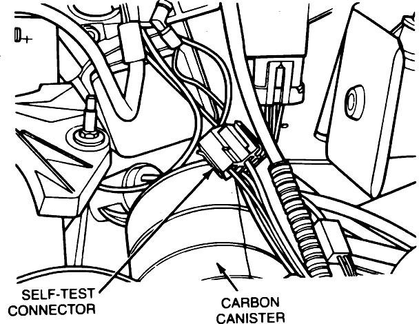

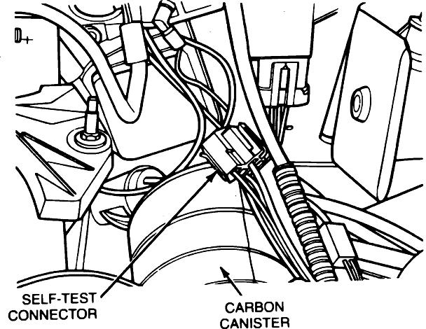

The way I would approach this is to run the fuel pump with the engine off so you can listen to the pump. Connect a fuel pressure gauge so you can see when the pressure drops. When it does, listen if the pump has slowed down or stopped running. If it has, we'll need to take voltage readings at various places in the circuit to see where the voltage is being lost. Current for the pump comes through two relays and the inertia switch. Those can develop pitted or arced contacts that impede current flow, and that type of problem often gets worse after warming up for a few minutes.
You might want to connect a small battery charger in case this test takes some time. Look for the diagnostic connector under the hood. From the drawings, it appears it is going to be near the battery. Along with that plug, there will be a single separate wire with a terminal on the end. That is the wire that must be grounded to turn on the fuel pump. Use a small jumper wire from that terminal and connect the other end to a paint-free point on the engine or body. The Engine Control relay has to turn on too, which means the ignition switch must be in the "run" position.
If the pump still sounds strong when the pressure drops, suspect the pick-up strainer.
