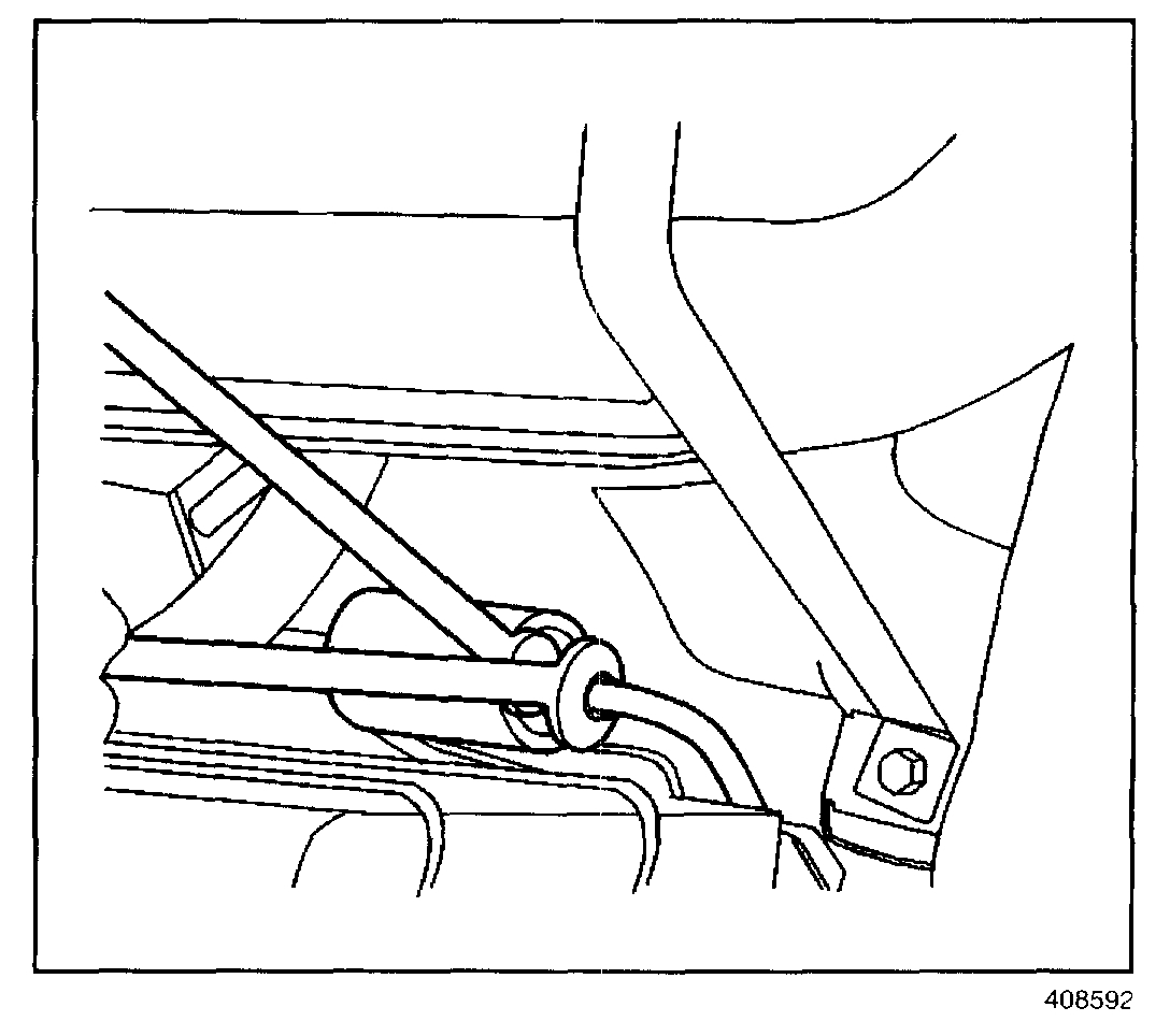

I checked my fuel pressure, key on engine off. Read (48 psi). Haynes manual said 52 to 59, key on engine off. I checked it also with the engine running, it read (40, 42 psi) fluctuating back and forth. I know the car has age. It doesn't seem to fall inspect or does it.
Nov 20, 2019 at 12:46 AM
  • 110,244 POSTS
The pressure is a bit low. Have you ever replaced the fuel filter? A dirty filter can cause this to happen. Also, there is a sock at the bottom of the fuel pump assembly that functions as a filter that can also be clogging. And of course, the pump may be going bad.

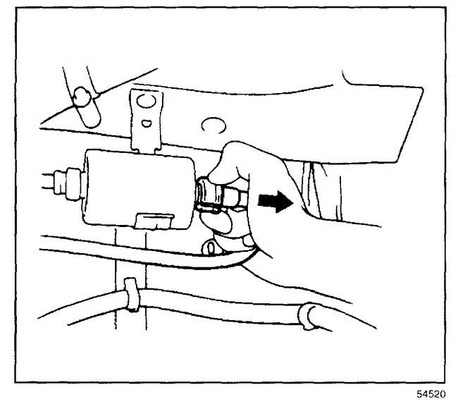

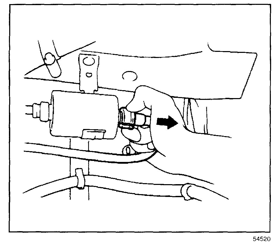

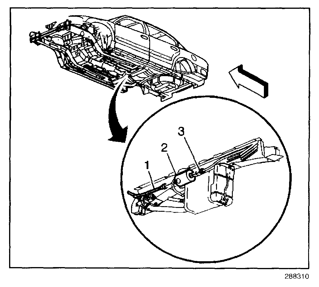

Here are the directions for replacing the filter. The attached pics correlate with these directions. It's a good place to start especially if it hasn't been done for a long time.
First, here is a link that shows in general how one is replaced:
https://www.2carpros.com/articles/how-to-change-a-fuel-filter
Here are the directions specific to your vehicle:
________________________________________
2004 Pontiac Grand AM V6-3.4L VIN E
Procedures
Vehicle Powertrain Management Fuel Delivery and Air Induction Fuel Filter Service and Repair Procedures
PROCEDURES
FUEL FILTER REPLACEMENT
REMOVAL PROCEDURE
IMPORTANT: There is no service interval for fuel filter replacement. Only replace the fuel filter if it is restricted. Inspect the fuel tank internally and clean the fuel tank if you find a restricted fuel filter.
Pic 1
1. Relieve the fuel system pressure. Refer to Fuel Pressure Relief Procedure.
2. Raise the vehicle. Refer to Vehicle Lifting.
3. Disconnect the fuel filter fitting using a back-up wrench.
pic 2
4. Disconnect the quick connect fitting from the fuel filter.
5. Remove the fuel filter.

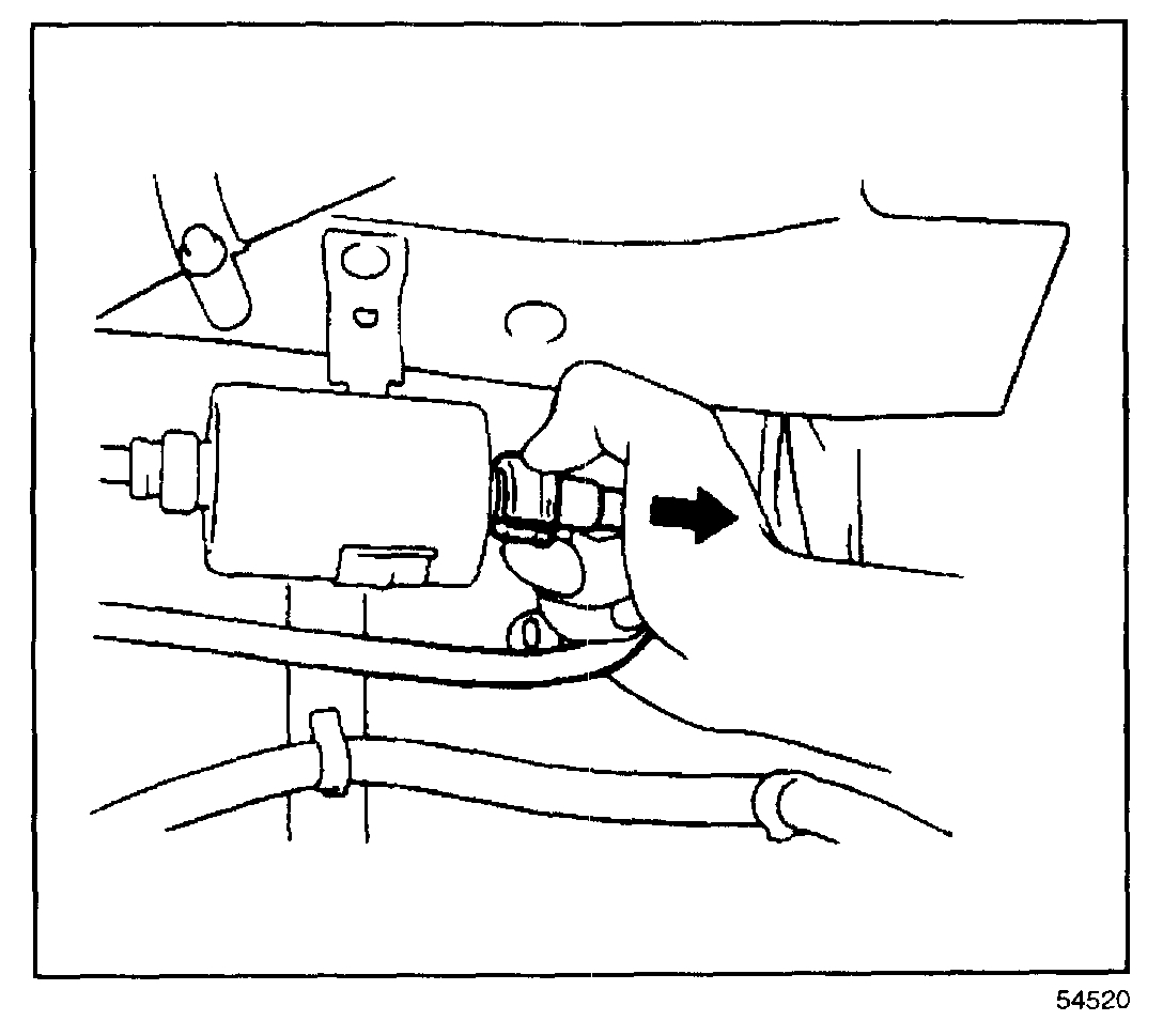

INSTALLATION PROCEDURE
pic 3
1. Remove the protective caps from the new fuel filter.
2. Install the fuel filter (2) in the same position as the old fuel filter.
3. Connect the fuel filter quick connect fitting.
NOTE: Refer to Fastener Notice in Service Precautions.
4. Connect the fuel filter fitting (3) using a back-up wrench.
Tighten
Tighten the fuel filter fitting to 27 N.m (20 lb ft).
5. Lower the vehicle.
6. Connect the negative battery cable.
7. Inspect for fuel leaks using the following procedure:
7.1. Turn ON the ignition, with the engine OFF for 2 seconds.
7.2. Turn OFF the ignition for 10 seconds.
7.3. Turn ON the ignition, with the engine OFF.
7.4. Inspect for fuel leaks.

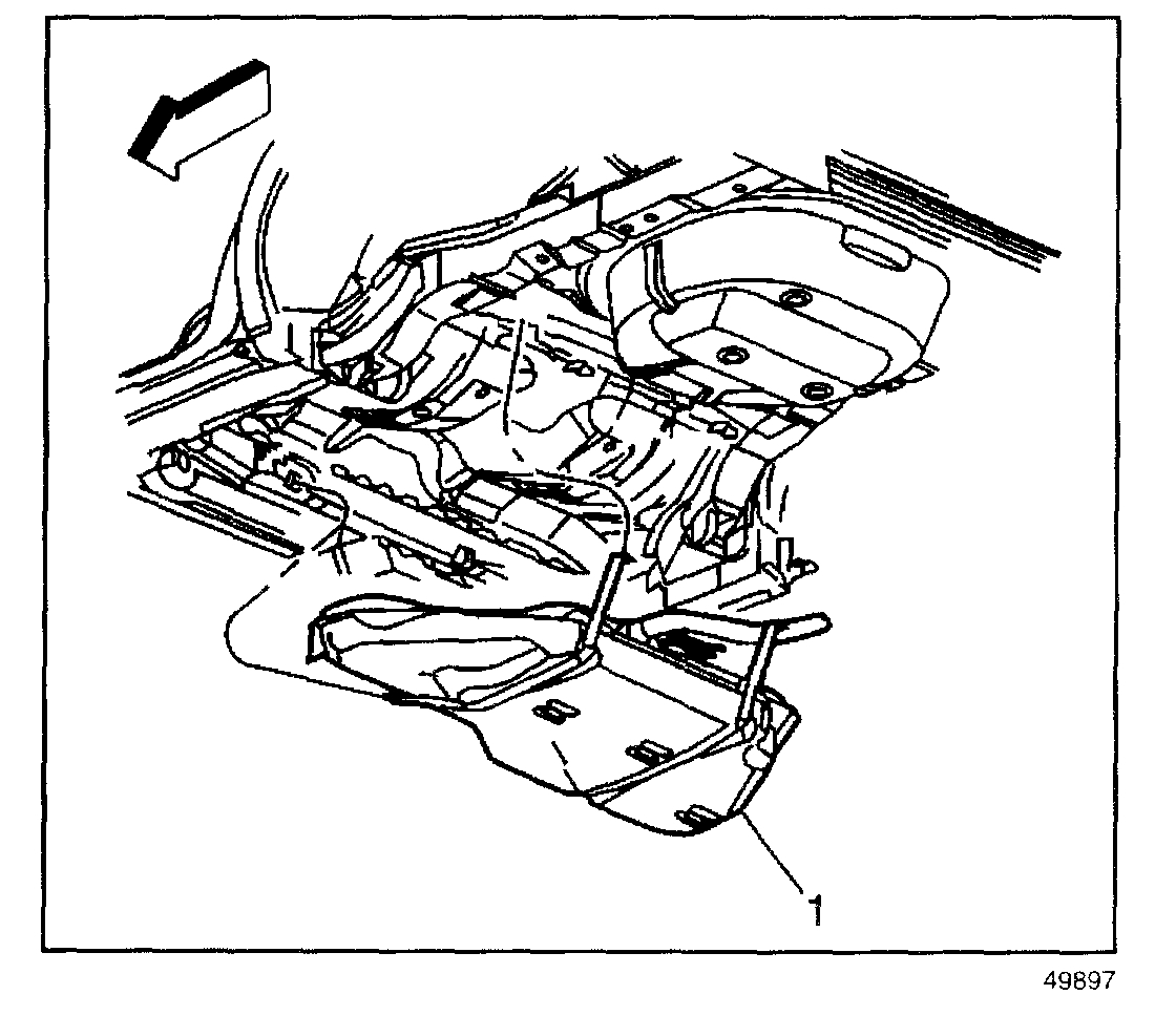

Thank you. This is very helpful. I have replaced the fuel filter back awhile and pressure regulator. I am considering the pump. Because with the car running it only has in between 40-43 psi. Haynes said there will be a 5 psi decrease under load. Those low 40s' seem too low. I'll keep in touch. Thank you and God bless.
Nov 20, 2019 at 6:42 PM
  • 110,244 POSTS

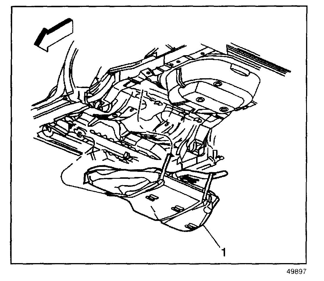

If you decide to replace the pump, the tank will need removed. Here are directions for tank removal and replacement. The attached pics correlate with the directions.
Fuel Tank Replacement
Vehicle Powertrain Management Fuel Delivery and Air Induction Fuel Tank Service and Repair Removal and Replacement Fuel Tank Replacement
FUEL TANK REPLACEMENT
REMOVAL PROCEDURE
pic 1
2. Drain the fuel tank. Refer to Fuel Tank Draining Procedure.
3. Raise the vehicle. Refer to Vehicle Lifting.
4. Disconnect the quick-connect fitting at the fuel filter.
5. Disconnect the fuel return pipe quick connect fitting.
6. Remove the rubber exhaust hangers. Allow the exhaust system to rest on the rear axle.
7. Remove the exhaust heat shield.
8. Loosen the fuel filler hose clamp at the fuel tank.
9. Disconnect the fuel filler hose from the fuel tank.
10. Disconnect the evaporative emission (EVAP) vapor pipe from the EVAP canister.
pic 2
11. Disconnect the electrical harness from the multi-way rear body connector and fuel strap.
12. With the aid of an assistant, support the fuel tank (1).
13. Disconnect the fuel tank retaining straps.
14. Lower the fuel tank.
15. Remove the fuel sender assembly from the tank.

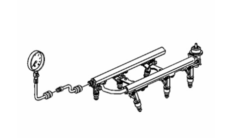

on the 2004 Pontiac Grand Am fuel system, do they have a place where fuel pressure can be checked?
Nov 25, 2020 at 10:18 AM (Merged)
DOCFIXIT
  • 18,828 POSTS
Schrader valve on fuel rail
JDL
  • 16,098 POSTS
I'd have to look at it. I believe you have to use a special fitting and gage. Note the picture.

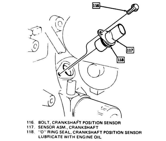

I have excessive fuel pressure will this damage the fuel regulator? I have put on a new fuel pump, a new pressure regulator, new coil pack. The car stills backfires and idles rough when I first start the car. And stalls when driving but starts right back up.
Nov 25, 2020 at 10:19 AM (Merged)
Good afternoon,
What is the exact fuel pressure?
Did anyone check the spark?
https://www.2carpros.com/articles/engine-stalls
CAROLYN SCHULTZ
Went up to seventy when backed off then goes down to thirty but when you start car goes to forty. Yes, checked the spark. it has a new coil pack.
When you block it off, the pressure will and should rise.
The regulator's job is to maintain the pressure for the engine.
I would suspect the crank sensor for the issue.
1. Disconnect crankshaft sensor harness connector from sensor.
2. Remove crankshaft sensor to engine block bolt, then remove the sensor, Fig. 5.
3. Reverse procedure to install. Replace sensor O-ring if worn or damaged, lubricating new O-ring with engine oil prior to installation. Torque crankshaft sensor to engine block bolt to 88 lb in.
CAROLYN SCHULTZ
Thank you Roy that was it.
