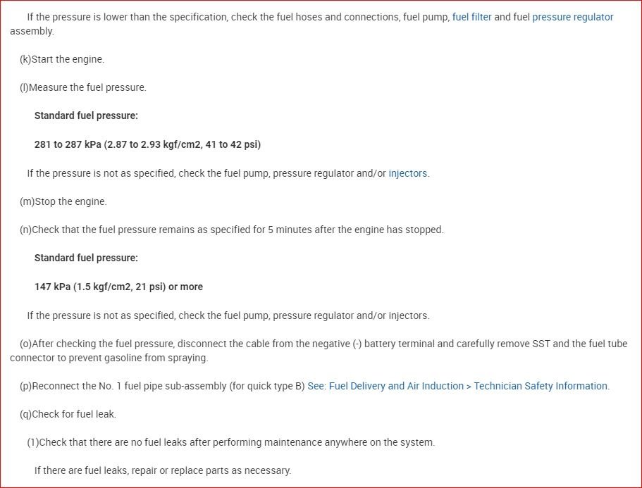

Where is the fuel port for the gauge?
May 30, 2019 at 3:04 PM

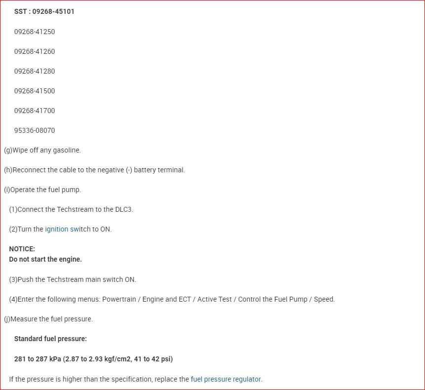

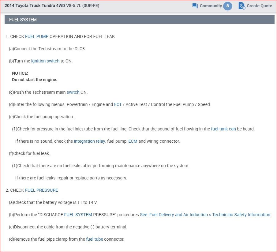

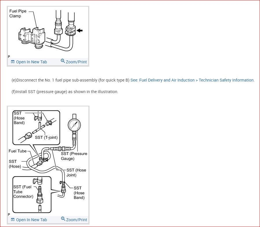

I assume you are referring to the schrader valve that is normally on the fuel rail that you screw the gauge into?
If so, I attached the instructions on how to hook this up on your vehicle. Unfortunately it does not have one of these valves. Instead you will need the specific tool to put in line in order to monitor the fuel pressure.
Let me know if you need anything else and I will be happy to assist. Thanks
