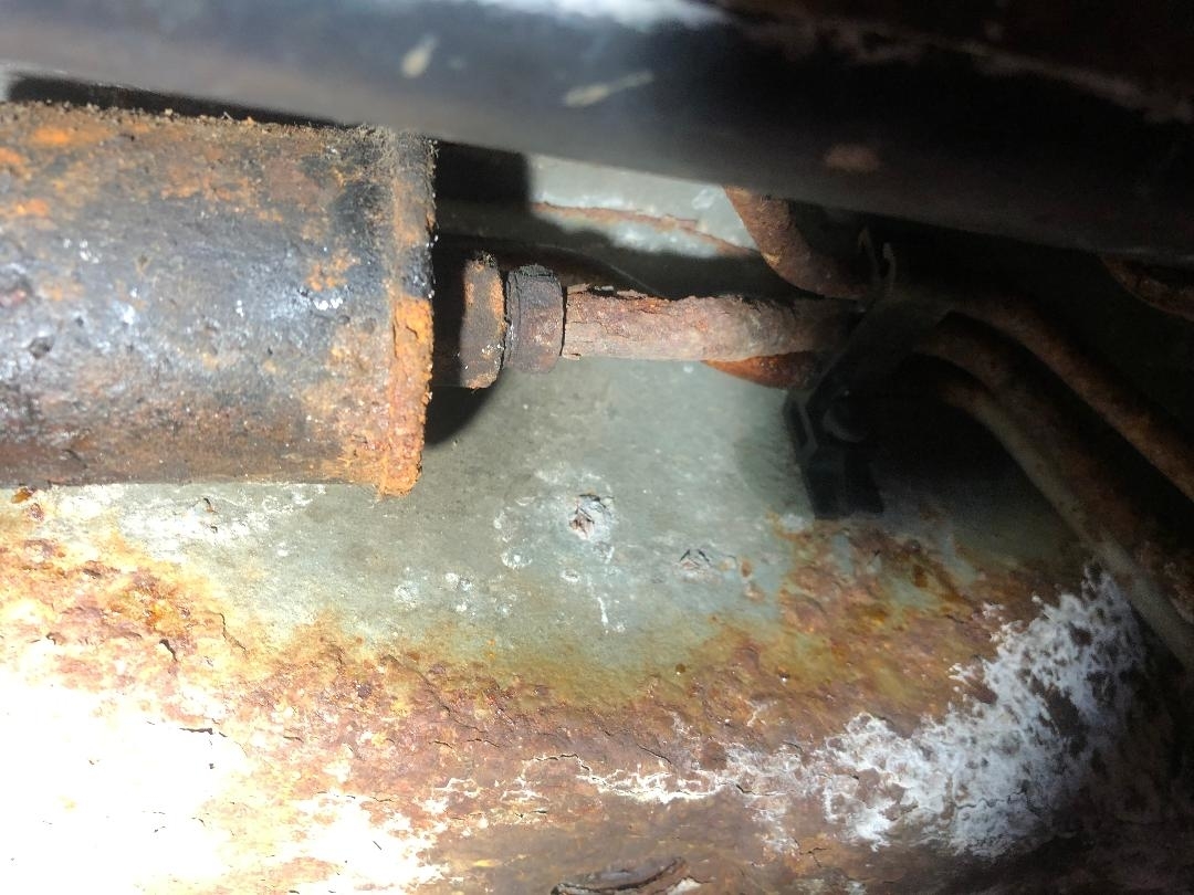

well, i got back to the place and they took some pictures for me. it looks to be leaking by the plastic connector. the line going back to the tank looks quite rusted too. it looks like that is the original filter. i may have someone find good steel and splice the rear (with new connector) maybe with a new filter the front will be okay? might just be a shot o-ring.
pretty isn't it? advice would be appreciated. Don

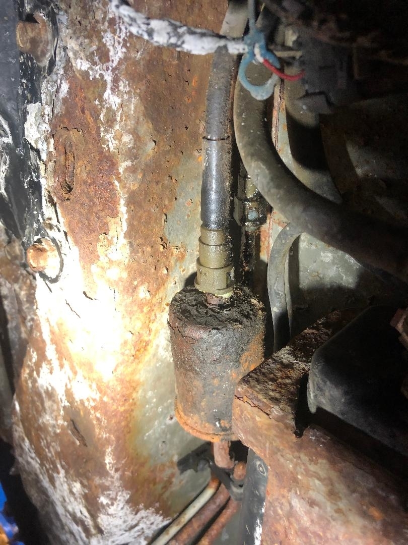

in photo two it looks like the fuel may also be leaking at that quick release. where does that run and can that release be changed?
Feb 16, 2019 at 7:54 AM
DCKELLEY
  • 125 POSTS
the one "behind" the filter.

That is a wee bit rusty. I would change the steel line and filter. The quick connect might be seeping due to the rust on the line. They can be changed but you can also replace just the inner o-ring if they leak. What you have there are three lines. One is the fuel line with full pressure, it is the one with the filter. Then there is a fuel return line, that is the one tighter to the frame. Plus there is the EVAP line, that one carries fuel vapor from the tank. That one will turn on the CEL if it leaks.
Have seen them a lot worse though.

STEVE W.
  • 15,356 POSTS
The line goes from the filter back to the in tank pump. There is a quick connect at that end as well. If you want to replace it and use a line that is easier to deal with than the OEM steel you could opt for NiCopp alloy line. It is a nickle copper alloy. It bends and flares like copper tubing but can be used for fuel and brake lines. It's more money but it is really easy to work with and it doesn't rust. I've replaced a lot of brake, fuel and other lines with it. It also has the ability to be polished so it looks like gold!

The connectors they used are pushed into the tubing with barbs to seal them. There will be a short rubber section that has the fitting for the steel to attach.
FINELINE makes a full replacement line set for your car FL251B Runs about $140.00 Gives you all three of the lines, new filter and is a plug and play item. The lines are all pre bent and come as two pieces so they fit without a big fight.
Rock Auto carries them.
