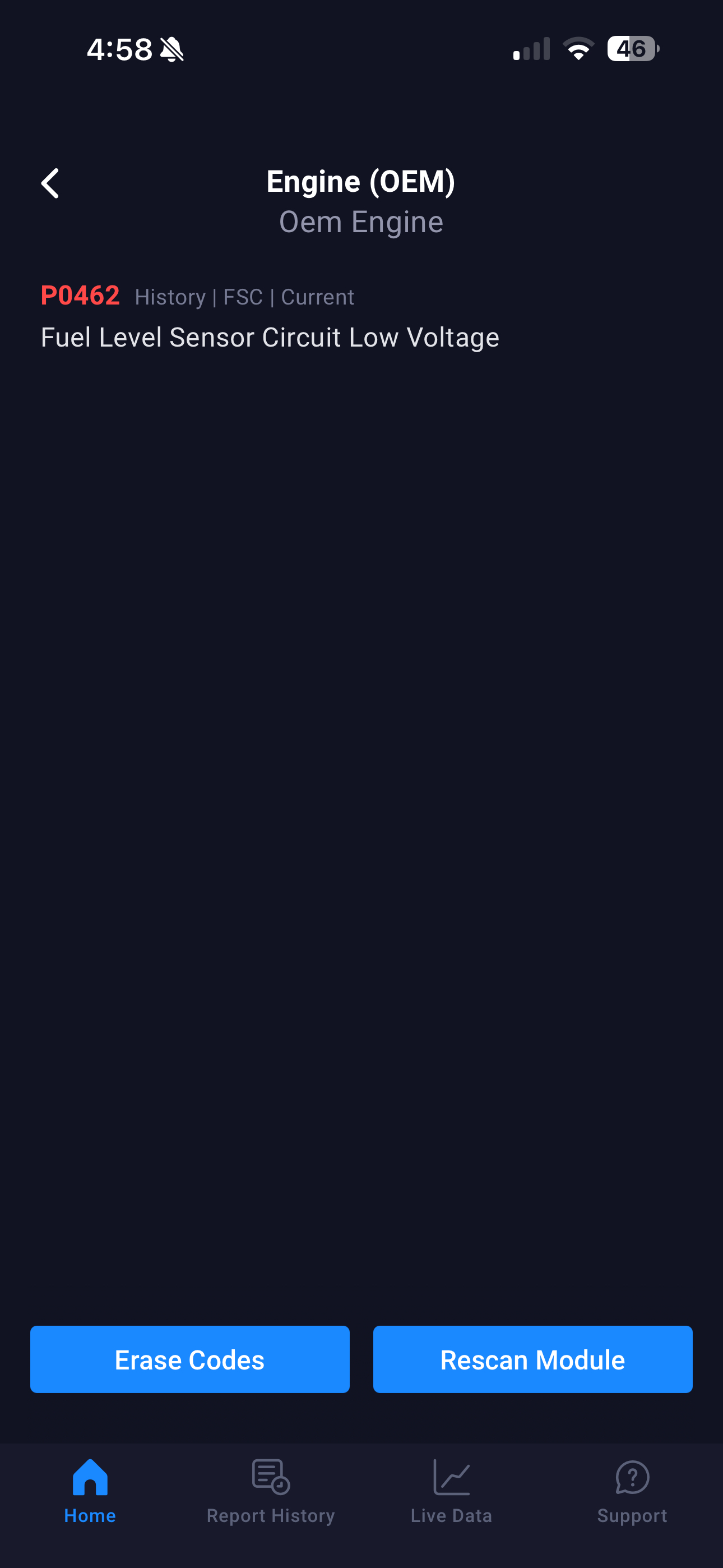

I have a PO462 and with it, my gas gauge stays at empty. I have checked my grounds and every is all good. Maybe I may have a shorted wire on the fuel tank harness OR I may have a wire crossed. Would a wiring issue cause a PO462? I have a brand new OEM fuel pump on btw

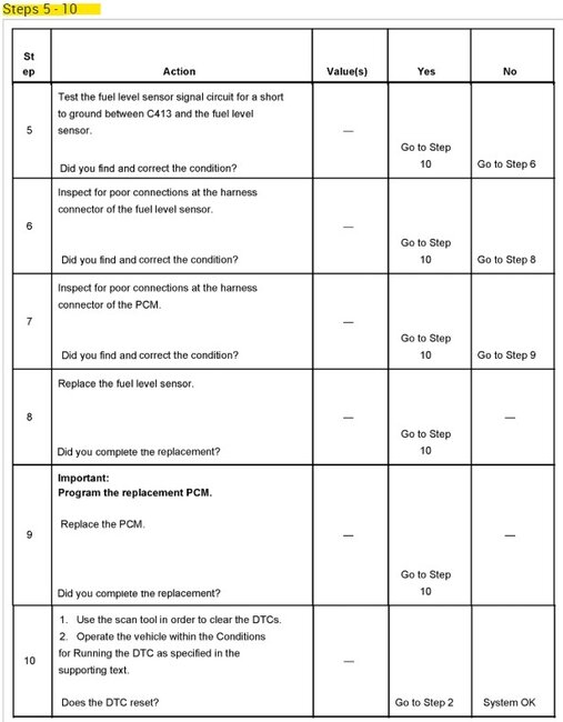

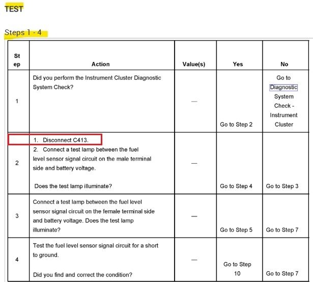

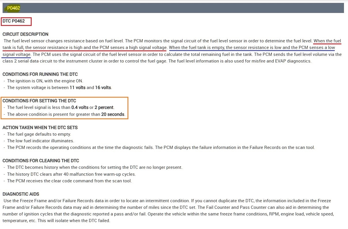

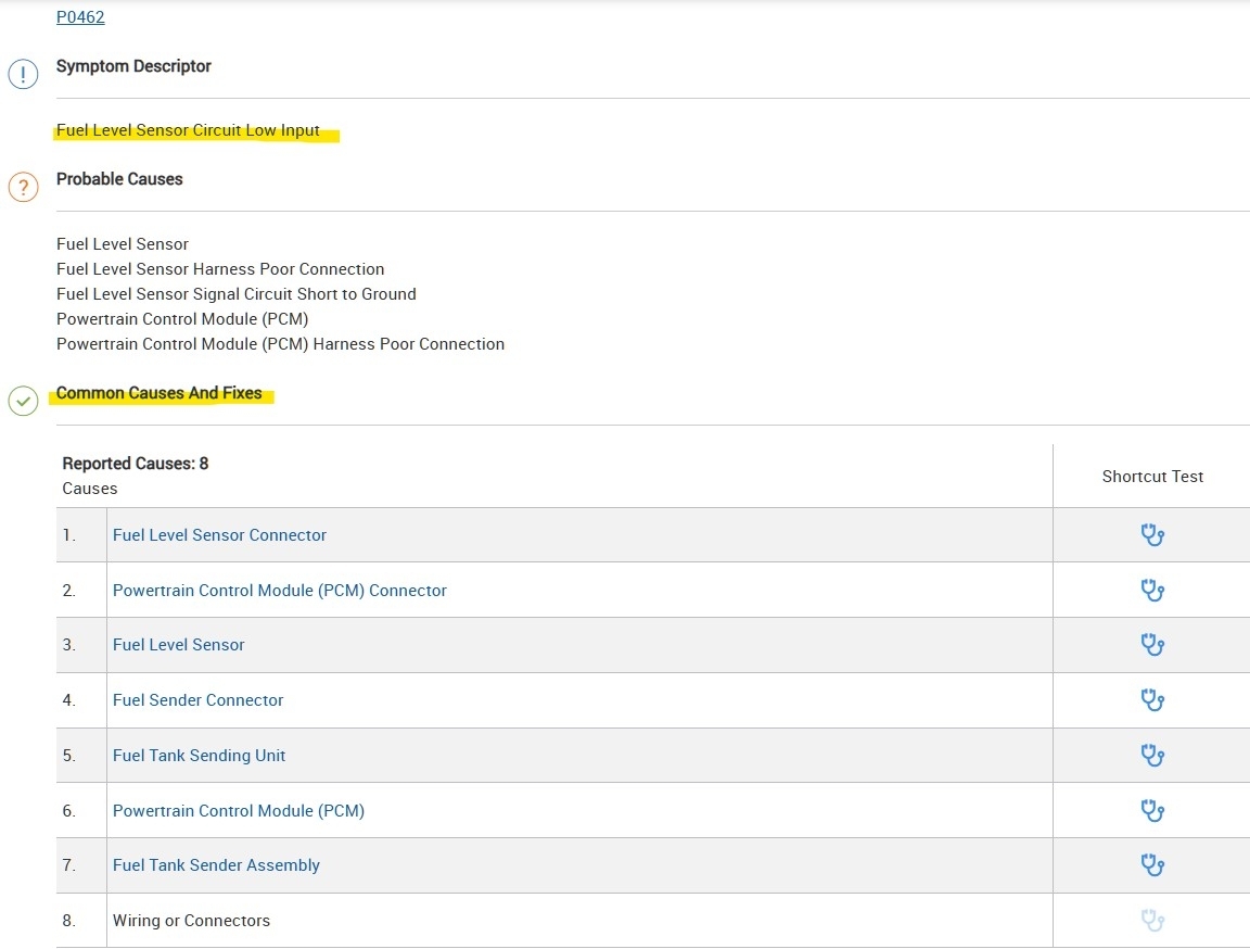

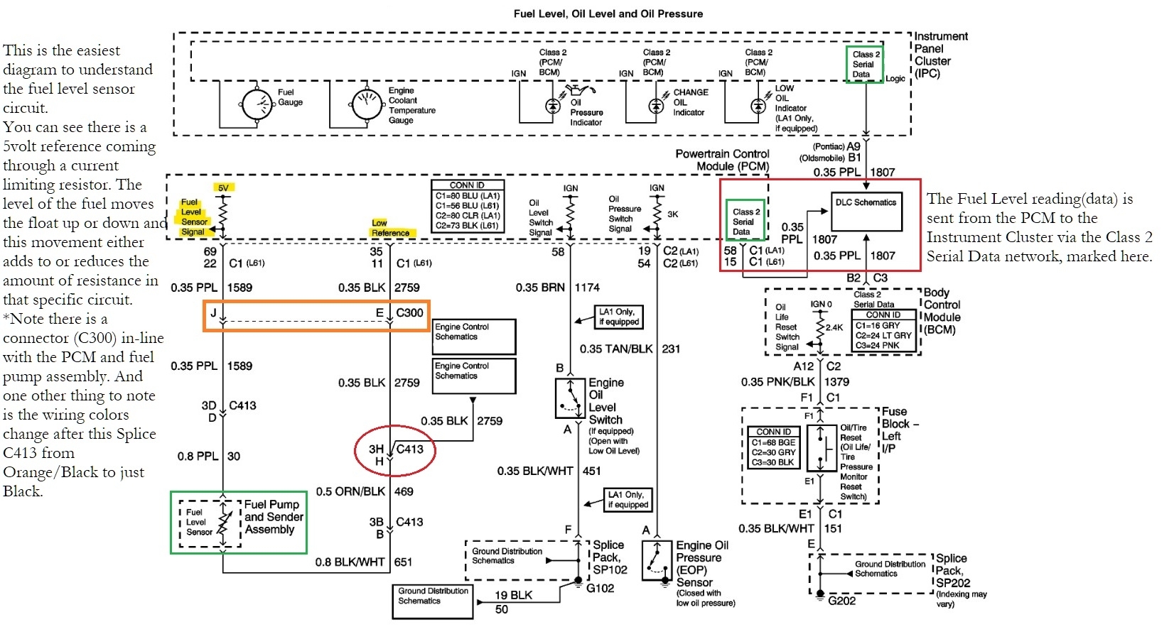

Hello, a wiring issue can cause this code, the PCM (engine computer) is seeing a low voltage reading for the fuel tank level sensor, (the code setting criteria is a voltage reading of below 0.4volts (400mv). The fuel level sensor works by having high resistance threw it when the gas tank is full and the resistance lowers as the fuel level lowers.
*What was the reason for replacing the fuel pump assembly first? And did the fuel level gauge work prior to replacing the new pump?

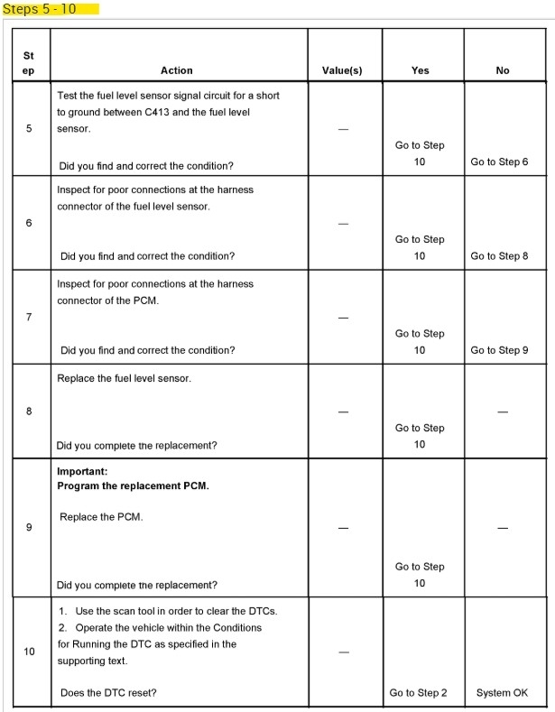

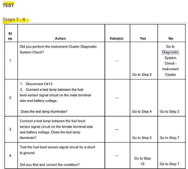

I will post the code flow chart to help give some direction, but if the fuel level sensor worked before replacing the pump, then either the new pump assembly is faulty, there is a wiring harness issue (ie the connector at the pump has a pin fitment issue), etc.
If you can reach the fuel pump connector easy enough, try plugging in the old fuel pump assembly, move the float level up and down and you should see it change the fuel level on the instrument cluster, if you do, then you know its not a wiring issue up near the instrument cluster, either way you will have a better idea of what the fault may be. Ill post some service info for you here in a minute. Retrace your steps.

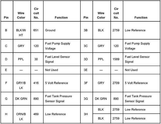

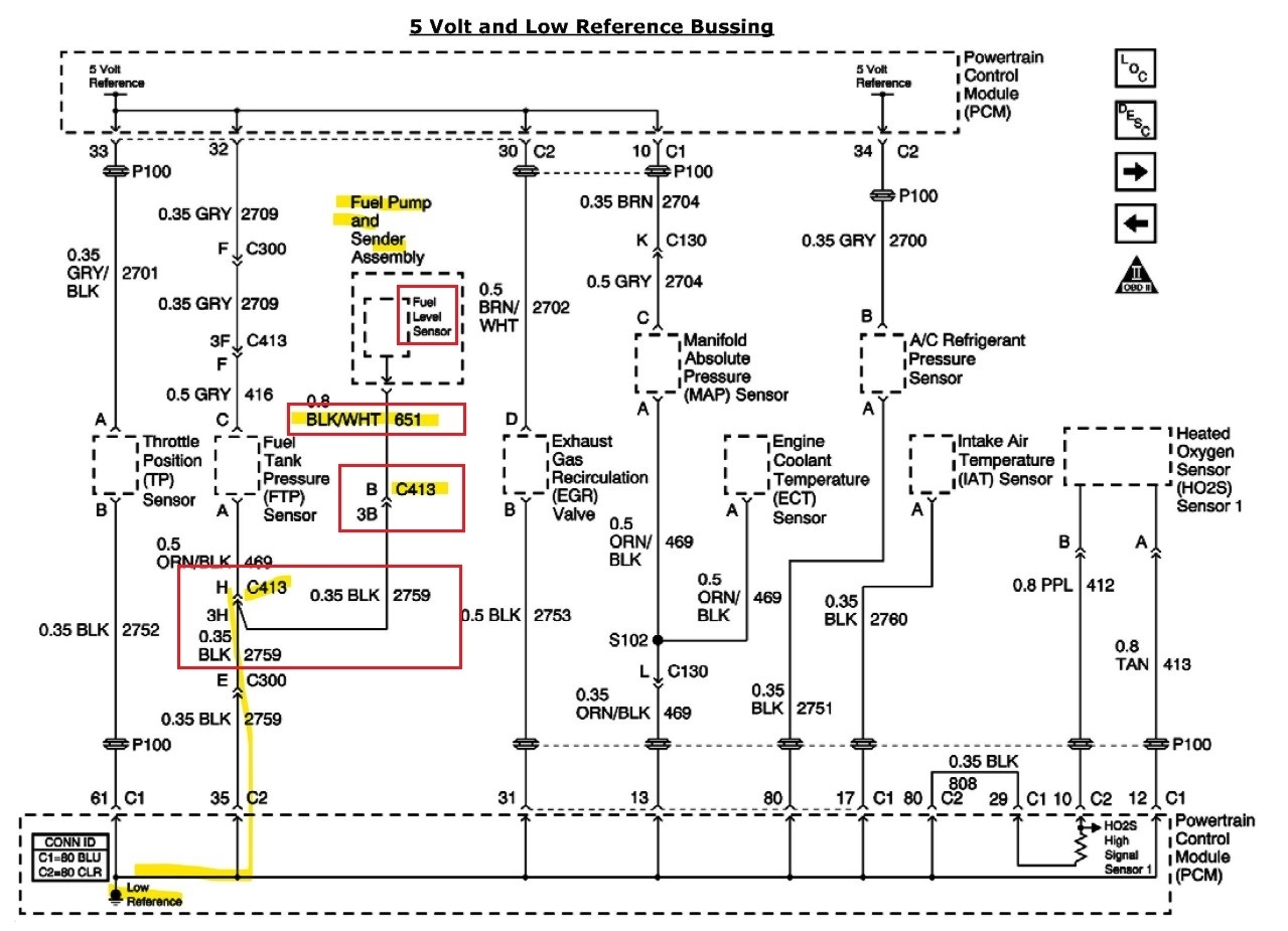

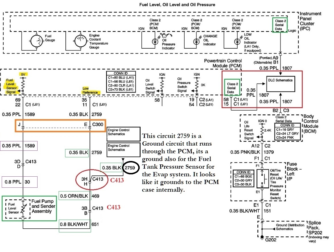

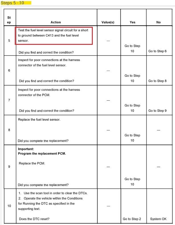

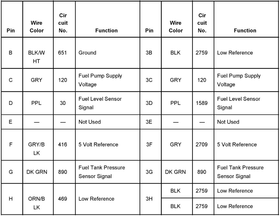

Here is the code setting service info, along with the oem wiring diagram for the fuel level sensor, thankfully they have a diagram which is pretty easy to read compared to some. Let us know what you find and of course if you have any further questions.

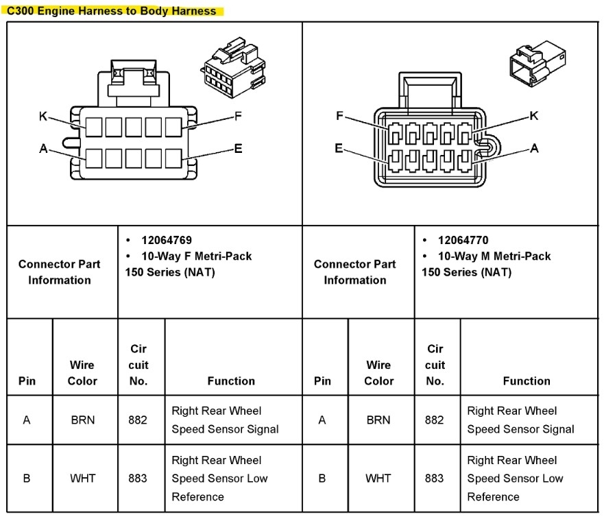

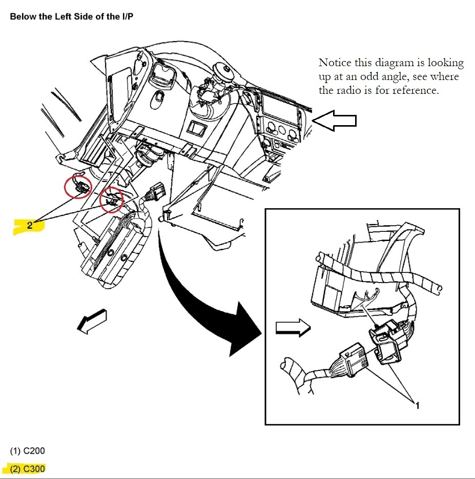

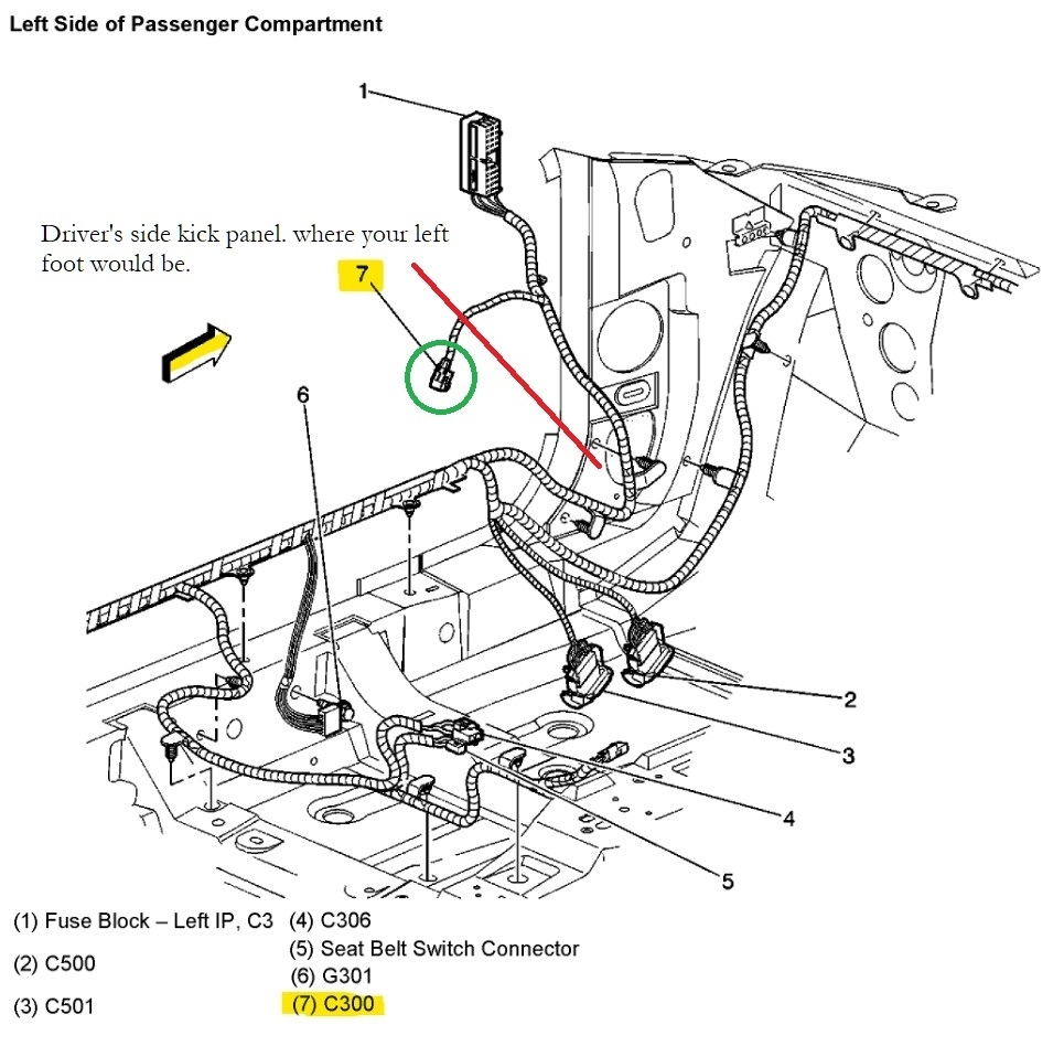

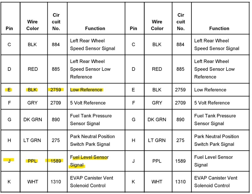

Here is the C300 connector location and pinout (drivers side lower dash, kick panel area), youre looking for the Purple wire and the Black wire at C300. If you unplug the connector, technically you should read 5volts on the Purple wire with the key On, the PCM should be supplying 5volts to the fuel level sensor.
Then to verify the circuit is not and Open, check the resistance on the same two wires with the connector still unplugged, just make sure youre checking the sensor side of the harness. So you are measuring the circuit and sensors resistance from one end to the other. You should get a reading, not an OL reading on the meter.

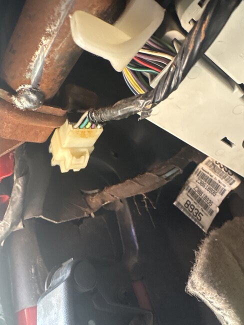

Is this the connector? I found it on the side of the lower dash
Jun 9, 2026 at 9:09 AM
AL514
  • 5,662 POSTS
Go by the wire colors on the oem wiring diagram, you should have a Brown wire (pin A), White wire pin-B, x2 Black wires pin-C pin-E, Red wire pin-D, Gray wire pin-F, DarkGreen wire pin-G, LightGreen pin-H, Purple wire pin-J, White wire pin-K. If I have that all correct,
Jun 9, 2026 at 9:16 AM
AL514
  • 5,662 POSTS
I cannot tell from this picture if thats the connector, but it is the right color connector, just see if those wire colors match, and check for a 5volt reference.

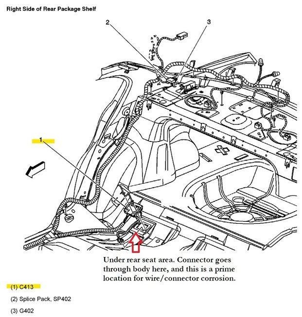

It also says there is a c413 as well. Maybe I should check that one as well? But I don’t see the location for that one

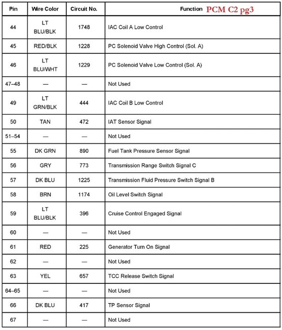

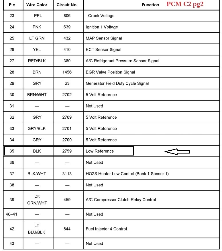

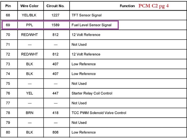

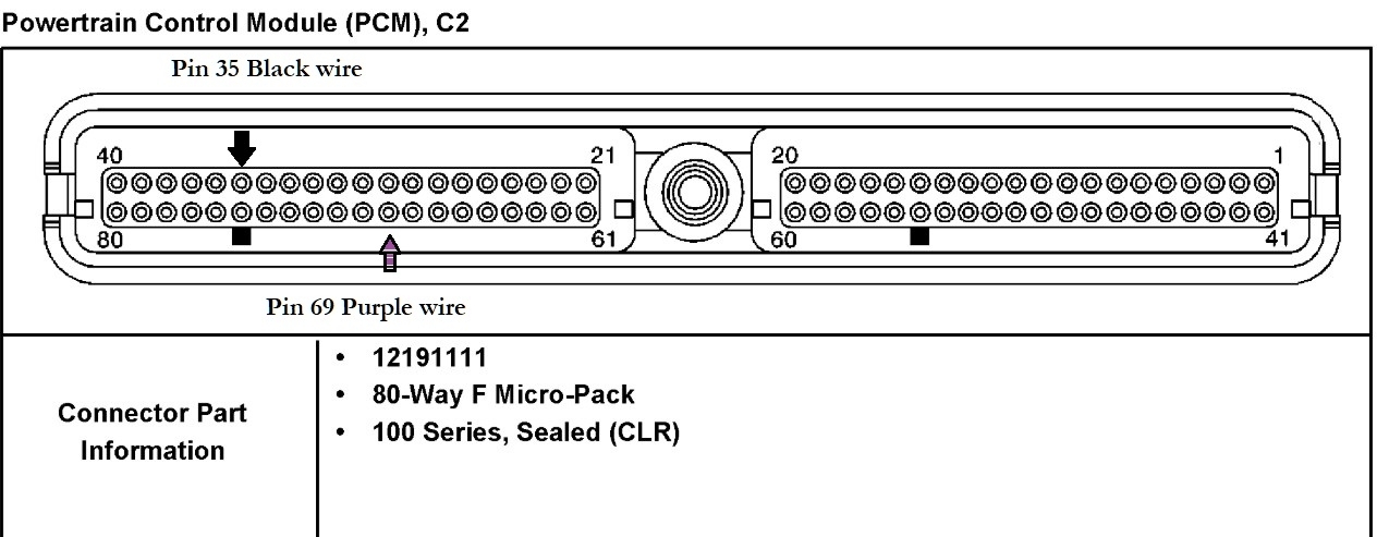

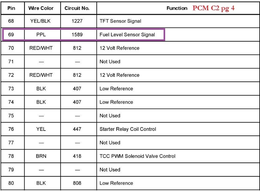

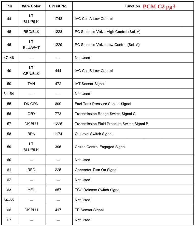

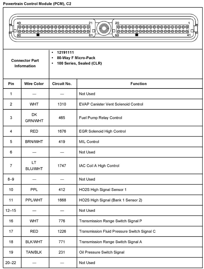

This is the PCM C2 connector, if you can back probe the Purple wire while its still plugged into the PCM, that would help get an accurate reading, we dont want to go down the wrong path due to chasing the incorrect wire, dont ask why I know that =).
But being easy on it, and dont force it because you can short pins inside the PCM connector together by accident and get all kinds of strange readings.

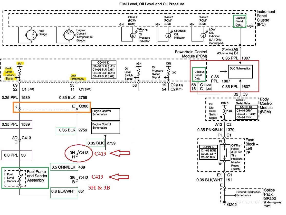

And I am not sure if this is correct, but I also noticed the wiring on the ground side of the level sensor changes colors 3 times. At the sensor the Low Reference wire is Black/White, then another connector (C413 they have almost hidden), then the wire goes to Orange/Black, then apparently back through the C413 connector, where it changes over to a solid Black wire to the PCM. I will locate C413 as well
Jun 9, 2026 at 10:08 AM
AL514
  • 5,662 POSTS
Yup good catch, I was already looking for its location.
Jun 9, 2026 at 10:10 AM
AL514
  • 5,662 POSTS

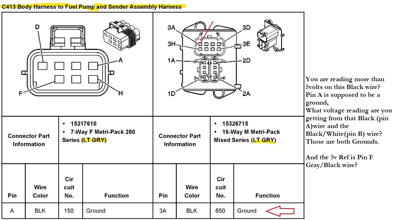

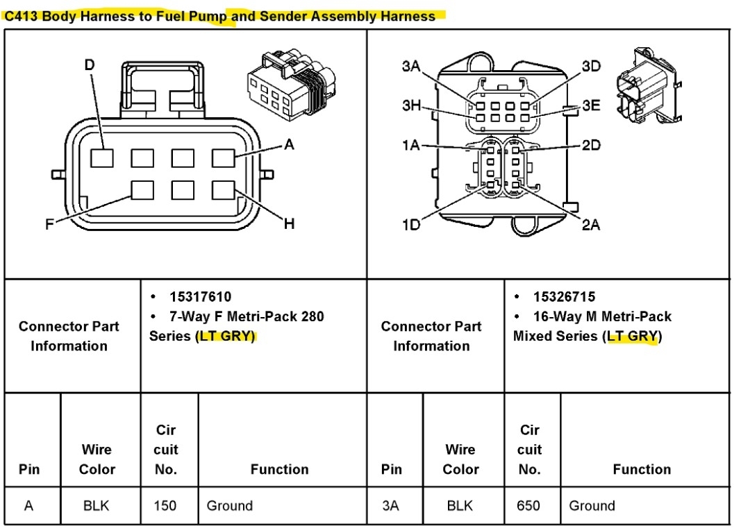

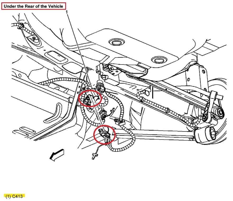

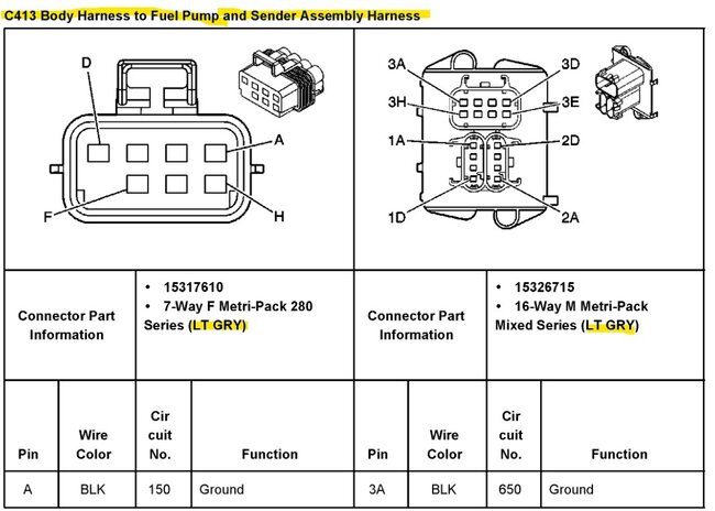

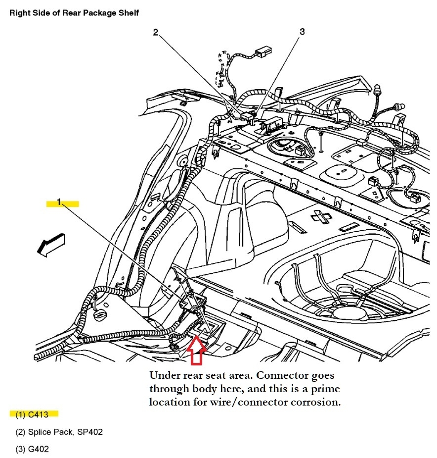

Here is C413's location and pinout, it is a pass through connector, from the interior to the under side of the vehicle, good location to check for corrosion.
Jun 9, 2026 at 10:28 AM

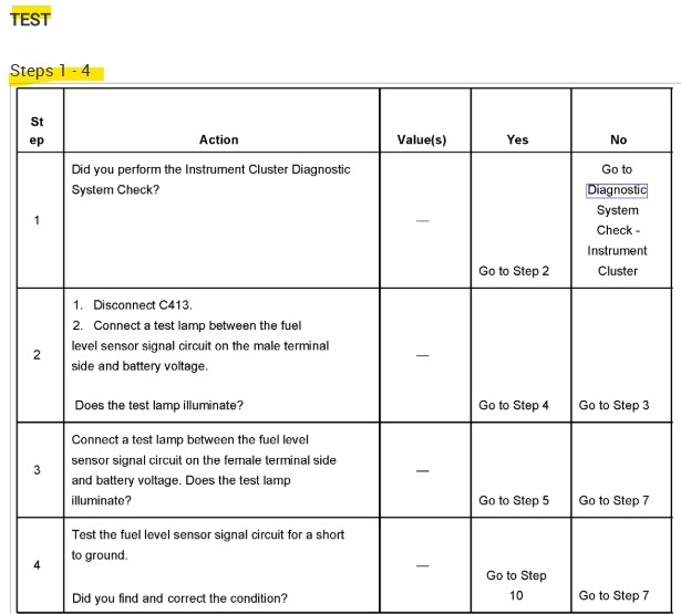

Maybe run through the flow chart real quick, it does have disconnecting C413 and testing for shorts right there.

We have no power at all going to the purple wire on the PCM. No light from the test light either. It’s the connector with the blue tint on it right?
Jun 9, 2026 at 10:40 AM
AL514
  • 5,662 POSTS
Its listed as Lite Grey in color, that might be the rubber weather pack color also though, I go by wire color and location in the connector when I am trying to ID a certain one. The oem diagrams are going to be the closest with correct wire colors.
Do you have 5volts on any of the wires coming from that connector on the body side of the harness? Are you grounding your meter at battery negative? And this might sound dumb, but are your meter leads ok? connected together and shaking the leads you dont have any high resistance showing up on the meter. Just want to make sure we dont have any equipment failure.

We indeed do have a 5 volt reference as it’s getting more than 5 volts at the black wire. Light also lights up too. Would there possibly be a short somewhere with more than 5 volts

This A pin? Black wire ground..

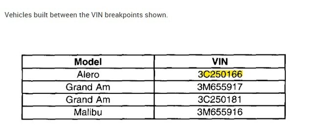

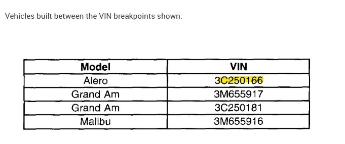

Are these 8 digits in your Vin #?
Jun 9, 2026 at 11:38 AM
RALPHPHIPPS22
  • 37 POSTS
Yes my vin ends in 200021
Jun 9, 2026 at 11:39 AM

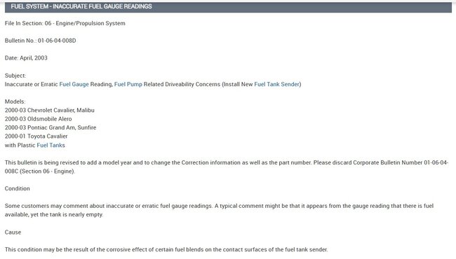

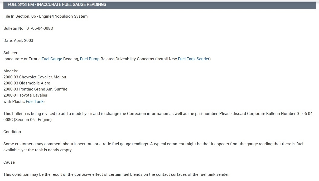

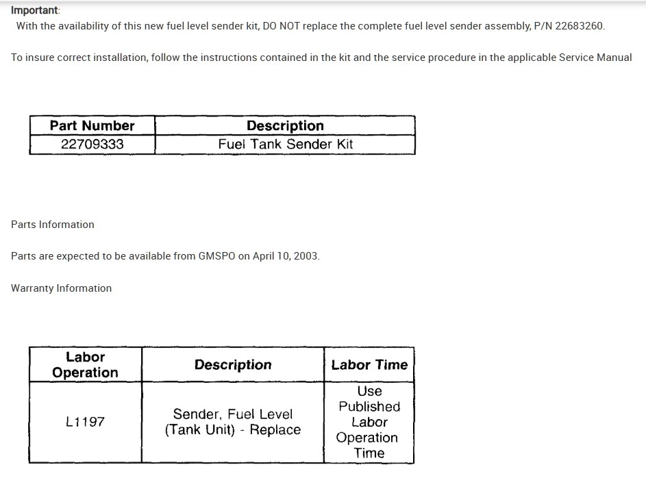

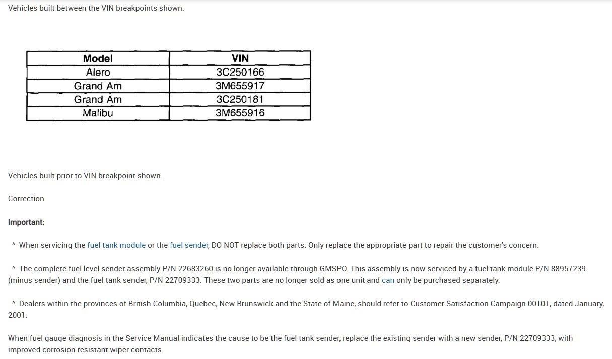

Ok I doubt this applies, but there was a technical service bulletin on in tank corrosion, but I think we are dealing with something else here.

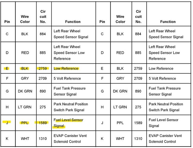

Were you able to check the PCM connector's reference voltage without unplugging the PCM? If so, with the key off, check the condition of the PCM connectors pins themselves, and check both connector for any corrosion or broken wires right inside the PCM connectors, try to look as far into the connector as possible, green corrosion can grow right inside of wiring and you cant even see it sometimes.
Another check, with the C413 disconnected, PCM C2 disconnected, key Off, see if there is continuity to ground, being that the circuit is almost isolated.
in the 4th diagram, that other Black wire is also a ground which runs into the PCM.

We do indeed have a short to ground to the black wire with a white line to it on the fuel pump harness. Because when we disconnect it, it stays lit up. So now I got to figure out where it runs to inside the car and see if it’s broken
Jun 9, 2026 at 1:34 PM
AL514
  • 5,662 POSTS
This is the Black/White wire coming from C413, and this is a Low Ref Shared (ground) with the Fuel Tank Pressure Sensor(FTP). Since the FTP sensor is usually mounted on top of the gas tank. Some are mounted with the fuel pump assembly, some are in line on the Evap purge hose. Almost all of the 5v ref on this vehicle are a Gray colored wire, common on this make.
