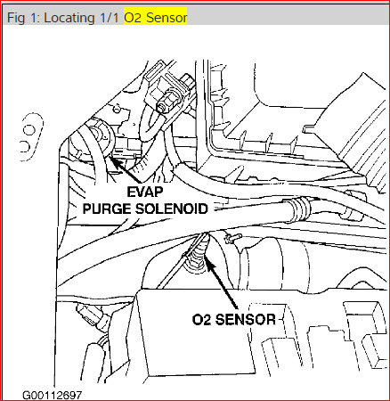

That code is your Upstream Bank 1 heated O2 sensor. Unfortunately it is my experience that it goes hand in hand with the bad catalytic converter on that side. Having that misfire damaged that sensor and converter over time. Usually O2 sensors run $60.00 to $90.00 from auto part stores but nowadays people like shopping online to save money. I am confident you can do this repair. Here is the tutorial for O2 sensors and location.. Danny-

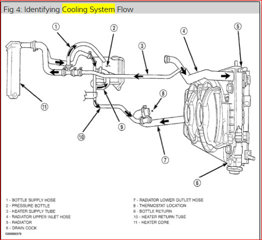

Wow! Getting this thermostat out is no joke. I should probably bought new radiator hoses.
Jul 3, 2018 at 5:02 AM
That would be a good idea if they are worn/showing signs of needing replacement. Sometimes I do replacements when work is in a tough spot just knowing it is a bear to get to and not wanting to do it again soon for awhile. Let me know if you have any questions.

Jul 3, 2018 at 8:06 AM
What is the second hose on the thermostat housing?

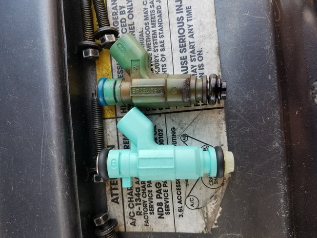

As we previously discuss I changed out the number one fuel injector and ever since I bought this car I had a strong smell of fuel by the intake manifold and then I can smell it in the cabin of the vehicle. Now from the picture that I uploaded do you think that o-ring is bad and would cause a fuel leak?
Jul 3, 2018 at 2:27 PM
Hello again.
That old Injector? I would say yes, Looks like it would leak!
Danny-

Because all of them look like the old injector. there just not misfiring (yet).
Jul 3, 2018 at 4:30 PM
Hello again.
Well that will happen with age/wear. Since you have changed them there should be no more misfire! Did you complete the thermostat change?

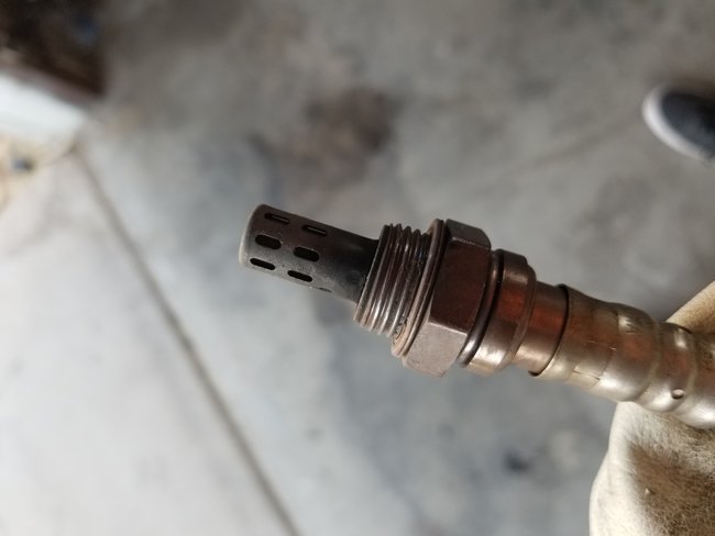

Jul 4, 2018 at 9:48 AM

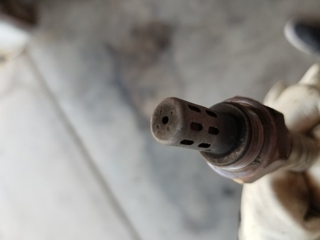

Yea, I never seen o2 sensor with that black stuff before.
Jul 4, 2018 at 11:09 AM
Hello again.
That would normally be caused by the engine running rich due to a misfire. Danny-
Jul 4, 2018 at 11:38 AM
Should I replace the downstream o2 sensor for that side as well?
Jul 5, 2018 at 9:32 AM
Just got a code Po139.
Jul 5, 2018 at 5:51 PM
Hello.
Yes, that is the Bank 1 Sensor 2 (downstream) 02 sensor. Having that misfire-running rich did some damage. Danny-
