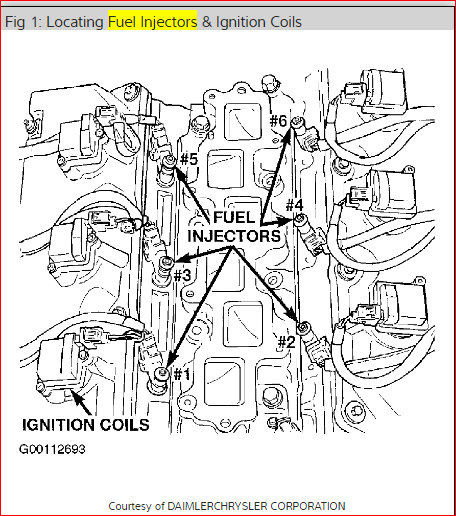

Hello, I am getting a code for bad fuel injectors number one. I am looking for a firing chart and I cannot seem to find out. Also looking for a walkout through for a removal. Thank you

I believe you are looking for the fuel Injector number one location. I have attached a diagram and a How-to link. Hope this help!

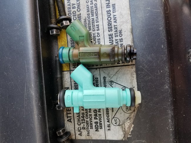

After removing intake manifold I found the number one fuel injector is burnt and the gasket for the manifold has oil all over them.

Fuel injectors.

Yikes! No wonder car was running poorly! Let me know how it runs when you replace injector(s). Danny-

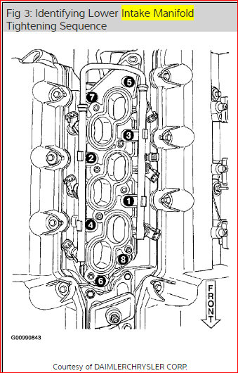

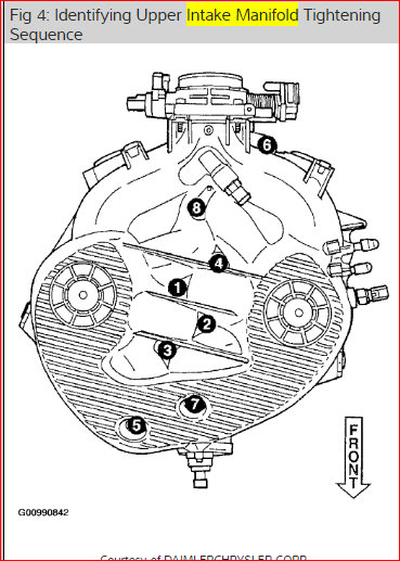

Danny here. I am sure it would not take long! That was just oil being burned that was leaking caused by the gaskets. Be sure to install new intake gaskets upon reassembly and that all surfaces are prepped/cleaned to insure a good seal. I have attached a diagram showing the proper torque sequence for installation. These bolts are to be torqued to 105 inch/LBS.

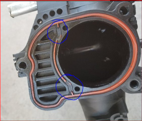

ALEX19899
  • 171 POSTS

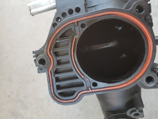

I went to AutoZone but unfortunately they did not have a new gasket for the throttle body.
Jun 28, 2018 at 11:42 AM
DANNY L
  • 5,648 POSTS
Danny here.
Not good. The areas highlighted looks to be defective/ripped/missing.
Jun 28, 2018 at 11:50 AM

AutoZone said it would take two days for new one to arrive.

ALEX19899
  • 171 POSTS
Would the bad gasket cause a leak?
Jun 28, 2018 at 11:58 AM
DANNY L
  • 5,648 POSTS
Danny here.
Yes, that is entirely possible! I would definitely install a new one!
Jun 28, 2018 at 12:01 PM
ALEX19899
  • 171 POSTS
Start starts right up with no misfire.

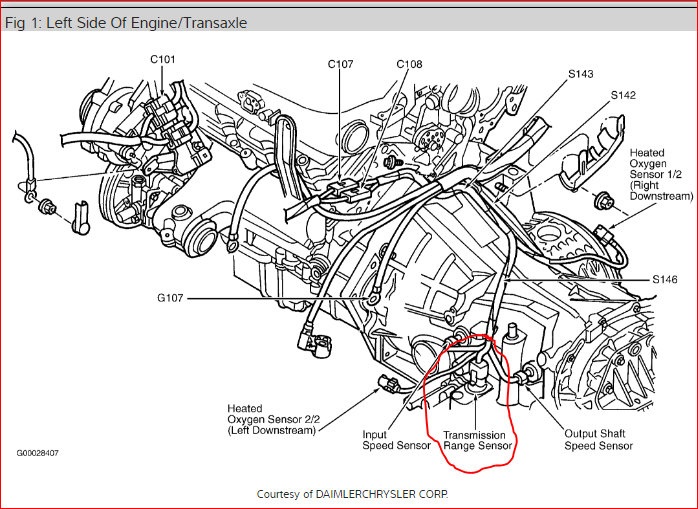

ALEX19899
  • 171 POSTS
Also, the car only starts in neutral when I park for about ten minutes or so and when I try to start it in park it will not crank.
Jun 29, 2018 at 12:32 PM
DANNY L
  • 5,648 POSTS
Hi there.

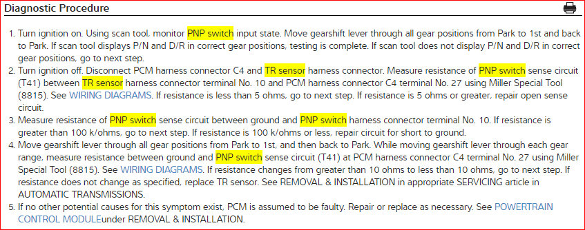

If the car does not crank in park but neutral only that sounds like the neutral safety switch. They can fall out of adjustment in time. Here is a link and a picture. I circled it in red. Danny-
https://www.2carpros.com/articles/how-a-neutral-safety-switch-works
Jun 29, 2018 at 12:51 PM
ALEX19899
  • 171 POSTS
I was reading online and it said this switch is inside of the transmission.
Jun 29, 2018 at 1:02 PM
DANNY L
  • 5,648 POSTS
Hello Danny here.
My mistake, you are correct!
It is located on the transmission valve body manual valve shaft. A good time to test/check is when a transmission service is required. I always recommend dropping the transmission pan to change the filter however, people like the convenience of doing just a quick fluid exchange at quick lube places and it leaves the old dirty filter inside.

Here are a few testing procedures. Hope this helps. Danny-
