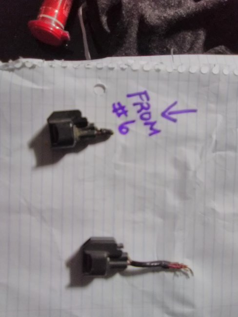

Thanks for quick reply. here is a picture of two of the four fuel injector wires that I cut off of my truck, as you can see I cut #6 right at the connector so I would have as much wire as possible to splice new one on. the other 3 are pretty much the same length as the other one in pic (If I remember correctly that is) but now the ones I added on those from the junk yard were a little longer. So do you think if I were to re-do it and remove the ones that I already added and replaced with my brand new ones cut down to the size that I cut off in the first place ,that it will be okay? and if so, how much of a problem is it going to be as far as running condition and the fuel injectors working properly if I am off on the length just a bit? Also when I did them, I never did soilder them together , just shrink tube. Please let me know what you think I need to do. Thanks.

Yes, you can just splice the wires together. I would suggest using shrink wrap after soldering the connections.The length will not matter and it will not affect the performance of the the injector.It will work just fine.Hope this helps and thanks again for using 2CarPros. Let me know if you have any further questions about this issue.

Just be sure to use the factory wire from the harness you found to replace to reattach. If you were to use a different size wire to attach that is what would possibly affect performance. Be sure to solder the connections and use heat shrink tubing to protect and seal the wiring.Being a little shorter length will not affect performance if you reattached as I stated.Let me know if you have any further questions about this repair.Hope this helps and thanks again for using 2CarPros.
