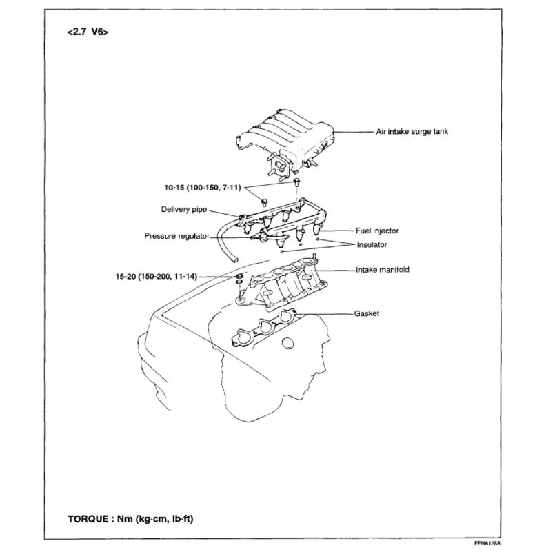

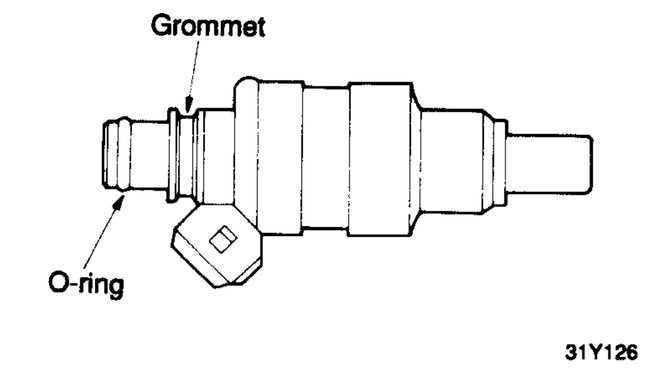

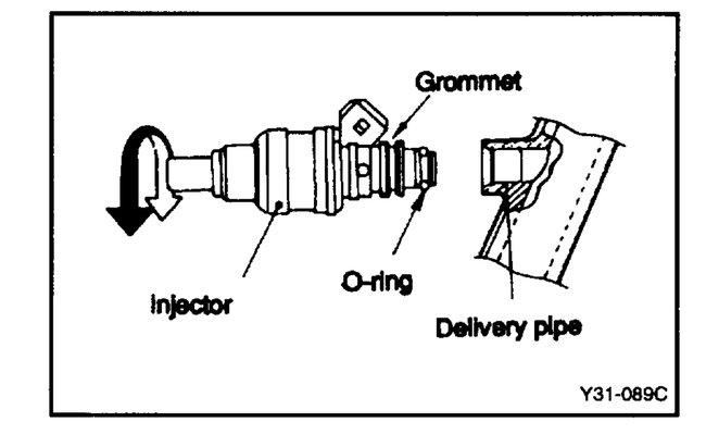

Did you replace the injector? If the compression is good then it could be a bad injector.
https://www.2carpros.com/articles/how-to-replace-a-fuel-injector
REMOVAL
1. Release residual pressure from the fuel line to prevent fuel from spilling.
CAUTION: Cover the hose connection with rags to prevent splashing of fuel from residual pressure in the fuel line.
2. Remove the delivery pipe with the fuel injector and pressure regulator.
INSTALLATION
1. Install a new grommet and O-ring to the injector.
2. Apply a coating of solvent, spindle oil or gasoline to the injector O-ring.
3. While turning the injector left and right, install it onto the delivery pipe.
4. Be sure the injector turns smoothly.
NOTE: If injector does not turn smoothly, the O-ring may be jammed. Remove the injector and re-insert it into the delivery pipe and recheck.
