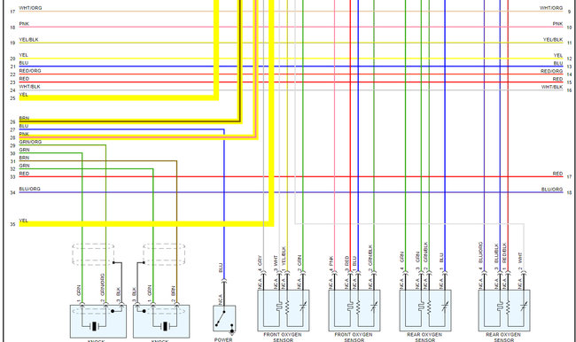

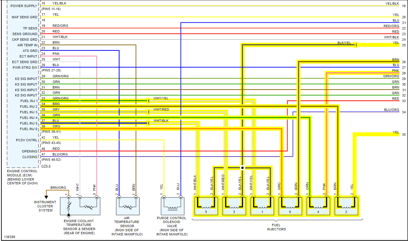

Have a miss, #4 injector plug pulled, no change., replaced injector, no change. mass air flow sensor plug pulled, no change. code reader shows mass air flow sensor at 0 volts, replaced mass air flow sensor, no change. MAF plug shows 12 volts at 1 pin, 0 at other 2 pins. Temperature coolant sensor shows fault code.
Nov 21, 2020 at 11:49 AM
Good afternoon,
If you have a misfire on number 4, you need to do some testing.
Check for power to the injector. You should have 12 volts with the key on.
Check the compression as well. Low compression will cause this.
Do you have spark at the plug?
I attached a wiring diagram of the injectors for you as well.

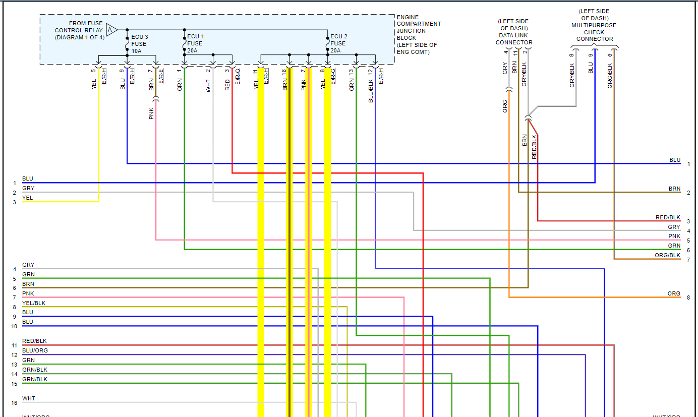

That's with all disconnected. I found an ECU fuse on the engine fuse block that was 12V on one leg and 0 on the other. Replaced it and now #4 is firing. Running better, but still not a great idle in drive. Tries to cut off. Could the other trouble codes be at fault? MAF and coolant temperature sensors?
Nov 22, 2020 at 10:36 AM
What other codes? There were no codes listed in your question.

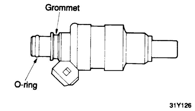

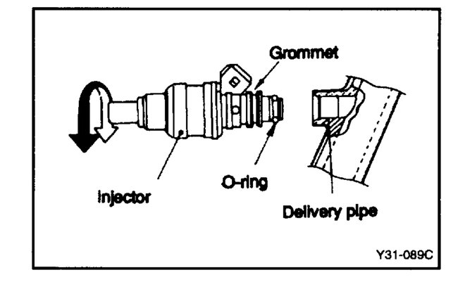

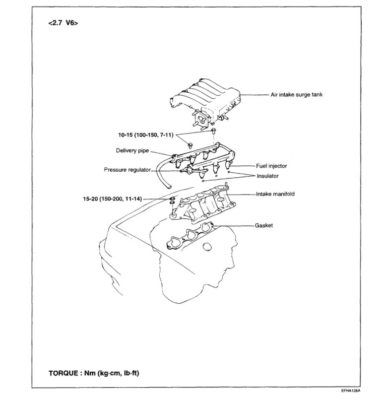

Did you replace the injector? If the compression is good then it could be a bad injector.
https://www.2carpros.com/articles/how-to-replace-a-fuel-injector
REMOVAL
1. Release residual pressure from the fuel line to prevent fuel from spilling.
CAUTION: Cover the hose connection with rags to prevent splashing of fuel from residual pressure in the fuel line.
2. Remove the delivery pipe with the fuel injector and pressure regulator.
INSTALLATION
1. Install a new grommet and O-ring to the injector.
2. Apply a coating of solvent, spindle oil or gasoline to the injector O-ring.
3. While turning the injector left and right, install it onto the delivery pipe.
4. Be sure the injector turns smoothly.
NOTE: If injector does not turn smoothly, the O-ring may be jammed. Remove the injector and re-insert it into the delivery pipe and recheck.
