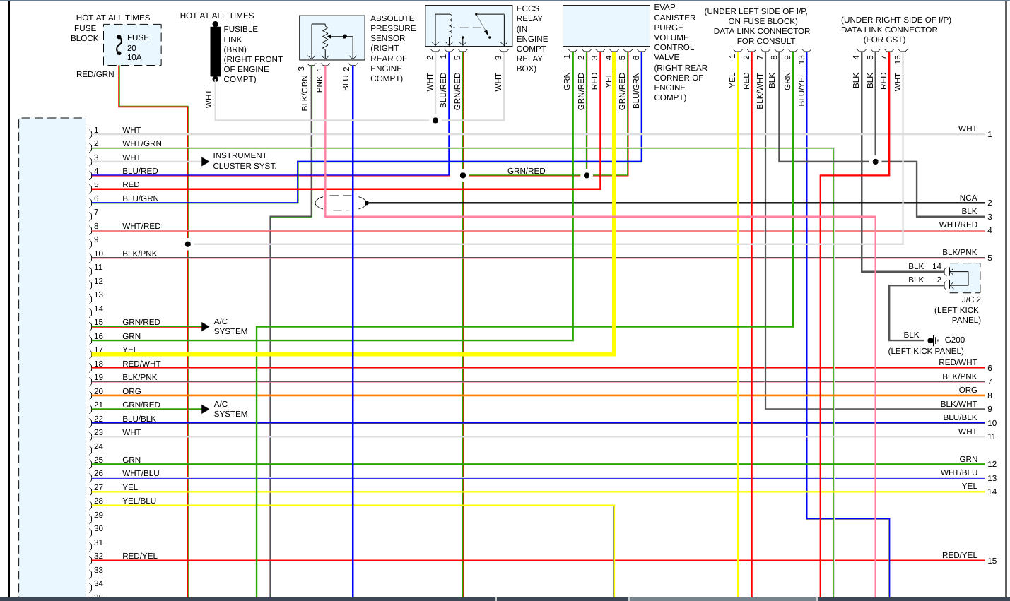

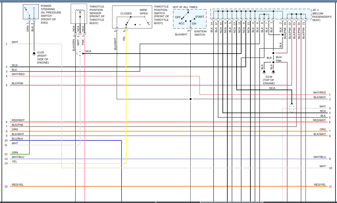

Fuel injection wiring diagrams needed
100,000 MILES • 2.4L • 4 CYL • 2WD • MANUAL
PACIFICISLANDER
  • 239 POSTS

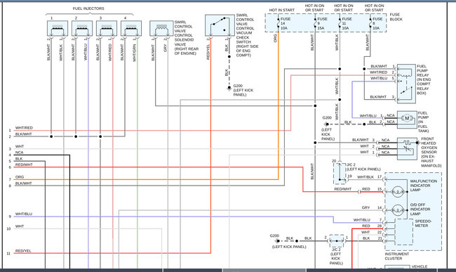

Need the wiring harness/color of wires assign to each injectors.
Dec 11, 2019 at 3:58 PM
SCGRANTURISMO
  • 4,897 POSTS
In the diagrams down below I have included the information that you requested. I have included all of the engine management wiring diagrams for you. The fuel injectors are on the top of the third wiring diagram. I hope that this helps.
