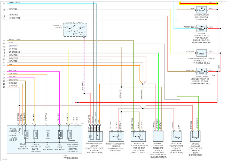

This motorhome has been sitting since 2019. It ran fine, was parked in a campground, I went to start it and it seemed like a fuel issue. I have replaced the following. Fuel Pump, Filter, Fuel Pressure Regulator, Air idle control Motor, and a new Battery. If fuel is sprayed in the intake, it starts fine for maybe 3 seconds and then shuts down. I don't know what to do next. Any ideas what to look at next?

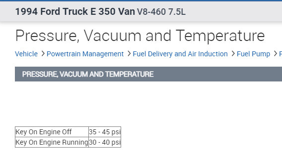

Do you hear the new pump prime the system? Have you checked the fuel pressure? If not, that needs to be done.
Here is a link that explains how it's done:
You will need a fuel pressure gauge, but most parts stores will lend one to you. I attached the manufacturer's fuel pressure specifications below for you.
If the fuel pressure is good, then we need to confirm the fuel injectors are getting power and a ground signal to actuate.
If you look below, I attached a pic of the injectors/wiring (pic 2). Note that each injector will have a red wire. With the ignition key in the run position, that wire at each injector should have battery voltage. Check that for me as well.
Let me know what you find.
See pics below. Note: I'm not sure which chassis was used to build the camper. I went with an E350. If that is incorrect, let me know what you have and I'll confirm the information I provided.
