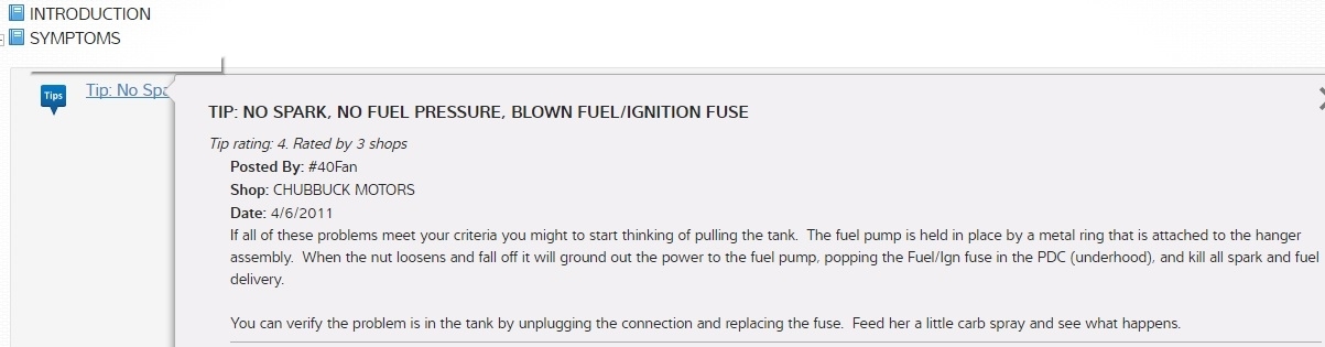

Lets check a few things
Distributor cap for cracks or carbon trails/ tracks on it
Pop the distributor cap and inspect the rotor button, see if the rotor button turns while cranking
Look the connections over at the distributor, are they corroded or green?
While someone cranks the Jeep, wiggle/ move the wires around see if anything happens.
Check fuses
See my 2nd pic, I grabbed this outta "Prodemand", it may be a possibility
We'll keep going/ results?
