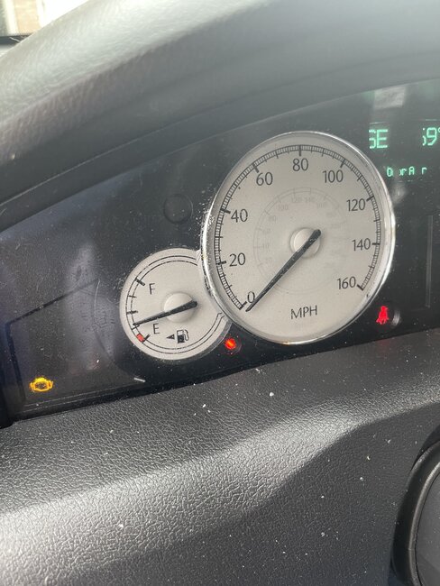

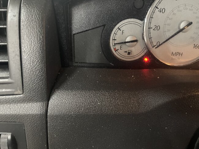

I noticed that the fuel gauge light is always on. I just bought the car, so I don't know how much fuel is in there. I have scanners, is there a way to know how much fuel is in the tank so i would know if it's a cluster issue?

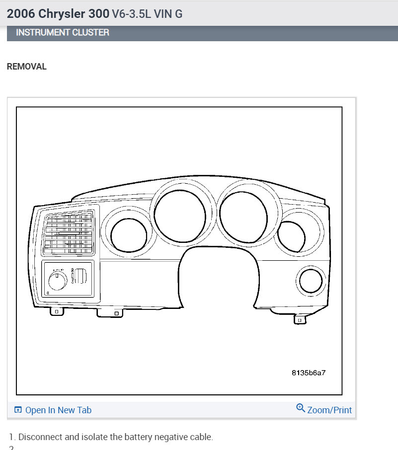

Thanks for the image, I would plug a scanner in to read the value of the fuel sensor, but I think the cluster is bad because the MICU is inside the cluster that controls the light. Do a CAN scan to see what comes up.

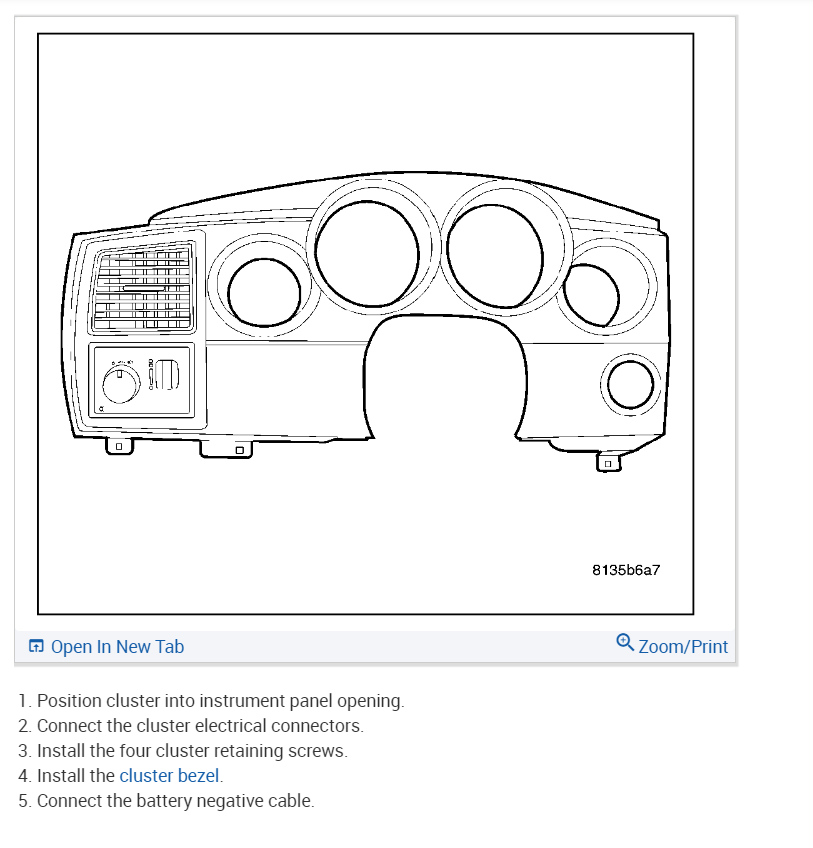

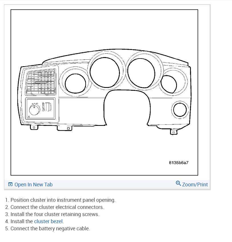

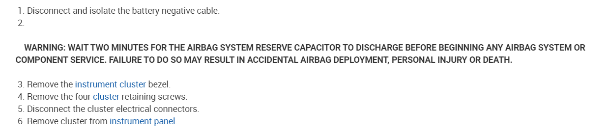

Please go over this guide and report back. I have included how to replace the cluster in case you need it.

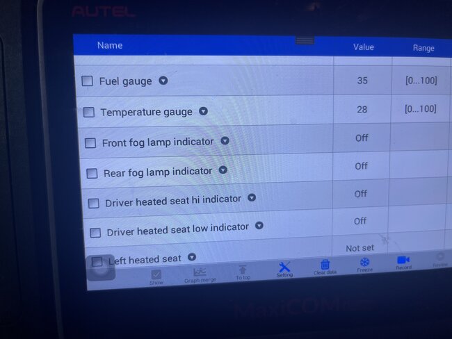

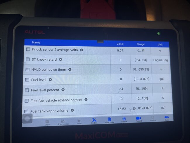

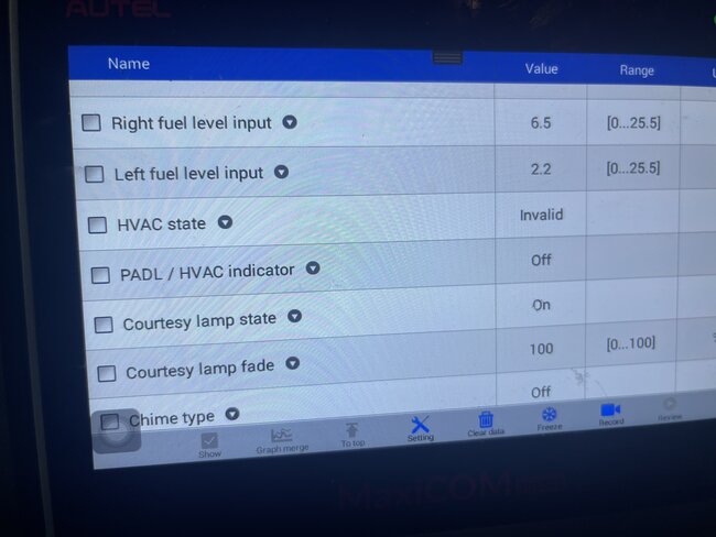

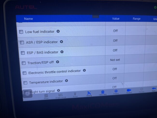

I did scan some numbers, really hard to figure out what is going on. Can you make sense of any of this?
Oct 18, 2022 at 2:15 AM
  • 55,423 POSTS
It says the low fuel indicator is off but the light is clearly on. I would say the BCM is going out or the cluster is bad. Let me know what happens.
