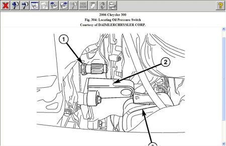

I am in the process of installing an after market oil pressure gage on my 3.5 litre v-6, here is the question. I need to know exactly where the the oil port plugs are that I can tap into for my sending unit. I do not want to end up pulling a water plug. If there is more than one oil plug I need to know that too so I have more options. Rob O.

6 cyl 2.7L engine the oil pressure switch is located on the right side of the engine block-see below
