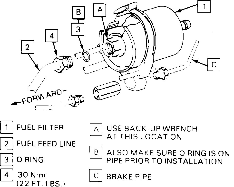

I have the car listed above Regency that needs its fuel filter replaced but do not have the money to pay someone to do it. Can you tell me where it is located and how to change it?

Here are the directions specific to your vehicle. The attached picture is of the filter which is located under the vehicle.

1990 Oldsmobile Ninety-Eight V6-3800 3.8L
Fuel Filter Replacement
Vehicle Powertrain Management Fuel Delivery and Air Induction Fuel Filter Service and Repair Procedures Fuel Filter Replacement
FUEL FILTER REPLACEMENT
Fuel Filter
NOTE: Before replacing a fuel filter it is necessary to relieve fuel system pressure, see MAINTENANCE PROCEDURES/FUEL SYSTEM PRESSURE RELIEF.
REMOVAL:
The fuel filter is located under the rear of the car, in front of the fuel tank.
WARNING: To reduce the risk of fire and personal injury when the fuel line is disconnected, cover the fuel line with a shop cloth to collect the fuel, and then place the cloth in an approved container.
1. Raise car on hoist.
2. Disconnect the fuel lines from the filter using a back-up wrench to prevent damage to the fuel lines.
3. Remove the filter from the car.
INSTALLATION:
1. Install the new filter in position loosely.
2. Using new "O" rings, install the fuel lines into the filter.
NOTE: Use a back-up wrench to prevent filter, "O" ring, or fuel line damage.
3. Torque line fittings to specification 30 Nm (22 lb.ft).
4. Secure the filter to the car.
5. Lower the car.
6. START the engine and inspect for leaks.
