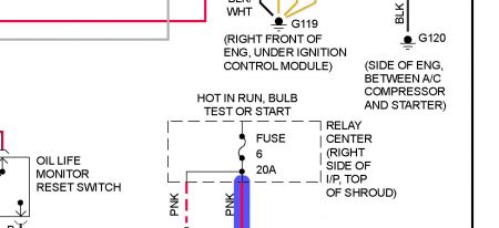

I would like to change the fuel filter, how to get to the passenger side fuses so I can release the fuel pressure?
Thanks.
[img:ba86b4c832]http://www.2carpros.com/forum/automotive_pictures/562038_DSC00054_1.jpg[/img:ba86b4c832]
Aug 15, 2010 at 8:07 PM
  • 75,992 POSTS
Hi coffinsupply, Welcome to 2carpros and TY for the donation Remove fuse no.6 20amp-see pic
https://images.2carpros.com/forum/automotive_pictures/12900_fuse_18.jpg
FUEL PRESSURE RELIEF WARNING:Always relieve fuel pressure before disconnecting any fuel injection-related component. DO NOT allow fuel to contact engine or electrical components. Fuel system is under pressure. Relieve pressure before servicing fuel system. Fuel pressure may be relieved using one of 2 different methods. One method is to disconnect fuel pump connector. Start engine and allow to run until it stops. Operate starter for 3 seconds to remove remaining fuel from fuel lines. Reconnect fuel pump once repair is complete. The other method is to install Fuel Pressure Gauge (J-34730-1) on fuel pressure test port. When installing fuel pressure gauge, wrap shop towel

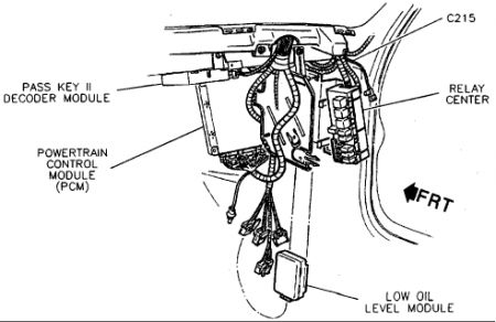

Thanks, That gives me some idea. But first thing first, how do I actually get to the fuse box?
Aug 15, 2010 at 8:28 PM
  • 75,992 POSTS
Its on the R/H side of dash near the computer-
https://images.2carpros.com/forum/automotive_pictures/12900_relay_34.jpg

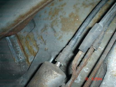

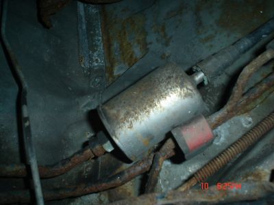

HI, What kind of fitting does it have? Do I need special tools to remove this?
https://images.2carpros.com/forum/automotive_pictures/562038_DSC00001_1.jpg
https://images.2carpros.com/forum/automotive_pictures/562038_DSC00003_2.jpg
Sep 10, 2010 at 8:40 PM
  • 75,992 POSTS
Yes you do
Sep 10, 2010 at 11:53 PM
COFFINSUPPLY
  • 6 POSTS
Could you be more specific?
Sep 11, 2010 at 4:10 PM
  • 75,992 POSTS

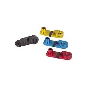

You need this tool its either 5/16 or 3/8
https://images.2carpros.com/forum/automotive_pictures/12900_ffr_1.jpg
Standard use is either clamp it around the hose or insert the tool into the connector and push both tool and hose towards each other usually you have to wiggle it a little bit it should pop loose fairly easily.

When I try to do Relieve pressure by removing the #6 fuse, the car would not run and throws out AC...Hot disabled. So I'm wondering live removing of the fuse while car is running bad for the electrical system?
Sep 13, 2010 at 4:16 PM
  • 75,992 POSTS
Just do below to remove/depressurize the fuel pressure to change out the fuel filter
