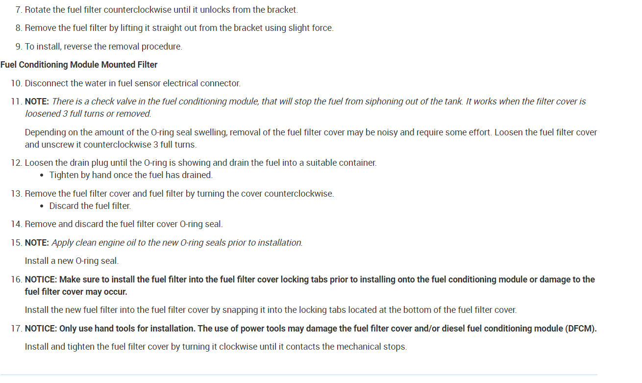

In the tank as part of the pump assembly. This guide should help us fix it but I have included the diesel filter gas filter replacement in the diagrams below.
https://www.2carpros.com/articles/how-to-change-a-fuel-filter

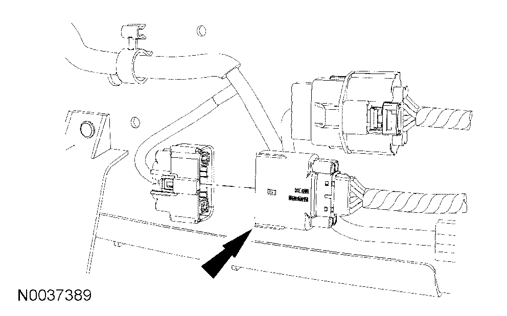

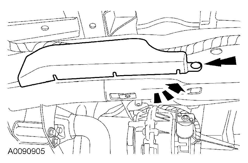

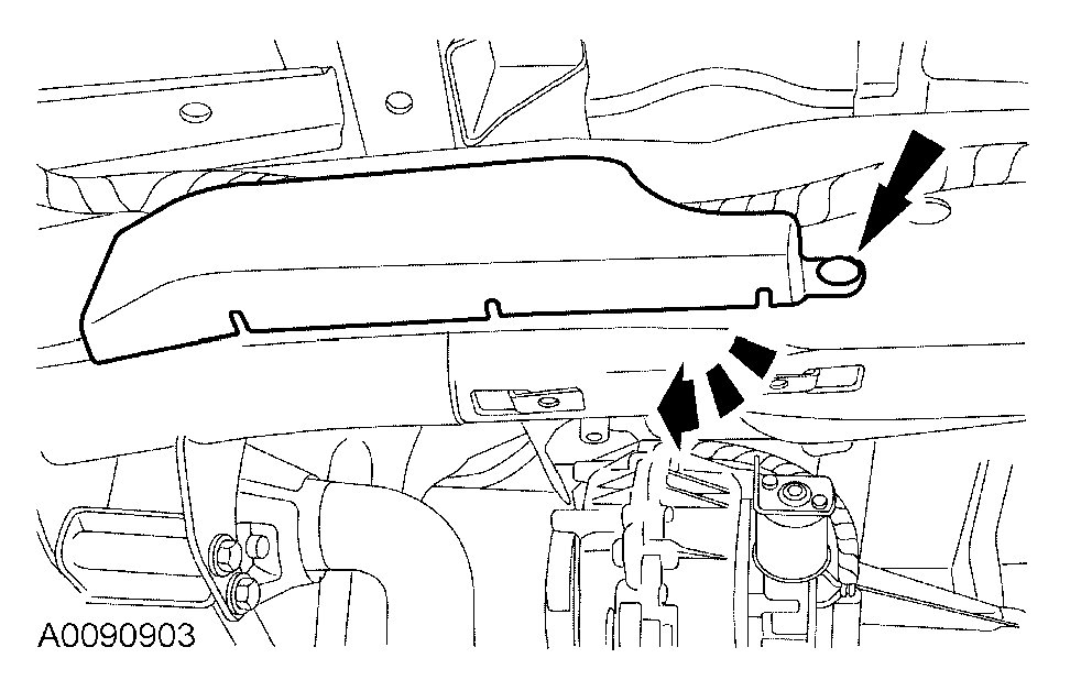

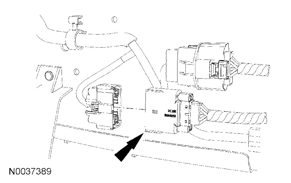

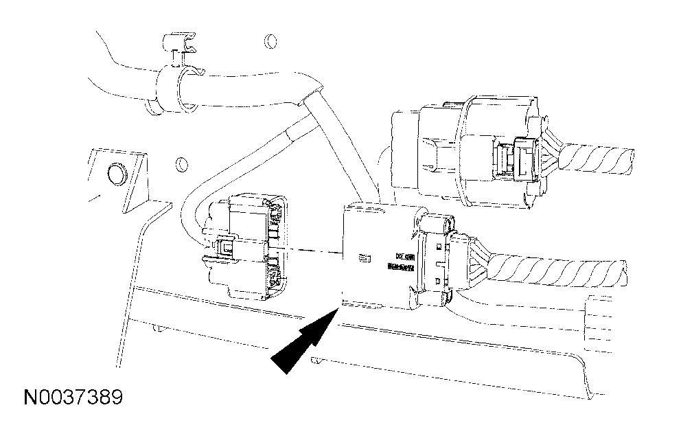

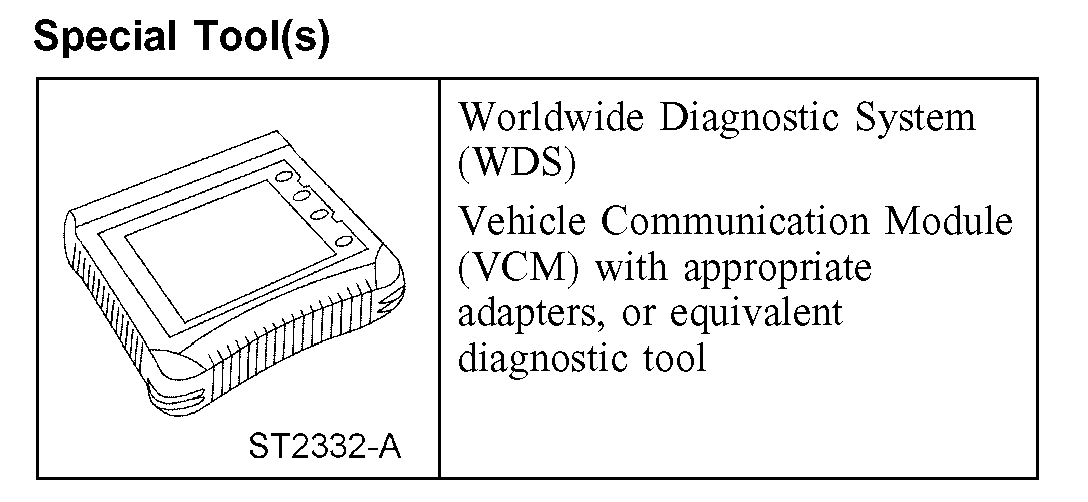

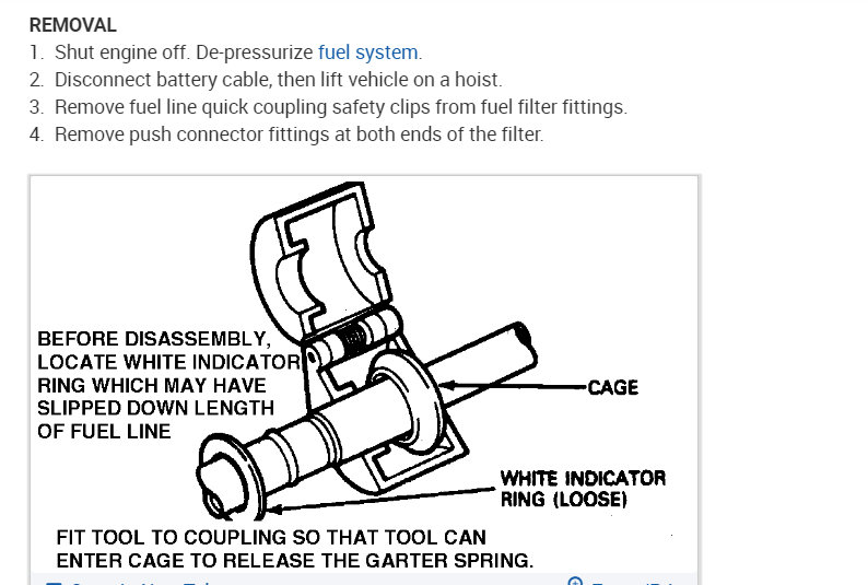

First, here are the directions for fuel pressure release. The attached pics correlate with the directions. Check out the diagrams (Below).
1. NOTE: The splash shield is located on the LH frame rail under the driver side door.
Disconnect the splash shield and position aside.
2. Disconnect the electrical connector.
3. Start the engine and allow it to idle until it stalls.
4. After the engine stalls, crank the engine for approximately 5 seconds to make sure the fuel rail pressure has been released.
5. Turn the ignition switch to the OFF position.
6. When fuel system service is complete, connect the electrical connector.
7. Reposition the splash shield and install a new pushpin.
8. NOTE: It may take more than one key cycle to pressurize the fuel system.
Cycle the ignition key and wait 3 seconds to pressurize the fuel system. Check for leaks before starting the engine.
9. Install the diagnostic tool. Turn the key ON with the engine OFF. Cycle the key OFF, then ON. Select the appropriate vehicle and engine qualifier. Clear all diagnostic trouble codes (DTCs) and carry out a PCM reset.
10. Start the vehicle and check the fuel system for leaks.
Next, before replacing the fuel filter, confirm that fuel pressure is low. Here is a link that explains how that is done.
Here are the manufacturer's specs for fuel pressure.
Item .................... Specification
Fuel Pressure
Key on, engine off .................... 240-310 kPa (35-45 psi)
Engine running .................... 193-310 kPa (28-45 psi)

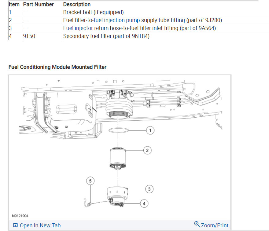

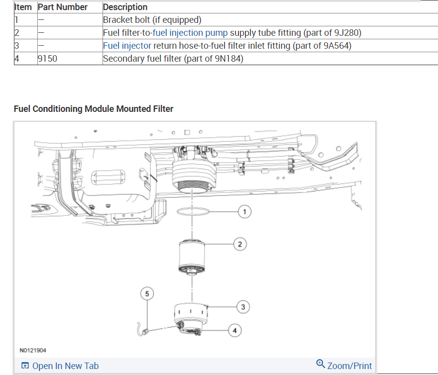

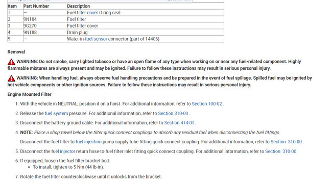

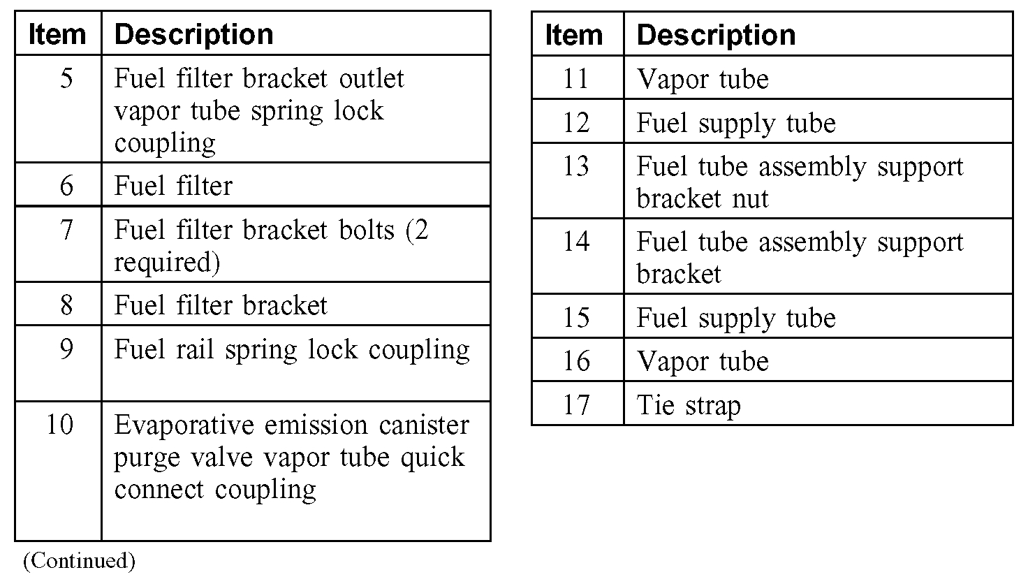

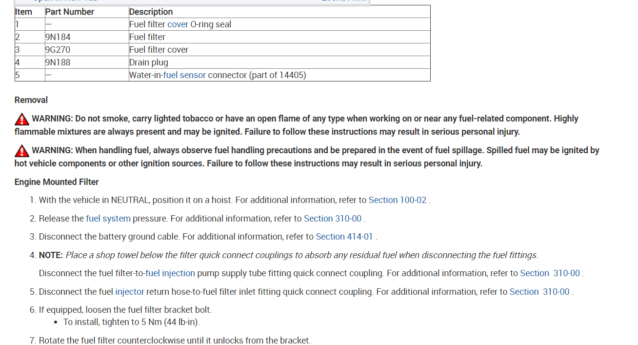

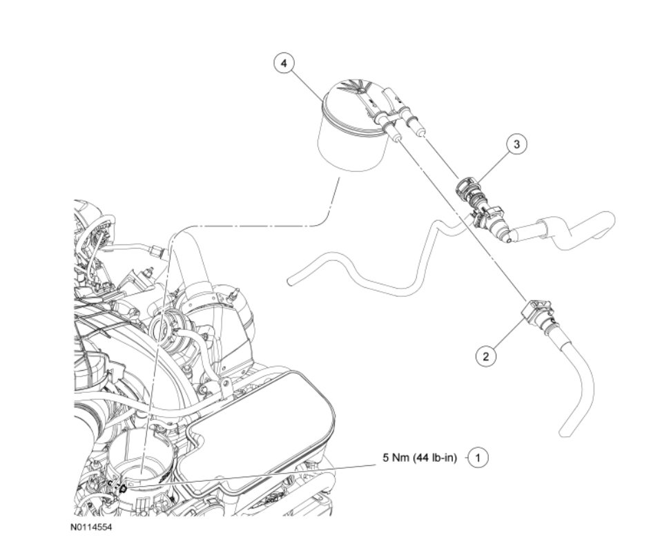

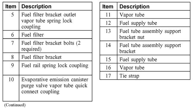

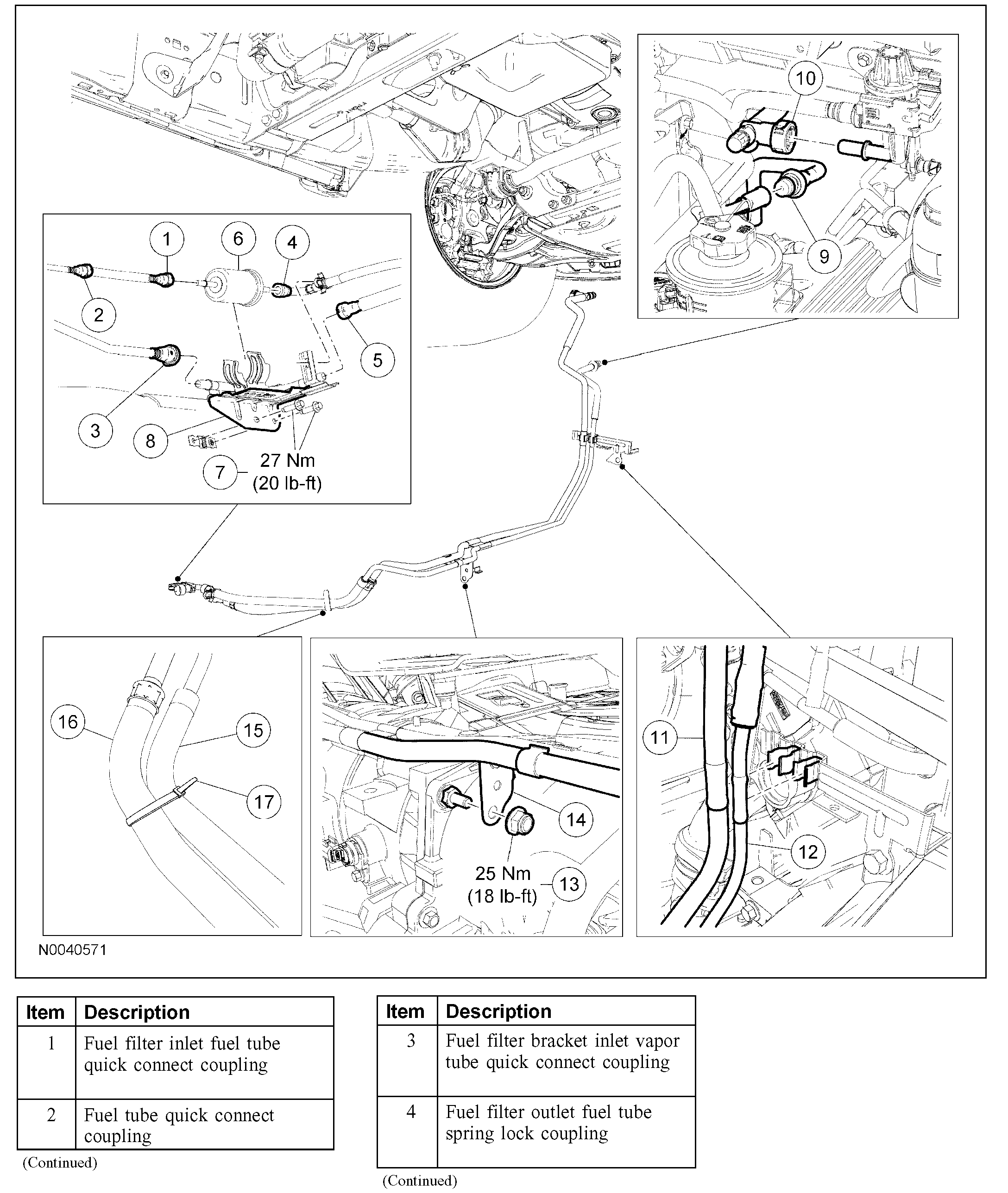

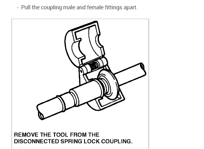

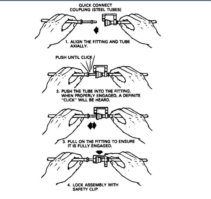

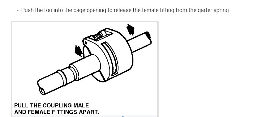

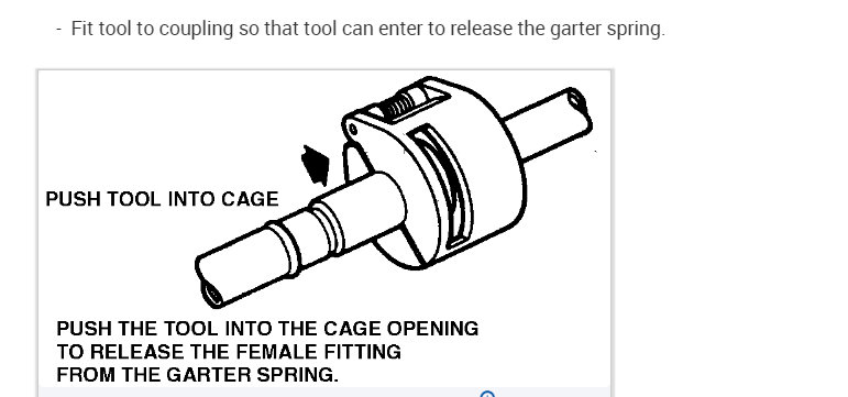

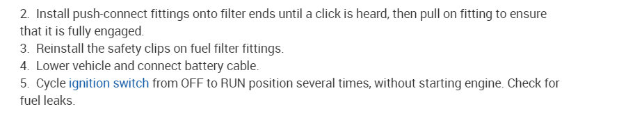

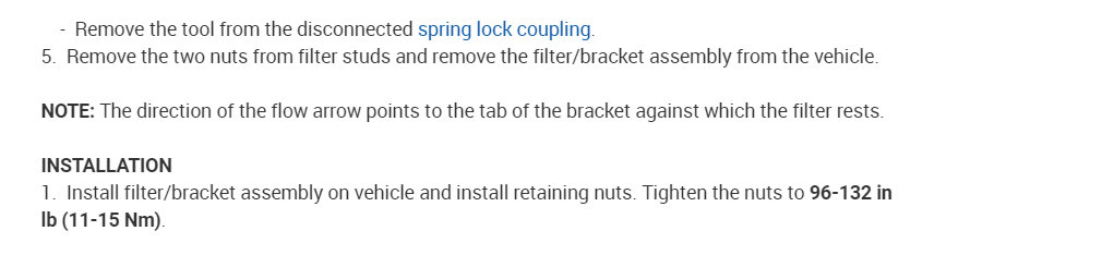

If you want to replace the fuel filter, here are the directions. The remaining pics correlate with the directions.
Removal and Installation
WARNING:
- Do not smoke or carry lighted tobacco or open flame of any type when working on or near any fuel-related component. Highly flammable mixtures are always present and can be ignited. Failure to follow these instructions may result in personal injury.
- Fuel in the fuel system remains under high pressure even when the engine is not running. Before servicing or disconnecting any of the fuel lines or fuel system components, the fuel system pressure must be relieved to prevent accidental spraying of fuel, causing a fire hazard. Failure to follow these instructions may result in personal injury.
- There are 2 fuel systems, an early and late build fuel system. The early build system uses a 7.9 mm (5/16 in) fuel line and connectors. The late build uses a 9.5 mm (3/8 in) fuel line and connectors. Do not interchange the 2 fuel line sizes or components because fuel leakage will take place causing a fire hazard. Failure to follow these instructions may result in personal injury.
1. With the vehicle in NEUTRAL, position it on a hoist.
2. Release the fuel system pressure.
3. Disconnect the battery ground cable.
4. Disconnect the fuel filter inlet fuel tube quick connect coupling and fuel filter outlet fuel tube spring lock coupling.
5. Remove the fuel filter from the fuel filter bracket.
6. To install, reverse the removal procedure.
- If a tie strap was removed, reinstall a new tie strap in the same location.
Check out the diagrams (Below). Please let us know what you find. We are interested to see what it is.

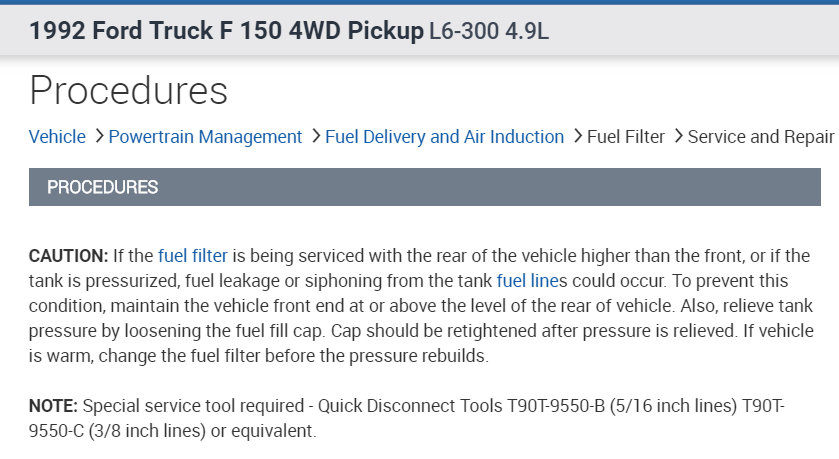

How do you take off a fuel filter?
May 29, 2021 at 3:27 AM (Merged)
there are release tools required to remove the lines. a plastic set of them is about 10 bucks from a parts store. This video will give you instructions on how to use them

Can another tool be used? Is it possible to remove the fuel filter without the release tool?
May 29, 2021 at 3:28 AM (Merged)
DOCFIXIT
  • 18,828 POSTS
Should be able to get one at a parts house maybe rent or borrow this video will show you how
https://youtu.be/Boi0DPXVHbM
SATURNTECH9
  • 30,869 POSTS
The release tool is under 10 and well worth it its cheaper then having someone do it.

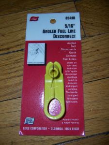

Here is a picture of the tool you will need. I bought this one at O'Reillys for $3.99. Don't count on them to let you know you need one before you break the clip inside one of the hoses. FORD won't sell you just a clip either or even an individual hose. I had to buy BOTH new hoses from FORD for $112.00. Last NEW FORD I'll ever own. Good luck.
https://images.2carpros.com/forum/automotive_pictures/174832_101_2786_1.jpg
this video will help show you how to use it. https://youtu.be/Boi0DPXVHbM this guide can help as well https://www.2carpros.com/articles/how-to-change-a-fuel-filter

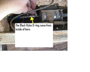

I am finally done with installing my rebuilt 5.4 liter motor into my 1997 F150. I decided it was a good time to install a fuel filter. The first quick connect (the one towards the back) came on with minimal effort. The front side took me hours. When it finally came out a black metal or hard plastic ring came out with it. Is this bad? I managed to pry the ring off of the old filter. I tried just slipping it on to the new filter. But it will not fit inside. Any advice? Thanks.
May 29, 2021 at 3:32 AM (Merged)
  • 110,244 POSTS
Is it a retaining clip?
FORDTRUCKE3089
  • 5 POSTS
No, it is not a retaining clip. It came from inside the quick connect fitting and was stuck on the nipple of the fuel filter.
https://images.2carpros.com/forum/automotive_pictures/589413_untitled_1.jpg
https://images.2carpros.com/forum/automotive_pictures/589413_untitled1_1.jpg
FORDTRUCKE3089
  • 5 POSTS
no, i was hoping for someone to know exactly what to do in this situation. I hope that i do not have to replace the fuel lines. It is possible to just replace the quick connect piece?
  • 110,244 POSTS
I have never seen that part seperatly. Is there a reason you can't replace the O-ring?

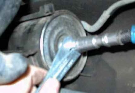

RANGERDANGER17
  • 224 POSTS
i am changing the fuel filter how do the lines come off
RACEFAN966
  • 5,029 POSTS
You will need a tool that you will push up into the line to release the clips then just pull the line off. First pic is the tool the second it how you use it. If you need any more help let me know.

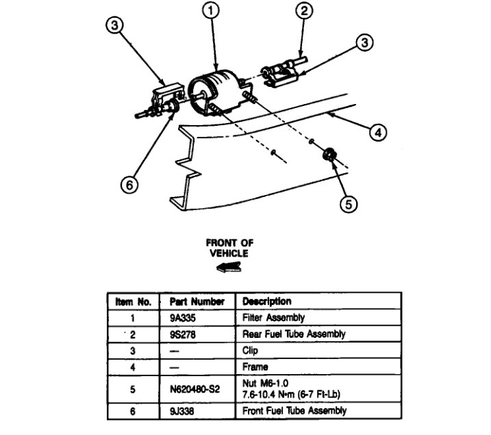

The fuel filter is located in the framing on the driver side, in front of the gas tank. FUEL FILTER ASSEMBLY
