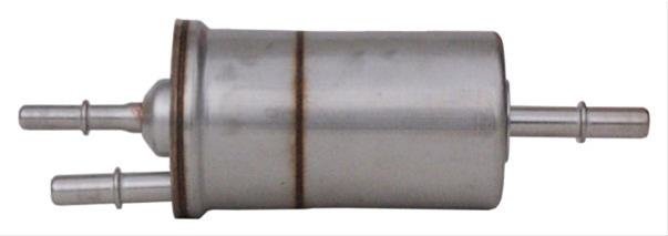

Here's the question:

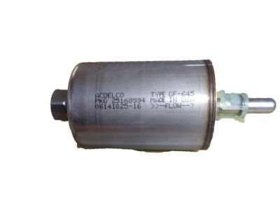

When I look up the part (fuel filter) online, eBay, AutoZone, etc. It shows two kinds for exactly the same engine with exactly the same description. It shows one that has a single line at one end and a single line at the other [just like the one in your YouTube video]. Now for the other, it shows 2 lines going in one end and one line out of the other end. I've seen this one installed in YouTube videos as well. Which one is it? I am so confused.
I am a double below knee amputee so getting down on the ground and getting back up is extremely difficult so I cannot just go under and look at it, I need the right part sent to me so I can do it all in one shot.
Can you please help me figure out which one I need?
May 5, 2022 at 1:35 AM
STEVE W.
  • 15,349 POSTS

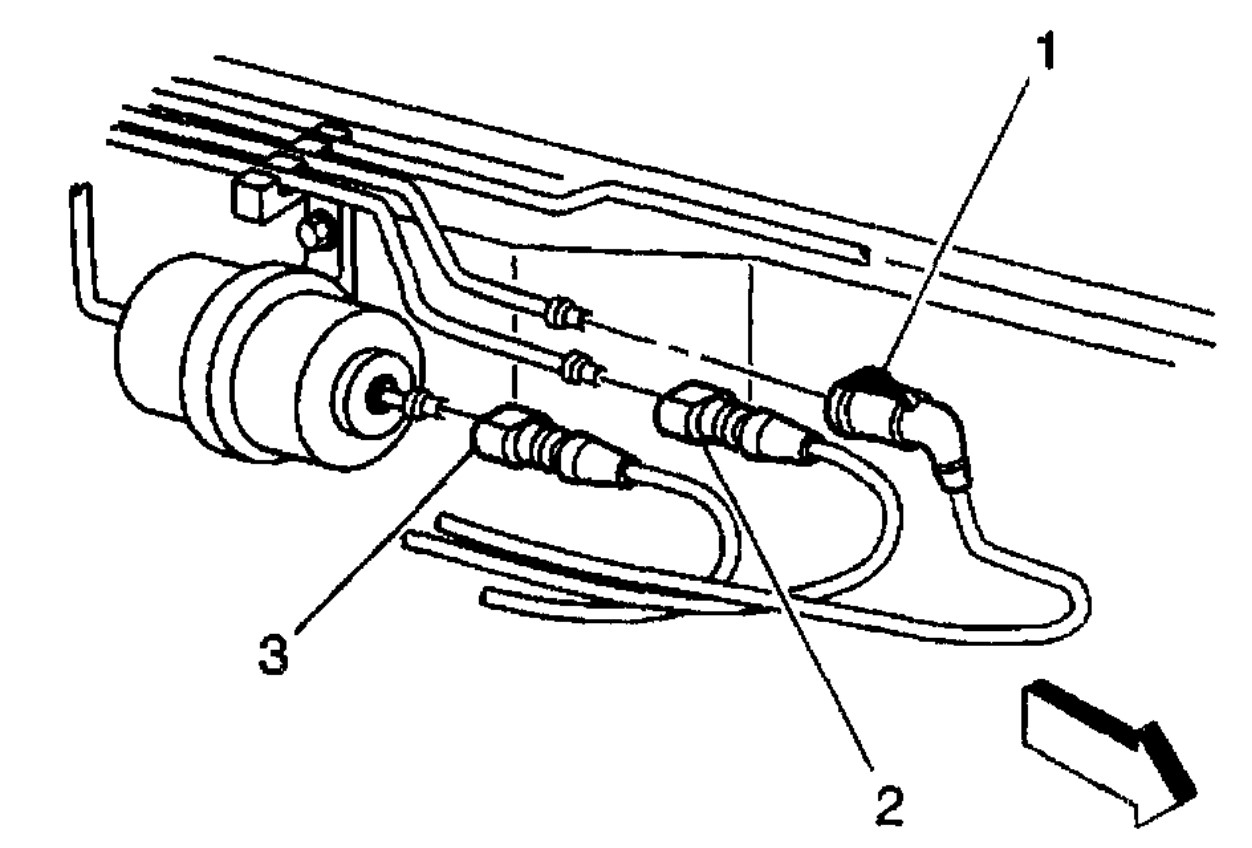

The reason for the difference is which engine you have. The 2.2 came as a flex fuel or a non-flex version. The two-port fuel filter is for the non-flex engine while the three-port version is for the flex fuel version and has the pressure regulator in it. So, if your truck has the flex fuel option you need the filter in the first picture that has three quick release fittings. If it isn't the flex fuel version then it uses the second design, it has one quick connect and one threaded coupler. Both are mounted in the same place. You will need to clean out the retainer clip area to get it to the point they release easily. You will also need to release the fuel pressure before removing either one. To do that the easy way is to full the fuel pump fuse or relay and then try to start it until it won't try to start. Then the pressure should be out of the line.
