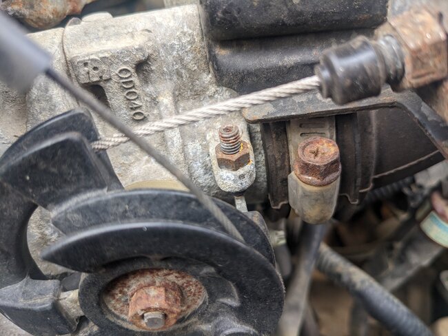

I figured if it's holding the throttle open slightly, then it would bump the idle just a bit. The previous owner was a machine maintenance man at the post office and fancied himself a mechanic. You should see the horrors I've found, like the air filter that hasn't been changed in the 100+k miles he'd driven the car. I asked him when he changed it last. His response was. "What air filter?" Loose battery terminals? Stick a screw in there. Oh, any old fuse will work! As long as it has at least the right number of amps on it. I don't need to replace that cracked turn signal socket. A zip tie will work just fine. The signal will even work. Occasionally. Well, never, really.
You get the idea. Again, $300. You expect these things though.
That air filter was so dirty the MAF's filament was caked with crap. Unplugging it and running the car sans filter was better to get it home.

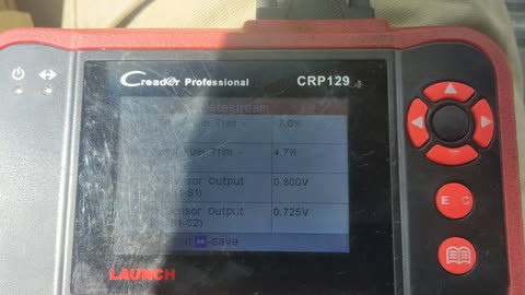

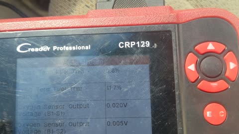

Anyways I'm about to drive the car with a passenger (lucky her gets to ride in my luxurious route econobox car) and will have them take video of the sensors live data. Will upload it later on today hopefully. Sorry I get so long winded. I like writing these things out in detail, so I don't miss anything and end up bloviating a bit.

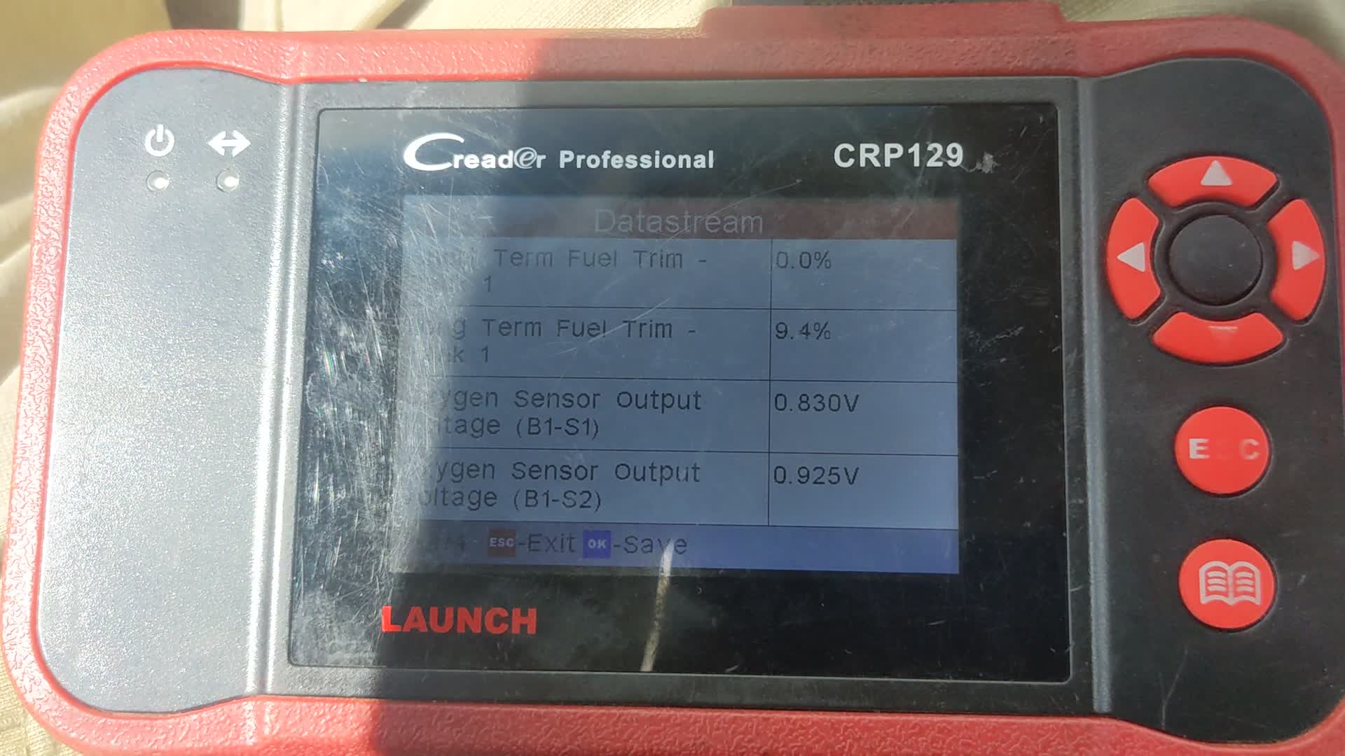

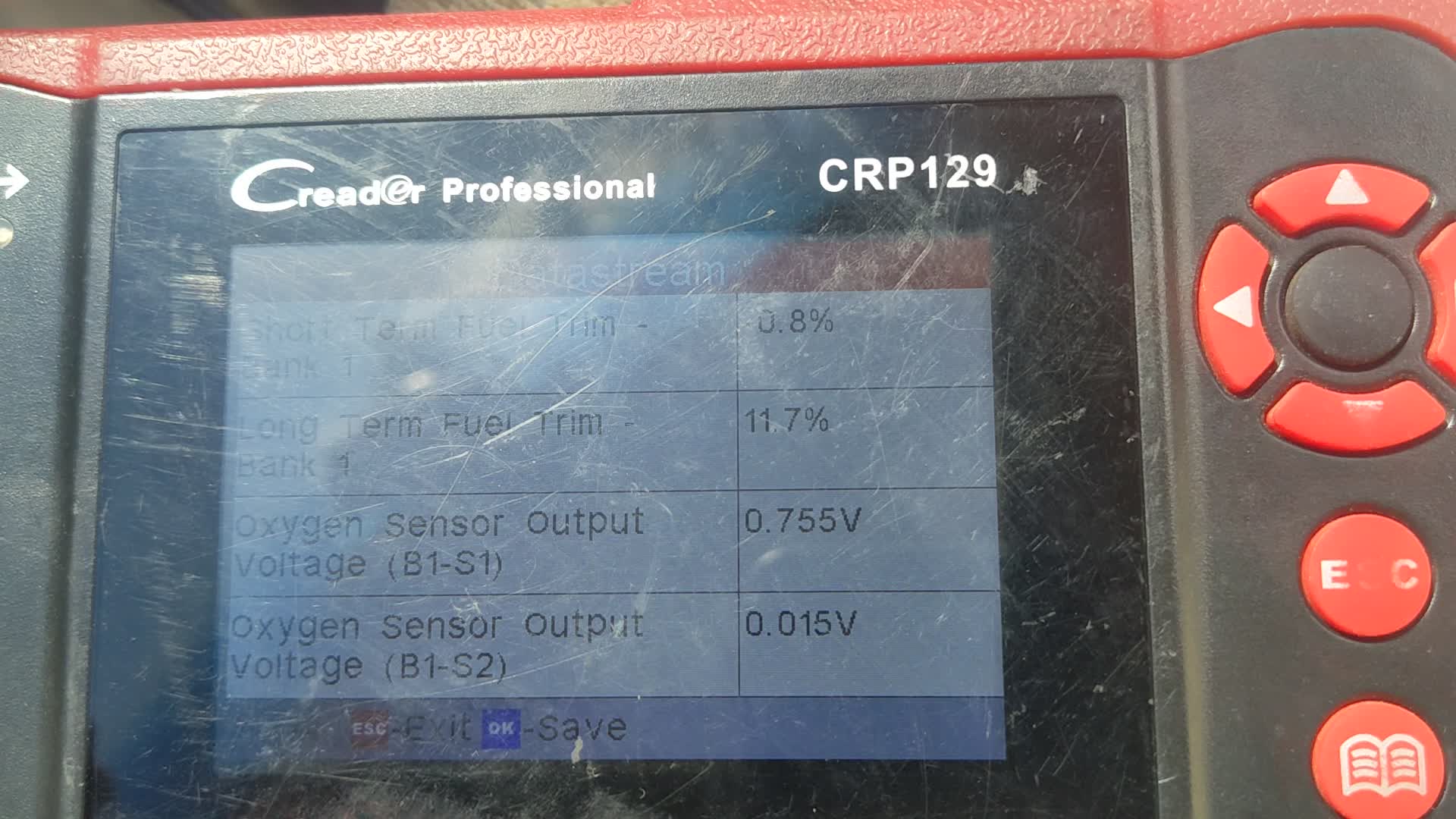

THEMAILMAN
  • 102 POSTS

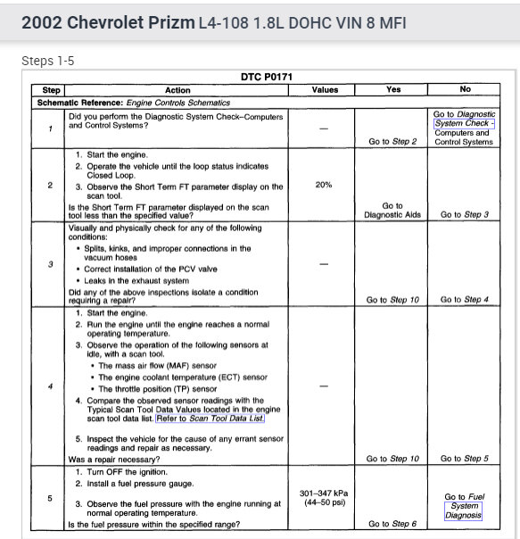

Okay. I finally got around to messing with it again. Now it is showing a P0171 system too lean B1S1 code. Can't find any obvious vacuum leaks so I'll have to get out the spray bottle later and tinker. But I got the video. I took two because I was shooting them myself and unsure what the quality looked like as I went. Neither is terribly good. If you want, I can retry in a few days.
The files are rather large. If need be, I can upload them to YouTube and put links here to save the storage space on your servers.
Mar 14, 2023 at 7:15 AM
  • 110,241 POSTS
The files are fine. It was a little hard to watch the second video because of sun glair. However, it appeared to be okay.

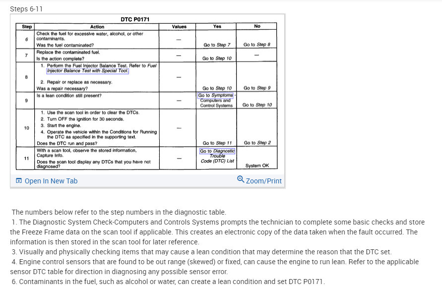

If you have a lean code, and you do, continue looking for vacuum leaks.
If there are no leaks, make sure there isn't an exhaust leak before the converter. That too can cause a lean code.

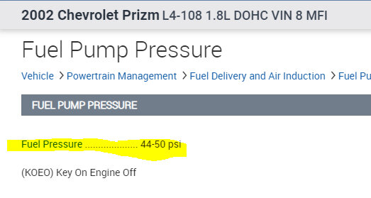

The last check is to confirm the fuel pressure is within the manufacturer's specifications.
Here is a link that explains how in general to test fuel pressure:
Pic 1 below provides the manufacturer's fuel pressure specifications. The remaining pics are the diagnostics specific to the code.
