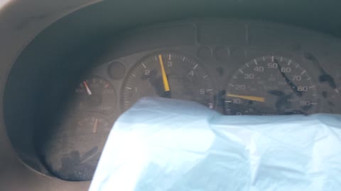

Well, after discovering that my cat was coming apart internally, I gutted the effer today. Took the Blazer out for a test run after and I've never had one of these do what happened in this video. I'm stunned. Stunned. I hit the speed governor in about 25 seconds from 0-95. I've gone 95 before, but never in one of these things. And I probably won't do it again either, considering it's a mail route truck and the suspension is in a constant state of flux (ie something is always broken down there, so it's handling is questionably safe).
By my count this is the 7th 4.3L Blazer/Jimmy that I've personally owned not including ones I've bought and sold. Only 1 was a 2wd. 2 were 2 door square body 4x4s (boy I miss those trucks). Never had one hit the governor before. And I was dumb back in the day, I've tried.

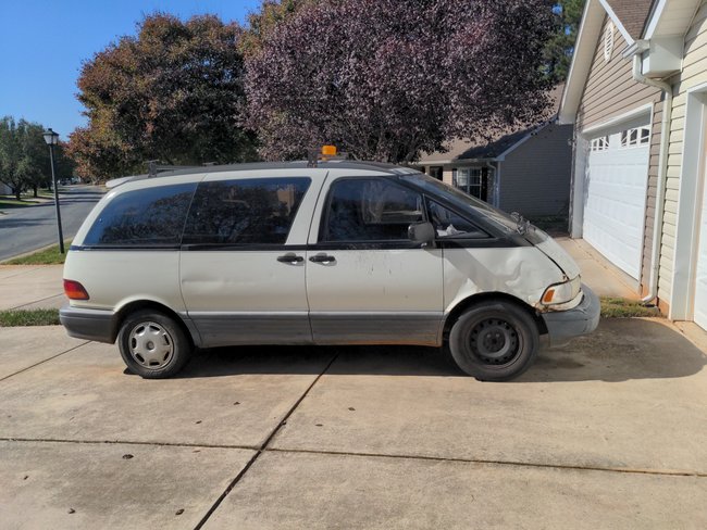

So I borrowed a 1993 Toyota Previa Minivan, which I lovingly call "the egg" from another mail carrier. It's his spare route car. It's ugly as hell. Dented and scratched like he's hit every mailbox on his route in it, but with only 110k on it it runs well. And it saved me almost enough in fuel to pay the $10/day I was paying him for it. Seriously I was using 2+ gallons less daily. Calculated over 12mpg, where the Blazer consistently hit somewhere around 8-8.5mpg. I've told him I could make some upgrades to it for free to make it better but he declined.

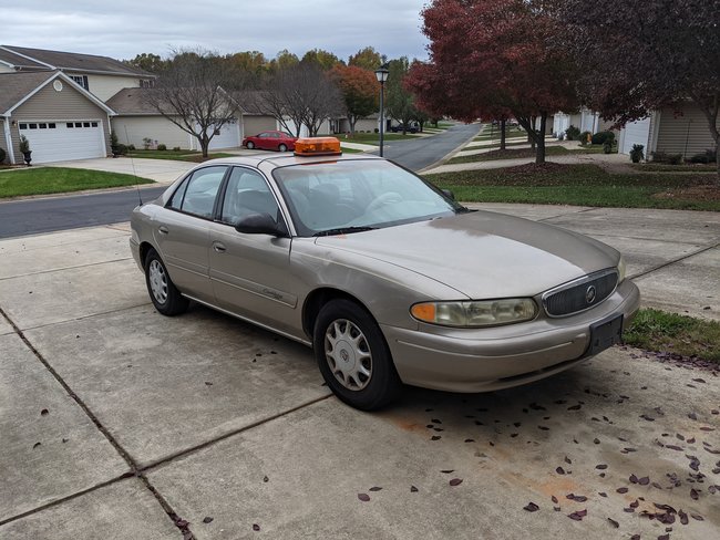

Anyways, I turned in the keys to the egg today, as I've replaced it with my new beloved 1999 Buick Century. 149k, 2 owner car, with a new battery, newish tires (75% treadlife left), new radiator and all hoses, and supposedly a new starter. Considering I had to jump the posts on the solenoid to get it broken loose because the car hadn't run in a few weeks when I got there, I don't the mechanic actually put a new starter on there. Probably a reman job or more likely one he had laying on the shelf. It also has new plugs and wires in it, but they're the cheapies, so they're getting replaced soon because the car stalling here and there and throwing a P0305 even though it's still pretty smooth running. 7mm wires and cheap plugs just don't do well in these cars, any halfway decent mechanic should know that.

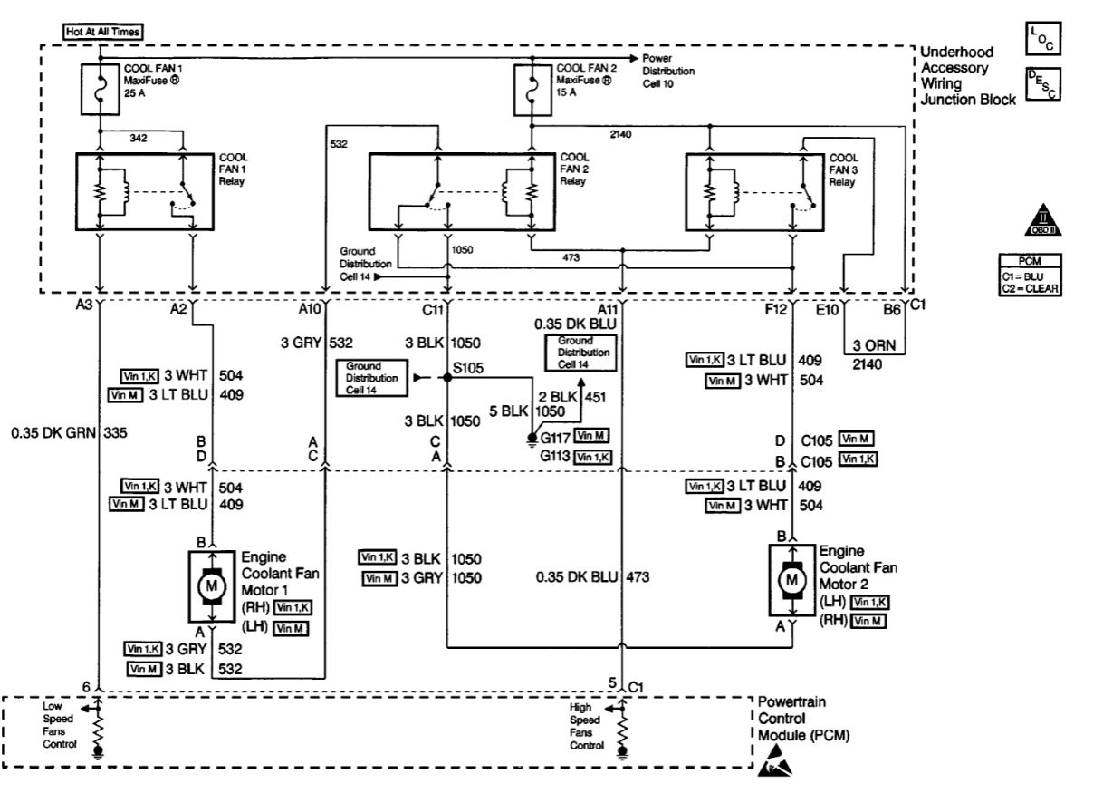

One question. With all of those new cooling system pieces, why is the temp gauge getting to 3/4 (110C according to live data) before both fans are kicking on. And shouldn't one of them be running pretty fast?
It's been a while since I've owned one of these as anything other than an investment/flip so I'm a bit out of touch here. Would I just run a new ground to speed it up and make it run full out?
Also, it seems like the thermostat is stuck open or more likely bypassed by the "mechanic." So I guess I'll address that and then see what's going down with the fans.
I'm so ready to dig in to this thing. I've got big plans for this little $550 steal. After driving that slow 4 cylinder rwd van with it's ridiculous turn radius and possessed radio (only comes on after the van has been running for a while, suspect cracked solder joints internally, also offered to replace free, also declined), this smooth riding, quick moving, powerhouse will make life easy again at work.
Good times ahead. It even came with a cassette adapter so I can hook my old phone straight to the radio and crank up the good tunes so the customers will know when I'm coming

110 would be around 220-225 degrees which is about right for the fans to be kicking on, they don't shift to high unless the temperature stays high and doesn't drop when they come on. The switch together on at low then switch to high as needed.

Hmmm ok. I'm going to put this thing on the route tomorrow. It'll be cool enough it that (1) it shouldn't be a problem and (2) I can run the heat. But I'm going to do a little custom work today. Perhaps I'll run a secondary lead from one of the fans to where I can direct connect it to the battery if something goes awry tomorrow as a quick fix. But from what you're saying it should be ok. It's just different than the efan experience that I have with the wife's Vue, which is both confusing and limited. But it's working apparently correctly now and she's not complaining about my work since her pseudo mechanic at the inspection, oil change, and used tire shop said it was good.

There are a few systems GM has used, one uses two fans where one comes on for low and both come on for high, then they went to the current system they have been using a while. In low the power goes through relay 1 and through fan one, then it goes up through the NC contacts in relay 2 and down to fan 2, then out of fan 2 to ground. That gives low speed on both fans by feeding both fans in series, so they see about 6 volts. Then if the system decides it's hot relays 2 and 3 trip, relay 2 now provides a direct ground for fan one and it gets full voltage, relay 3 tripping on now provides full battery voltage from fuse 2 so fan 2 goes to full speed. Actually, it is the same type of system I install on vehicles as well, instead of using the PCM to control them I use common temperature sensors that are available. The lower temperature sender turns on relay 1 and the higher temperature turns on 2 and 3 as needed. A car with A/C will be set up to trigger either both to low and you can set it up to trigger one fan to high, GM used both over the years.
