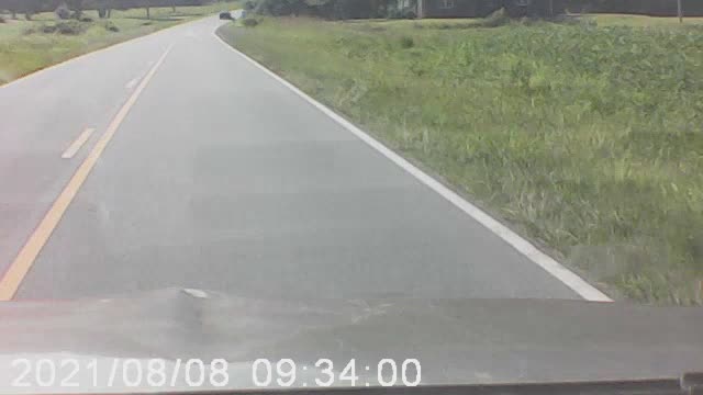

Indeed I've driven both the 2.2L Blazer and the LLV. I use a LLV every other week on Sundays. I one managed to clock 0-60 (GPS verified) in under 17 seconds by working the shifter like an old 3 on the tree while literally standing on the gas. Honestly, the LLV is darn near perfect for what it does and I doubt they'll top it with the next truck. The new one may be nicer, but I see it being problematic and our "less-than-stellar" won't be able to handle it. I've literally diagnosed the LLV problems for them only to find the truck with the exact same problem the day after they had it in the shop for a week. And it would be as simple as a stuck thermostat. I can't wait to see what they can do with post 1980s tech and AC

Speaking of LLVs, here's what's happened the last time I drove one. If I had to guess I'd say a mechanic didn't tighten the pulley bolts. Happened as I was merging onto I-40 (following GPS against my better judgment)

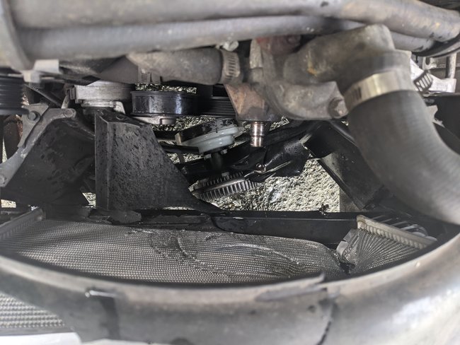

MASTER ASE TECH
  • 82 POSTS
I second the 80 PSI in the tires. Without switching the tires, run the PSI as high as you feel comfortable with. Also remove any roof racks or other things in the air stream, and strip all the weight out.
Dump the mechanical fan for an electric model.

HARRY P
  • 2,292 POSTS
I've thought about switching to an E-fan before but right now I'm just trying to go for free or dirt cheap mods I can do while saving cash to buy something else to use on a daily basis. Thinking I can get a little 4 cylinder beater car that runs good to use most of the year and just use the Blazer as a daily driver and run it only as needed on the route.

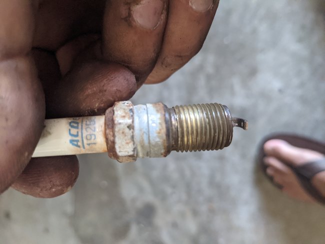

Well I finished up the plugs and wires. With the new ACDelco plugs and 10mm wires I did get a good carbon burning smell when I first started it and let it idle for a bit. I revved it a few times and it did ok but stumbled a bit in the 2-3k range. So I took it for a drive. First off I'll say I "think" I've got a better throttle response now. I drive it kinda hard. And it performed well. Hit it's gears fine. 0-80 was smooth. So the power is there. But at 1/4 throttle, there is a stumble on the 2-3k range still. It got better as I drove the truck, so maybe it'll work itself out. Or maybe it's time for some seafoam down the intake...
Any other ideas?
No lights. No codes, of course.

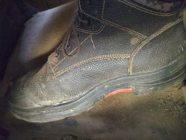

The image below is the from infamous cylinder #3 that many people hate fighting with (takes about 10 minutes if you know what you're doing). It definitely has some age on it. And it matches the other 5.
Aug 20, 2021 at 9:07 AM
STEVE W.
  • 15,421 POSTS
Look at those OSHA safety shoes LOL.... That plug is easy if you know the trick, or bought the specific swivel socket for it...

HARRY P
  • 2,292 POSTS
No such thing as OSHA in my own garage. But are these better? They're my postal approved shoes.

STEVE W.
  • 15,421 POSTS
Those are a bit better... Air filter wise, unless you are replacing one that is full of dirt I've never seen any real increases, unless you are running a vehicle that really needs a lot of air like a blower or large turbo otherwise they pass a LOT of dirt and crud, plus the oil tends to mess with the MAF. Speaking of oils, you might try putting synthetics in all the boxes, might give a bit more.

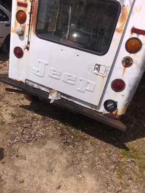

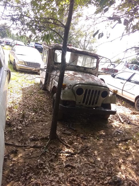

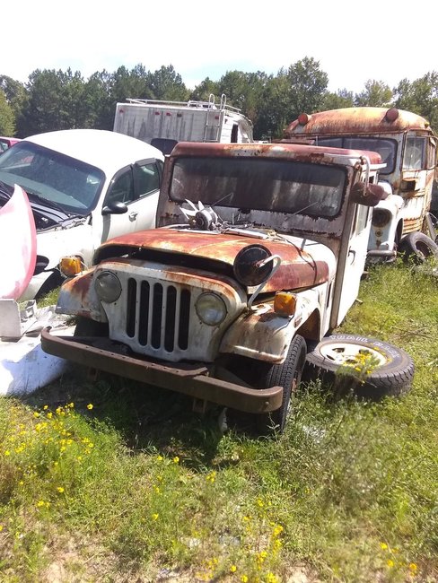

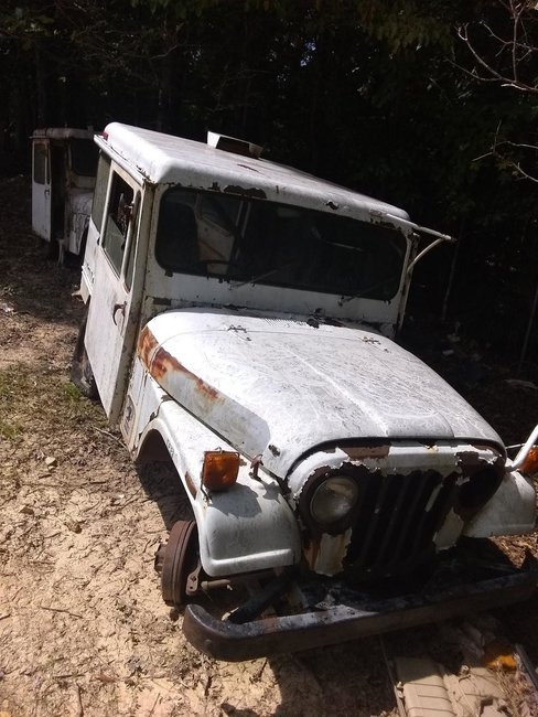

CJ MEDEVAC
  • 11,000 POSTS
I was just there today, these four got to the yard within the last year (since the last time I went)
Revert back to the "Proven" / "Accepted"/ "Reliable" mail method. Inexpensive parts.....computerless.....permanent Code "PO (post office)EZ FIXIN'"
With the money you're spending, one of these could be back up and running with proven MPG modifications!
I feel like one of them will make it back to my house, hopefully a deal (as he's given me in the past) He and my brother and law are best buddies!
They might stop calling you the "mail blazer"/ "mail van" and you earn the "Mail Man" designation as did all of the previous Postal "JEEP" drivers were called!
