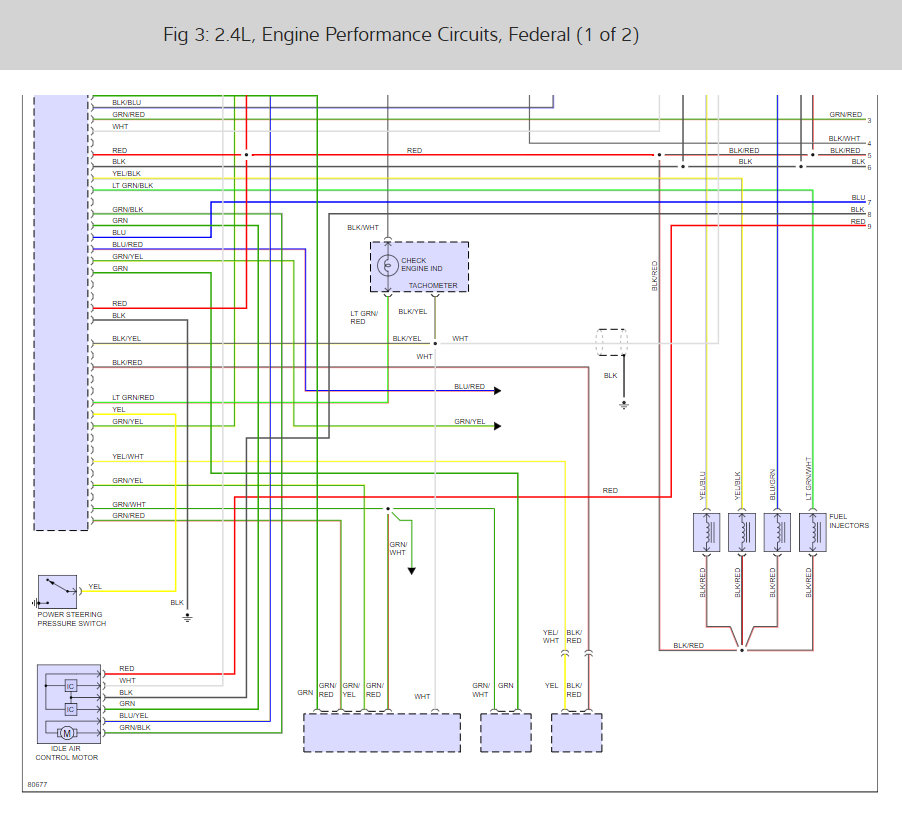

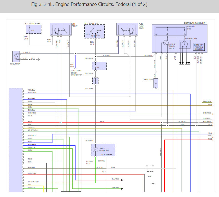

Wife's car stopped running. The mechanic replaced the fuel pump and said the fuel consumption module was not working. PN MR161489. After looking all over I cannot find the part for sale. I did find a thread that said Diamante module might be compatible there are several of those to be had.
Aug 15, 2018 at 8:45 PM
  • 54,837 POSTS
Hmm, never heard of the fuel consummation module. Here is the engine and fuel pump wiring diagrams so you can see for yourself there is no such part, what problem are you having?
