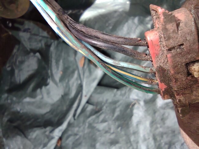

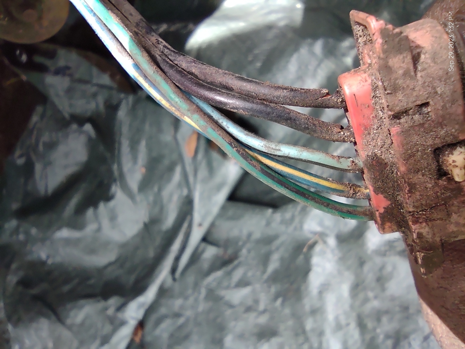

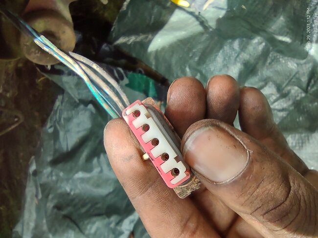

Here are the pictures one for the connector I got to replace and one for the connection I got to make.

As long as that fits securely into the module, you should be fine. Take your time and make sure the correct color wire on the vehicle is connected to the same pin in the new connector. They need to be aligned so that each pin is in the same order as the original one.

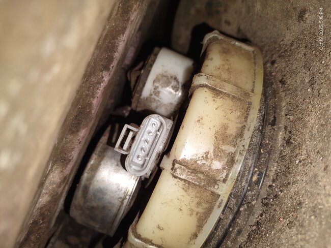

Hello, I am back. I apologize I may have miscommunicated but that's the old connector that I need to replace, now if I get another electrical housing that's similar or could fit into that third picture would I be able to repin the wires myself and connect it that way?

Yes, you could do that. However, you may want to see if there is one in a salvage yard, so you don't need to repin it. Interestingly, I tried to find you an aftermarket one, but everyone I found has a 4-pin connector. However, if you have a connector that properly fits, certainly you can make it work.

Got it all hooked up and the truck read fuel and whatnot. Turned over as well so whatever happens from here is a plus honestly. I ended up pulling a five pin from a 93 at pick and pull.
