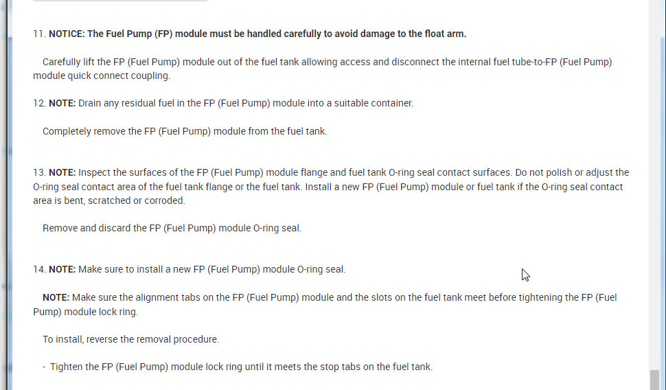

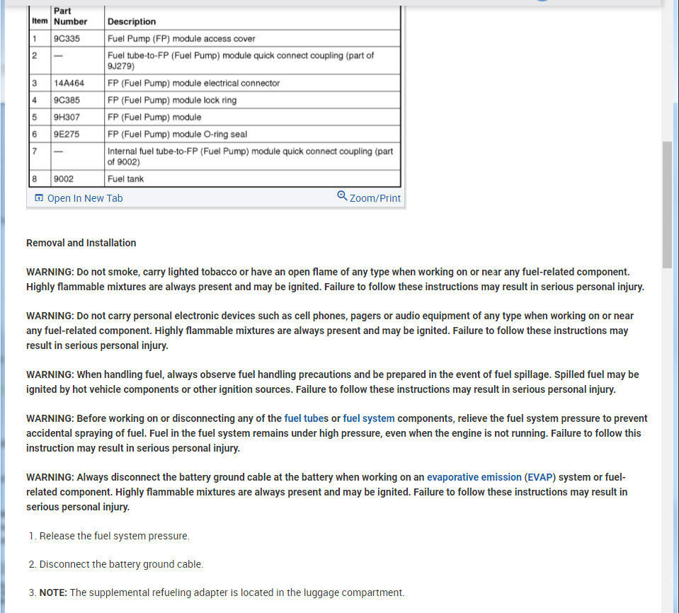

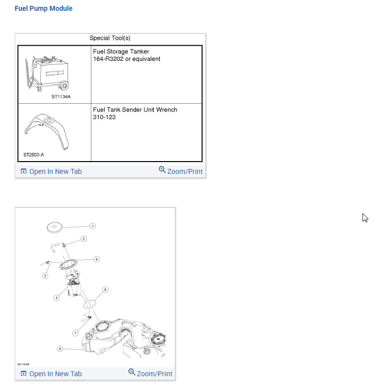

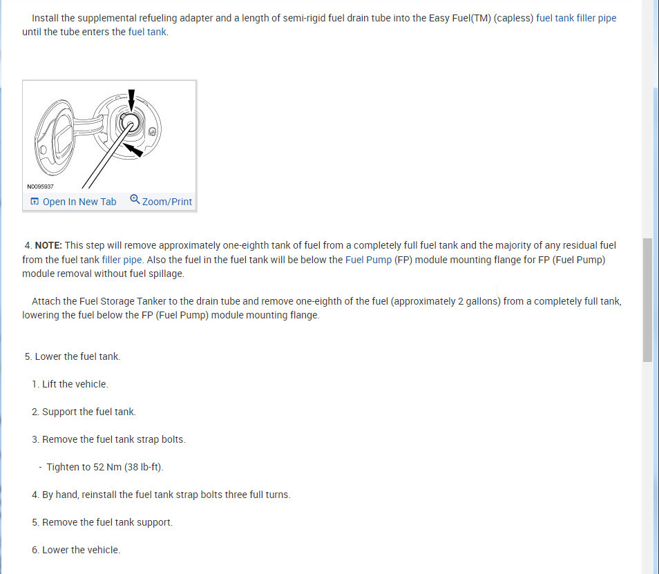

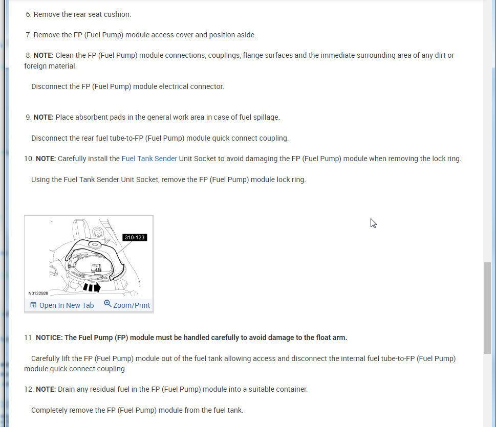

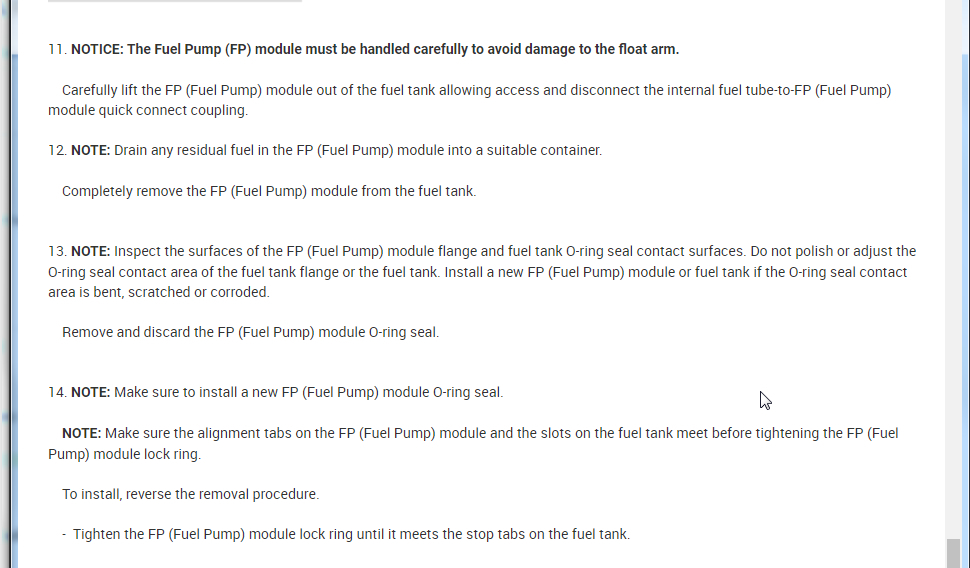

That is a shame that this happened. Here are some guides that will help with step by step instructions:
https://www.2carpros.com/articles/how-to-replace-an-electric-fuel-pump
Below is the process from the manual that will give additional details. Please let us know if you have other questions and how this turns out.
Thanks
