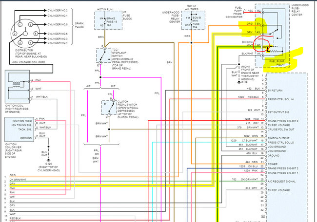

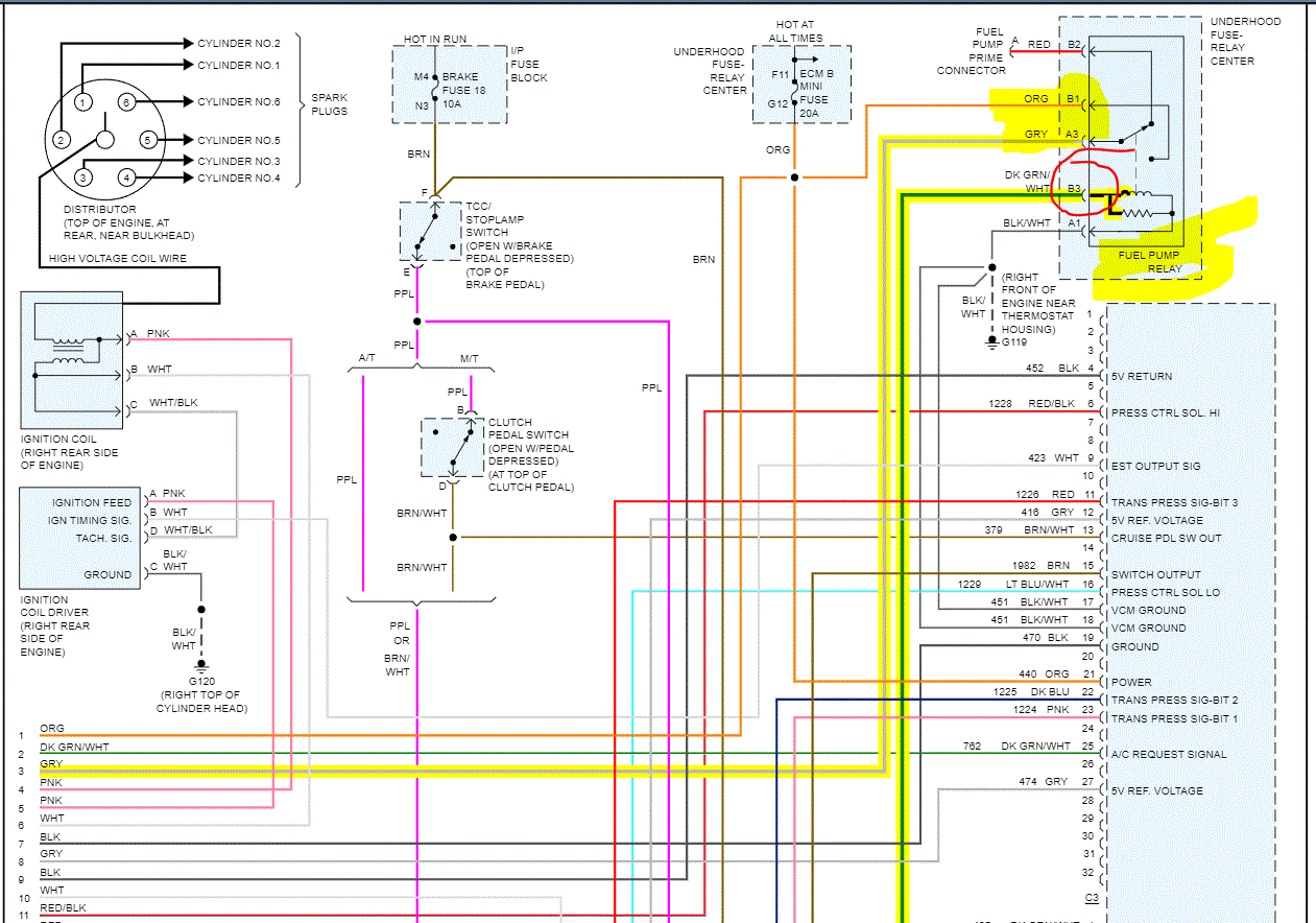

I attached a wiring schematic below. First, confirm the 20amp ECM B fuse is good in the under-hood fuse box. That is the fuse that powers the pump after the relay is triggered.
Next, reconfirm if you are getting a signal to the primary side of the relay. Note that it will be a very brief signal, so have a helper turn the switch from off to on while you check.

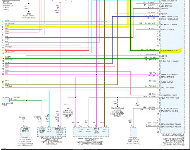

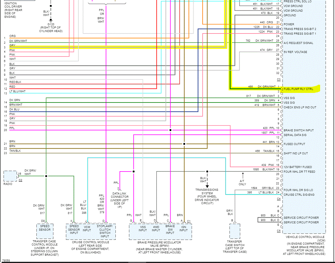

If there is no signal, then you need to go to the PCM and check connector 3 pin 1 (dark green wire with a white tracer) to see if there is power to trigger the relay.
Let me know. Also, note that the grounds for the relay and VCM circuits are tied together at G119 near the thermostat housing. If that ground has failed, it would cause the problem.

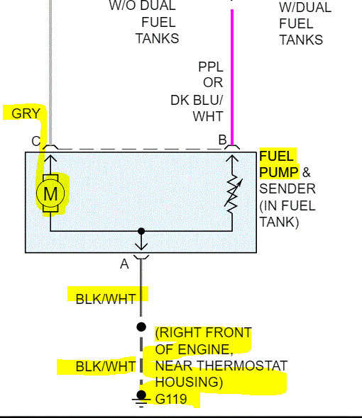

  • 110,194 POSTS
Jerry,
According to my schematics, the ground is a black wire with a white tracer.
The gray wire you mentioned is the power supply for the pump. The purple wire is for the fuel level gauge.
Is there no black wire with a white tracer?
See pic below.
Apr 10, 2022 at 7:32 PM
JERRY PLANCK
  • 14 POSTS
Joe, the black and white wire is what i need to test, do i test for continuity or resistance? I'm testing the plug at the fuel pump and if the black and white is not working (grounded) wouldn't the pump still run with the pump's black wire being grounded to the frame? can i tie in a new wire to the black and white wire and ground it somewhere?
Apr 11, 2022 at 10:42 AM
  • 110,194 POSTS
Jerry,
Check the black/white wire for continuity to ground. Also, if it has no ground via that wire, the pump won't run. And yes, you can provide a new ground.
According to the schematic, the pump doesn't have a black wire, only a black/white one for ground. The pump gets power from a gray wire. The ground is black/white.

  • 110,194 POSTS
I attached the schematics above. If it runs, you have a weak ground that can't handle the load placed on it. At least, that is my theory.
You can do this two ways. First, recheck the grounds at the engine. Actually, remove them, clean and inspect and reinstall. Or you can simply run a new ground for the pump.

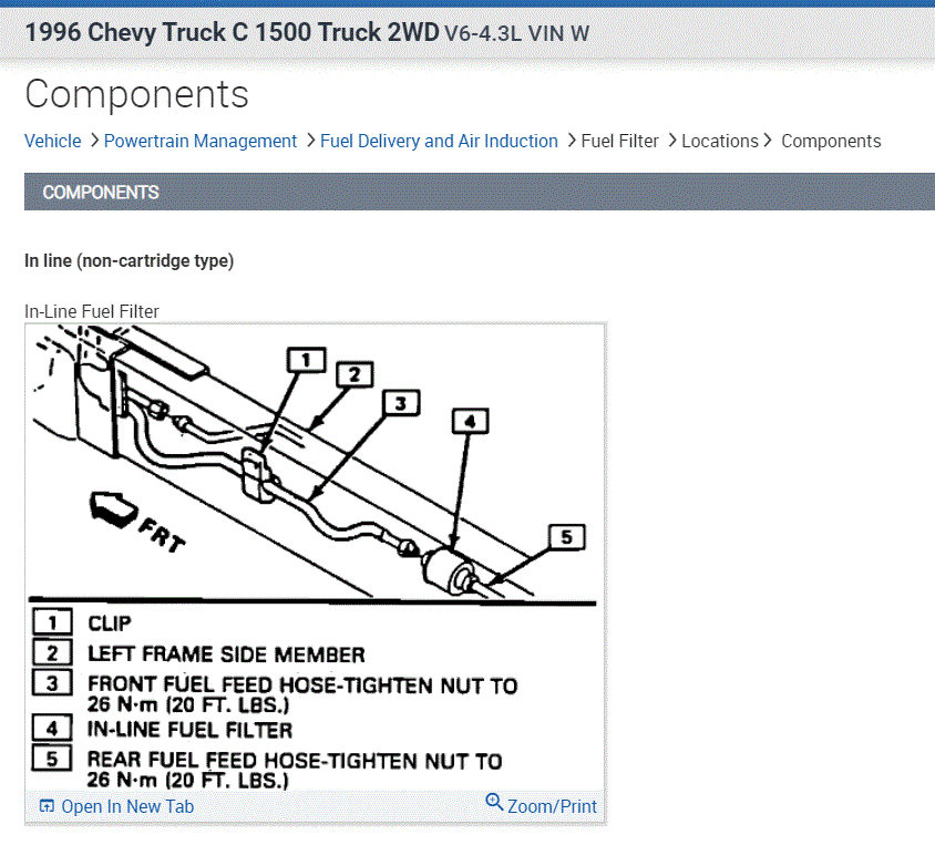

As far as the fuel pressure, I'm asking about the wiring to eliminate power flow. If that isn't the case, then either the fuel filter or the pump itself is weak. Have you replaced the fuel filter? It's along the side of the frame. See pic 1 below.
