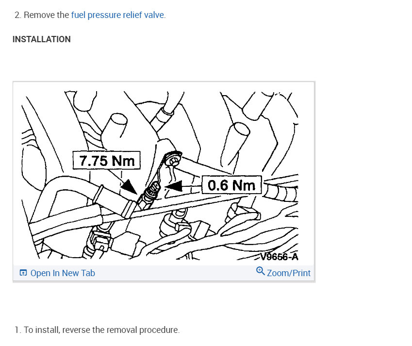

The truck listed above is an XLT. Engine light came on obd code lean fuel in bank 1 put a new PCV valve on. The truck started acting rough when idling and cutoff, it would backfire and act like it wasn't getting any fuel. I have put a new fuel filter, air filter, MAF sensor and alternator (battery light wouldn't go off on dash battery wouldn't hold a charge. Battery is fine per AutoZone. Still having the same issues. Fuses and relays checked also. Any help would be appreciated. CAM

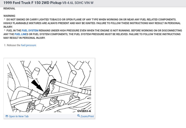

It sounds like you have a weak fuel pump, here is how to check the fuel pressure so we can confirm the issue. The battery light problem you need to start a new question for because we only handle one problem per thread. Here is a guide to help you check the pressure and you can rent a fuel gauge for free or cheap from the local auto parts store.
Engine Running .................... 193-310 kPa (28-45 psi)
Key ON Engine OFF .................... 240-310 kPa (35-45 psi)
This guide may help as well
https://www.2carpros.com/articles/repair-lean-mixture-codes-p0171-or-p0174-on-some-manufacturers

I checked the fuel pressure engine running it was 30psi. Key on Eng off I got no pressure. It sounds like the fuel pump needs to be replaced.
