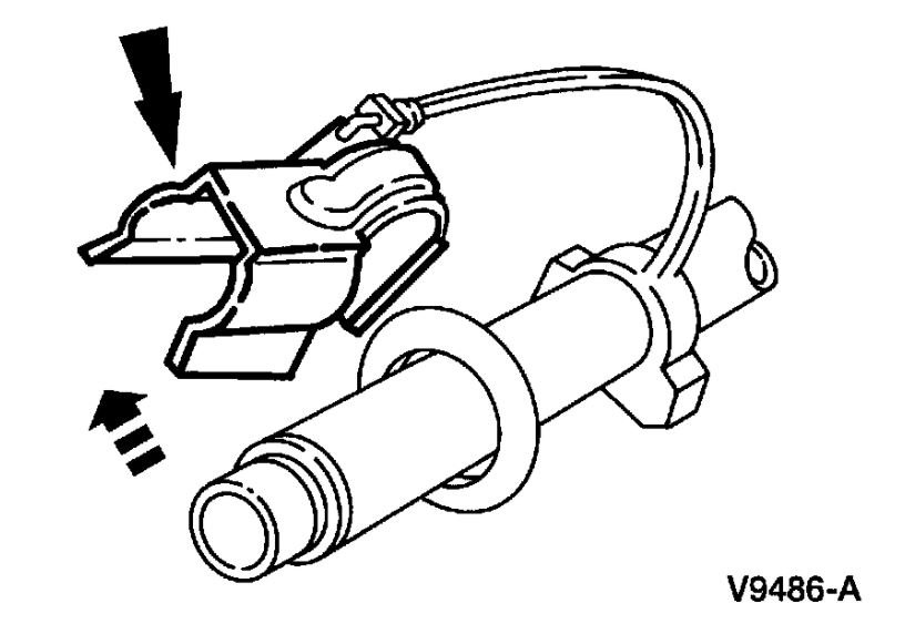

When installing new injectors does a retainer clip have to go back on? and will it sound like your truck's missing? Will it be weak on power if you don't put the retainer clips back on the fuel injector right underneath the fuel rail?
Jan 15, 2021 at 4:01 PM

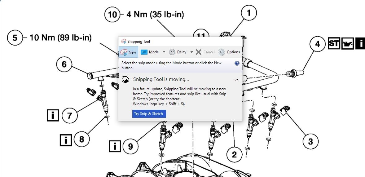

The clips are required to be installed to keep the injector from leaking fuel externally. If they are not there, then the injector could leak and cause a fire. It has nothing to do with the performance of the engine. Check out the diagrams (Below).

Items 9-7: Fuel Injector-to-Supply Manifold O-Ring, Fuel Injector and Fuel Injector-to-Intake Manifold O-Ring Installation Note
1. CAUTION: When installing the fuel injectors, make sure that the injectors are fully engaged in the fuel injector cups.
NOTE: Lubricate the new fuel injectors with clean engine oil.
Install new O-rings on the fuel injectors and install the fuel injectors.
