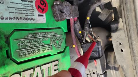

Front wipers sometimes come on randomly when I unlock the car, go over a pothole, or just any time while driving. Eventually it goes off but sometimes stops fully open.
I've replaced both the BCM and ECM to fix other electrical problems and replaced the wiper switch. What else can I check? Relay? Wiper motor? I heard there may be a separate intermittent wiper module.

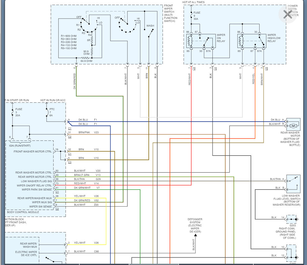

This could be a couple of issues so the way we need to figure this out is to start checking power through the wiper system when the wipers are on, and the switch is off.
Basically, we need to find out where the power is coming from. This is most likely a short or connection issue but normally a loose connection normally causes them to cut off.
On newer vehicles when the module loses connection it will default the wipers on as a safety measure. This vehicle does not have this.
So I suspect this issue is there is a wire that is rubbed through and when you hit the right bump it grounds out and turns the wipers on.

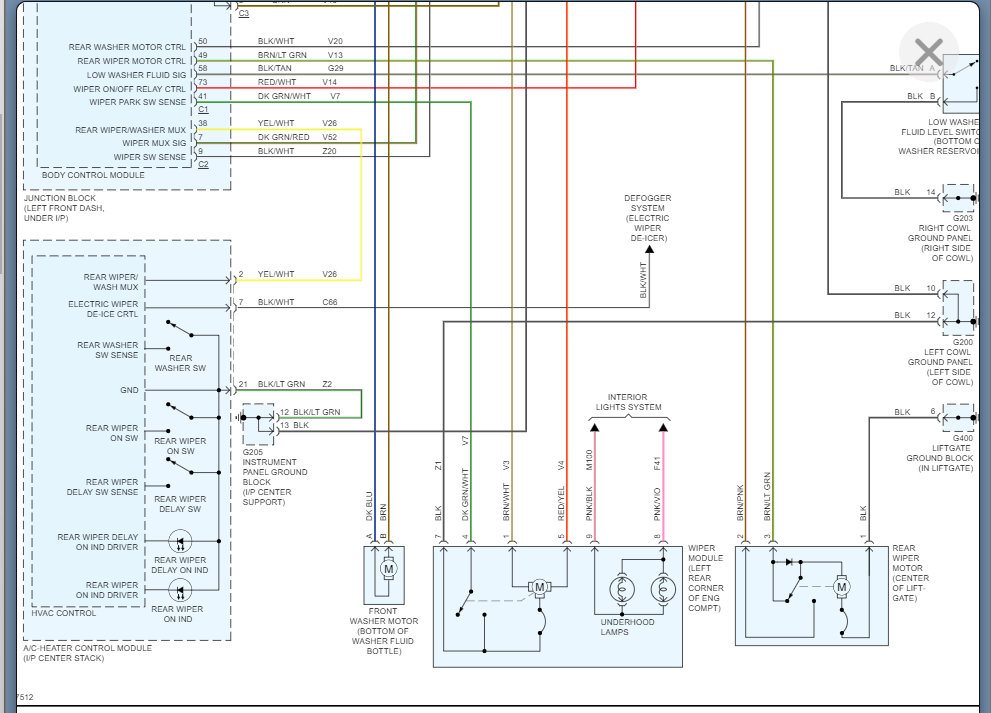

I am attaching the wiring diagram below but let's start at the motor and work backwards when the wipers are on to find where we do not have power.
Let me know if you have questions on this but this could be a relay issue as well so let's start with this and go from there.

It could be the issue, or it could be the wiper motor itself. Either way, when this is happening that will show up because we will have voltage on the dark green/white wire when they are running, and the switch is off. This is the park control wire. Basically, when the motor is commanded off by the switch (turned off) then the BCM will keep the motor running until it reaches that parked position and then cuts it off.
No matter what, we need to test the voltage on these wires when the motor is running, and the switch is off to see where the voltage is coming from.

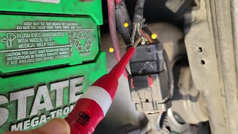

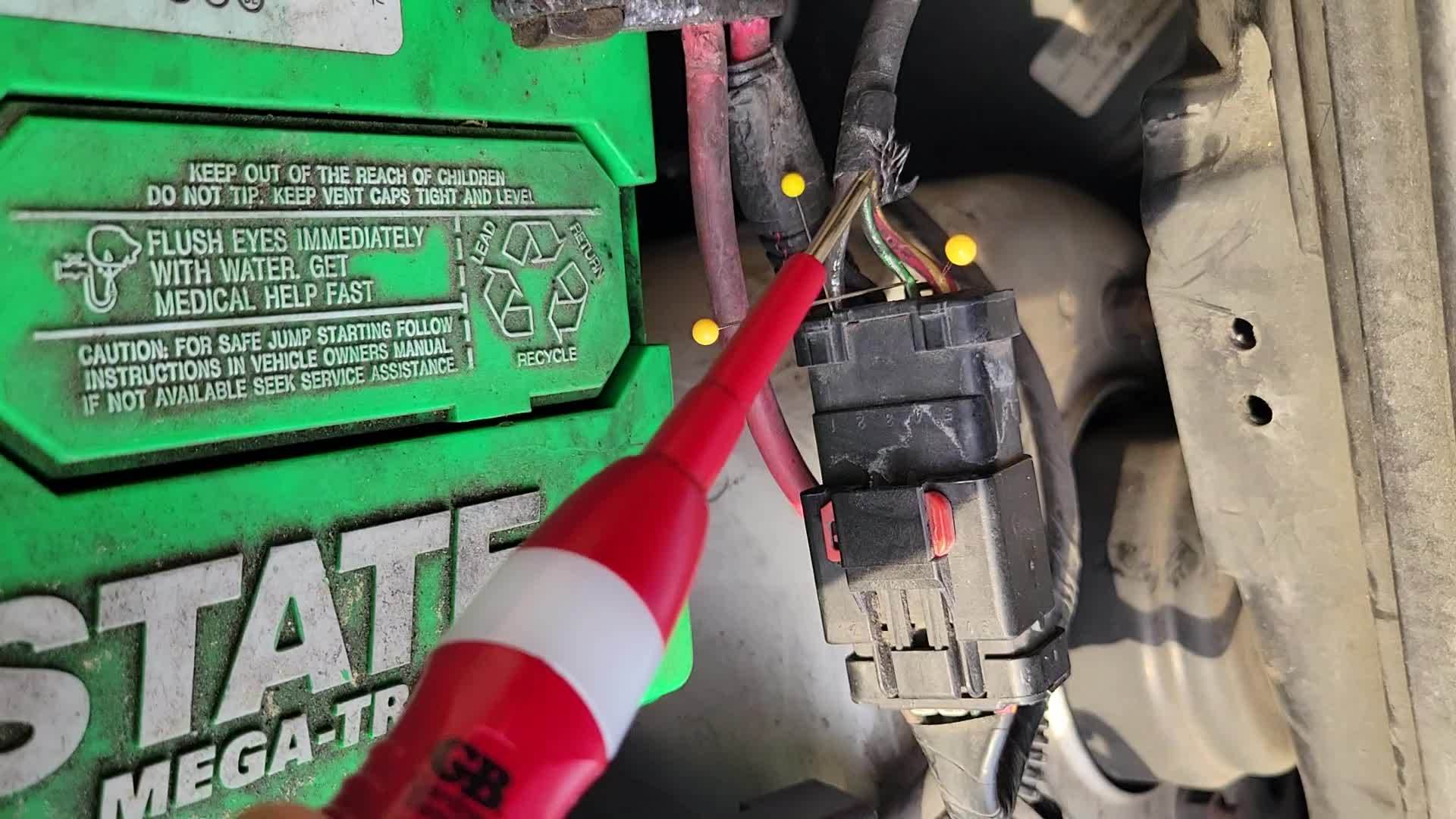

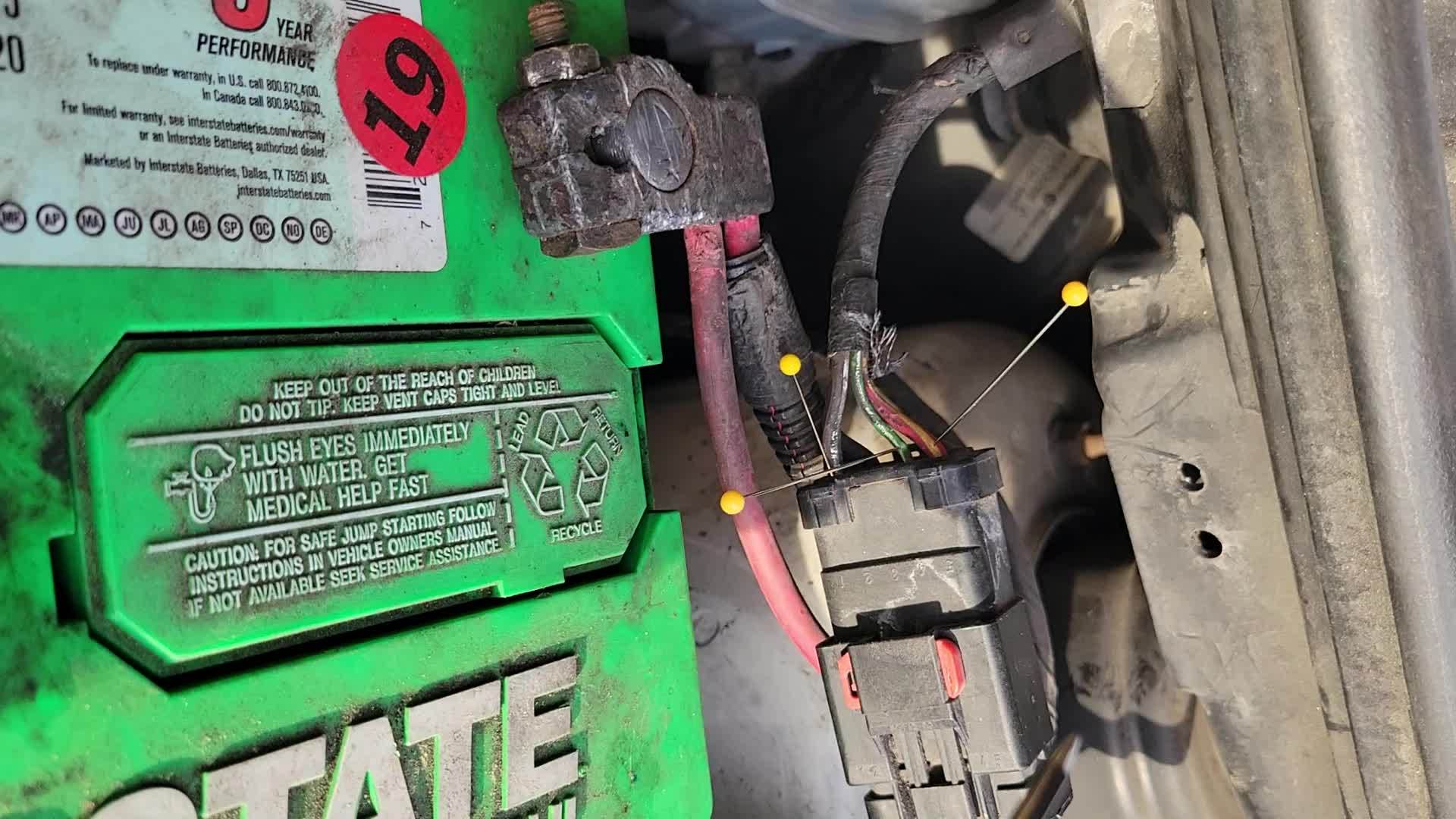

so, both the red and the black/white are hot when the wipers are on. Often the wipers continue running when the switch is turned off. But if I touch the green/white with the tester when they are running with the switch off, the wipers stop immediately. Sometimes they remained stopped when released and sometimes resumed running. The green/white doesn't have enough voltage to light the tester but touching that wire can stop the wipers from running.

The red and black/white are both hot whenever the wipers are running, whether the switch is on or off. see previous note for green/white info.

As this is random it doesn't always turn it off when I touch the green/white, but the shorter video demonstrates that at the end. Sometimes when I turn the wipers off, they keep running as demonstrated. Sometimes they come on even when no one is in the car and the key is off.
I did change out the BCM recently to fix another problem and the wiper problem was unaffected by that change, so I don't believe it is the BCM. Think it must be the motor itself.
Jun 3, 2022 at 1:23 PM
That is great. Okay, yes. I suspect the motor would be the issue.
Basically, the park switch is inside the motor assembly. The fact that you recently replaced the BCM pretty much leaves the motor. The only other thing it could be is a sticking relay. However, I thought you said you already replaced that.
