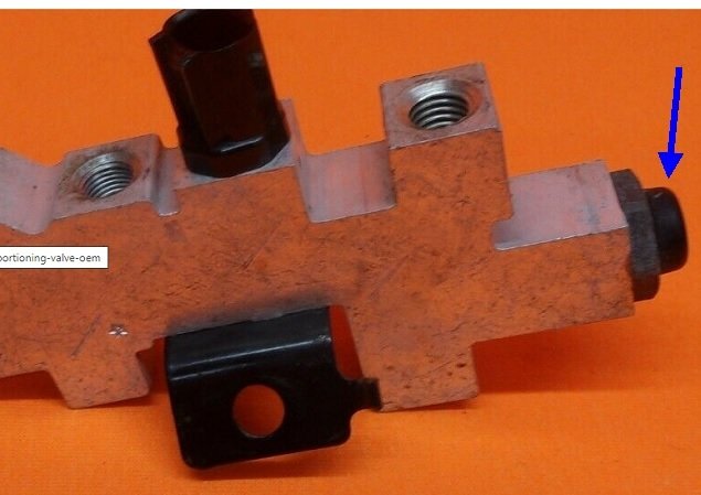

Proportioning valves limit the amount of brake fluid pressure that goes to the rear brakes. Under hard braking, a lot of weight transfers to the front, making rear wheel lock-up a possibility. At some point, even though you push the brake pedal harder, no additional brake fluid goes to the rear.
For too-easy front brake lock-up, one thing to look at is the "metering" valve. That is also in the combination valve assembly. That's the brass block the two steel lines run into from the master cylinder. The metering valve is also called the "hold-off" valve. It is in the line going to the two front brakes. It's job is to stop brake fluid flow to the front brakes until enough pressure has built up to cause the rear shoes to move out and contact the drums, then all four brakes apply at the same time.
A small special tool used to be used by some mechanics to hold the metering valve open for gravity-bleeding, (the only method I use). If someone forgot to remove that tool, you'll have front brakes locking up too easily. Very few of us ever use that tool, and it really isn't needed for bleeding. It's just a piece of spring steel bent into a "U"-shape. It clips behind the small stem that's sticking out on the front of the combination valve. Most of the time you can see that stem move out just a little when a helper pushes on the brake pedal.
There are many other variables to consider if major repairs have been done in the past. In particular, there were some years where up to four different brake calipers were available. There were two different-size pistons and standard and low-drag versions for each piston size. If you got used calipers from a salvage yard, they may not be the same as the originals. If you swapped out the entire rear axle assembly, you may have installed one with smaller-diameter drum brakes. That reminds me, a common cause of front lock-up is rear shoes badly out-of-adjustment.
Combination valves are very carefully-calibrated for each specific model. It's very easy to get the wrong one from a salvage yard. Failures are rare, but the wrong one could be installed as part of crash damage repair.

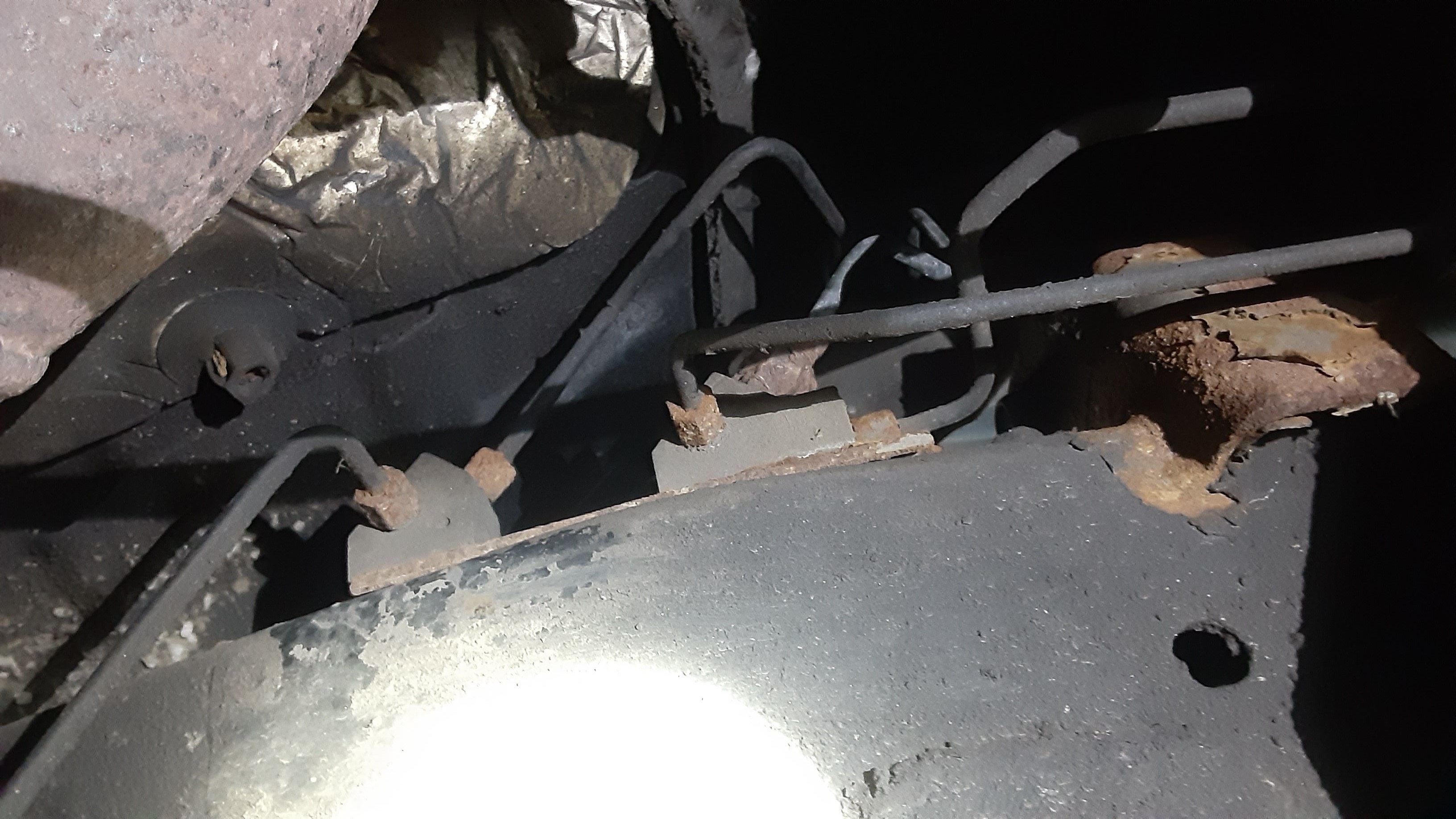

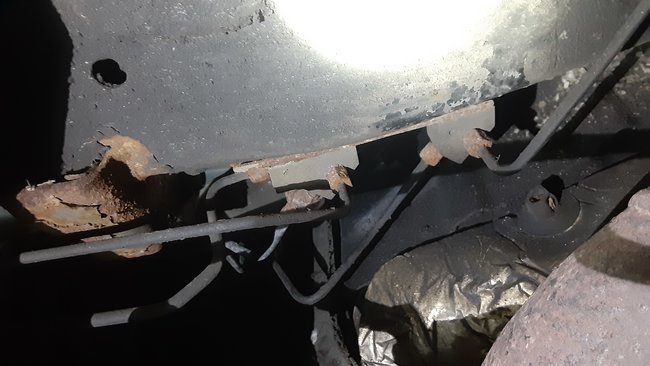

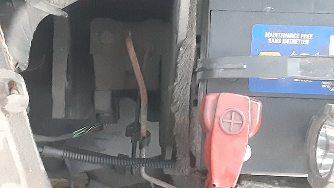

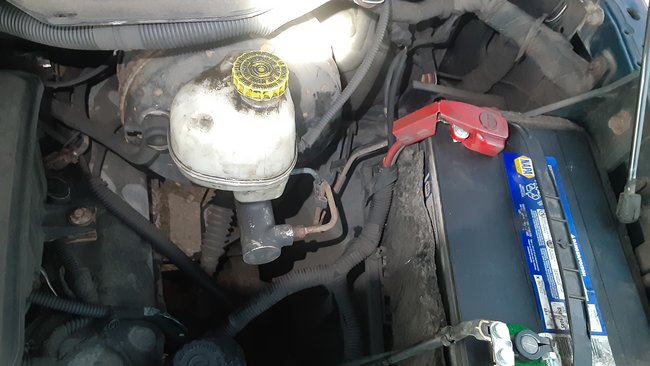

All there is on the lines is brace blocks to split right and left for front line and one for the rear line from the ABS module.

I can't find any reference to a height-sensing proportioning valve in the rear hydraulic system. That surprised me, but it is likely the engineers assumed the RWAL system would take care of that.
After discussing this with a few other people, we kept coming back to the metering valve in the front of the combination valve assembly. To add to the insult, I can't find any reference to this assembly for 2007 or newer models. Seems this is also handled inside the RWAL valve assembly. In case I'm wrong, here's a photo of a typical combination valve. The blue arrow is pointing to the end of the metering valve. That used to be a small stem poking out, and you could physically see it move when a helper pressed the brake pedal. This one is covered with what looks like a rubber cap. My guess is you should be able to feel the valve move under that cap when your helper pushes the pedal. If that valve is stuck open, the front brakes will apply too soon, but also remember, its purpose is to delay or hold off the application of the front disc brakes until the rear drum shoes have had time to move out to the drums. You don't have rear drum brakes, so a metering valve should not be needed.
I also found this on AllData:
DESCRIPTION - ELECTRONIC VARIABLE BRAKE PROPORTIONING
Vehicles equipped with ABS use electronic variable brake proportioning (EVBP) to balance front-to-rear braking. The EVBP is used in place of a rear proportioning valve. The EVBP system uses the ABS system to control the slip of the rear wheels in partial braking range. The braking force of the rear wheels is controlled electronically by using the inlet and outlet valves located in the integrated control unit (ICU).
but they aren't clear as to whether this is part of the RWAL system or the four-wheel-ABS system.

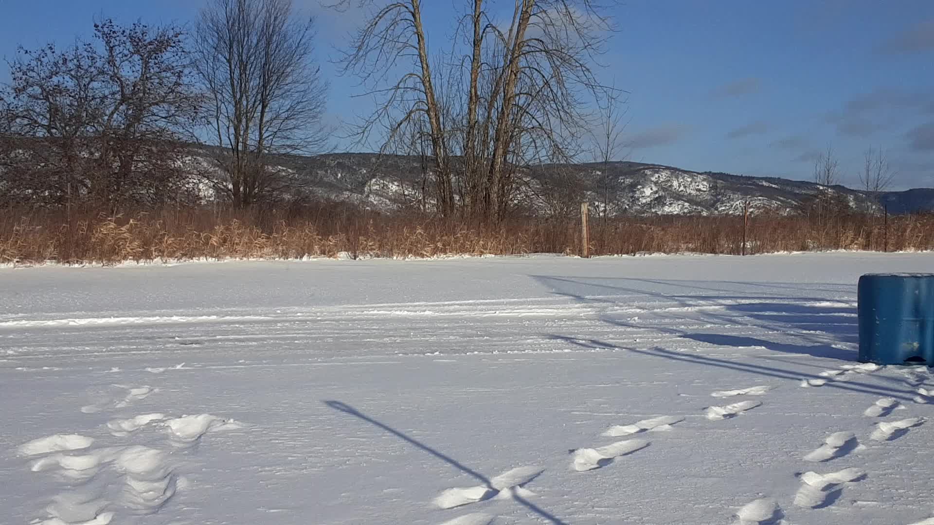

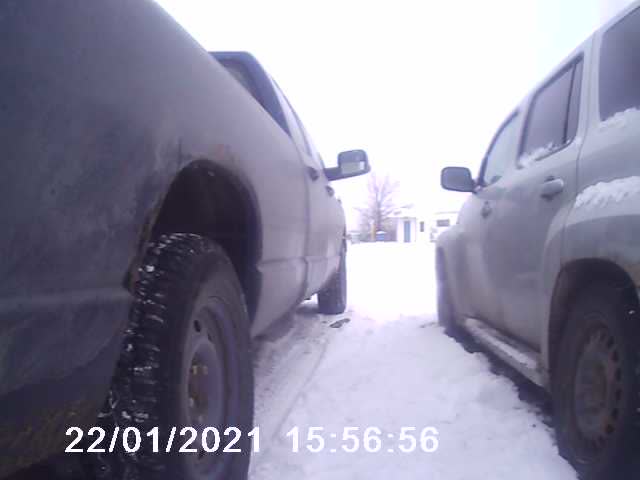

Here a video at very low speed just to show what it do.
Jan 22, 2021 at 3:42 PM
CHRIST CHEN
  • 36 POSTS
It's the best I can do as video, being alone at 40km/h(20m/h).
