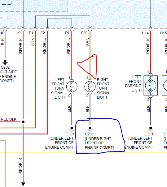

I tried replacing the bulb, did not work. checked the original bulb and it is good as well. When I turn on the right turn indicator the replay is clicking at twice its normal rate. Is there anything that I might be missing? I don't see a a fuse for it.

If it flashes double time, that indicates a bulb is bad or the circuit is open. If you checked the bulb, then we need to see if power is going to the socket and if there is ground as well.
I attached a pic from the schematic below. In red, I marked the power supply, which is a brown wire. You need to check that for power when you have the flasher turned on. You can use a test light to do it.
The black wire I circled in blue is the ground. You need to check continuity to ground to make sure it is good.
Let me know if the rear light is flashing on that side as well.
