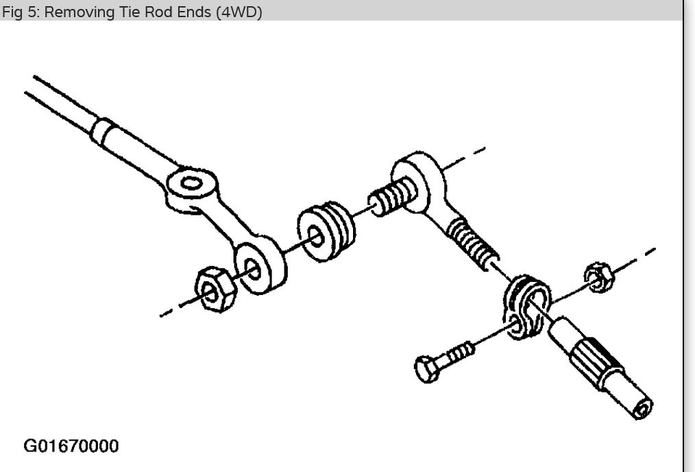

how do i get the inner tie rods off? i have replaced both outer tie rods. how do i do an alignment? how do i straighten my steering wheel?

remove the nut holding to idler arm, use a pickle fork to break tie rod away auto parts rent it. then undo nut on clamp unscrew tie rod counting turns then reverse for assembly. alignment should be professionally done as you do not have any correct tools for doing it as front wheels need to be aligned to the rear wheels.

i had the front end aligned two months ago not worried about caster camber just toe if the wheels are in aligned with the back mine is a solid axle a string will do that. i just took my framing hammerand swung it like i had a pair on the inner tie, rod three smacks and it jumped off easy breezy, but thanks anyway.

You're a goofball. HMAC 300 is being too tactful when he told you to get a professional alignment. The string trick is only done on race cars in the pits. They were previously set up in the shop with an alignment computer or older mechanical gauges. You also must consider that you're measuring at the fronts and rears of the tires. Alignment specs are measured at the fronts and rears of the wheel lips. We measure "total toe" to a hundredth of an inch. A common spec for good tire wear is 0.12" toe-in plus or minus 0.06". You'll be real lucky to get within 0.50" with a string that can be stretched. Also, asphalt race car tires don't have grooves in the tread. That makes scribing lines around them pretty easy. With dirt-track tires, toe is not very critical.
At the risk of helping you avoid having a proper alignment done in the future, I have a trick I can share. When you are starting with a perfectly centered steering wheel, replace only the one or both tie rod ends on one side of the truck first. Drive it to see where the steering wheel is on a straight road. If it is to the left, turn the adjuster for the new tie rod end(s) to turn that wheel to the left to match the steering wheel. (On GM trucks, the outer tie rod end has normal threads. The inners have reversed threads). Drive the truck each time and repeat that until the steering wheel is straight again. It can only be straight when that wheel is put back exactly where it was. Now do the same thing to the other side if that side also needs one or both tie rods replaced. This will get you close enough that the truck can be driven to the alignment shop.
If you don't follow my trick, once you have tie rod ends replaced on both sides, there is absolutely no way to center the steering wheel and get total toe correctly set. Even if you get close, take the truck for a proper alignment. If you go to the same shop as before, they might make you a deal since you were there recently, or if you ask to only have toe adjusted. Be sure to tell them about the new tie rod ends. When they replace parts, they take on the responsibility for proper installation. When you replace parts, they are free of the liability for that, but they are still going to check your work and look for problems. The most common do-it-yourselfer mistake has to do with how far each tie rod end is screwed into the adjuster sleeve. Typically on this model that is 28 turns, but it can vary a lot. You don't want one with only a half dozen threads engaged when the final adjustment is finished.
