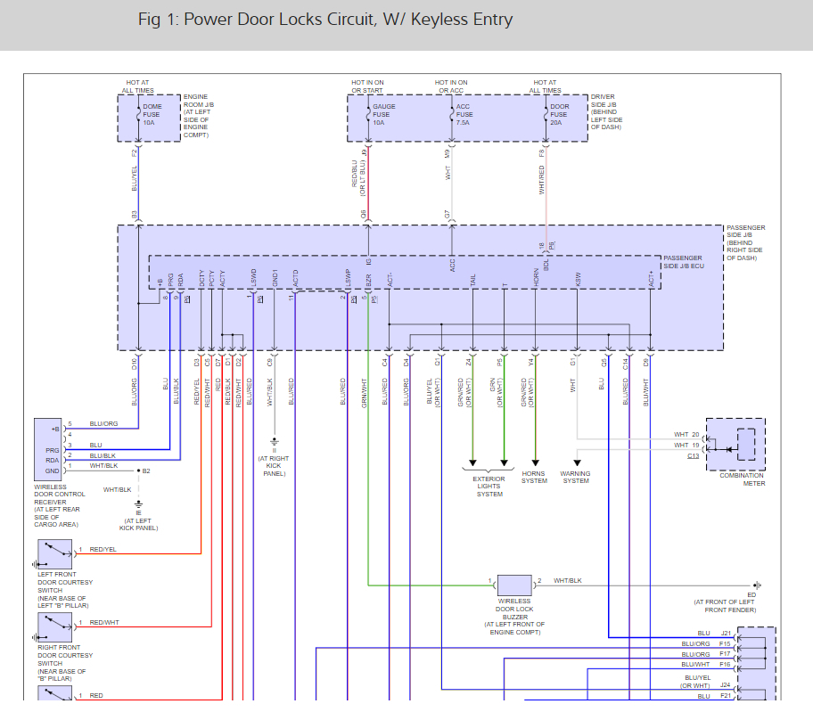

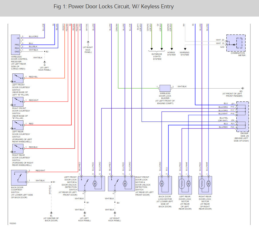

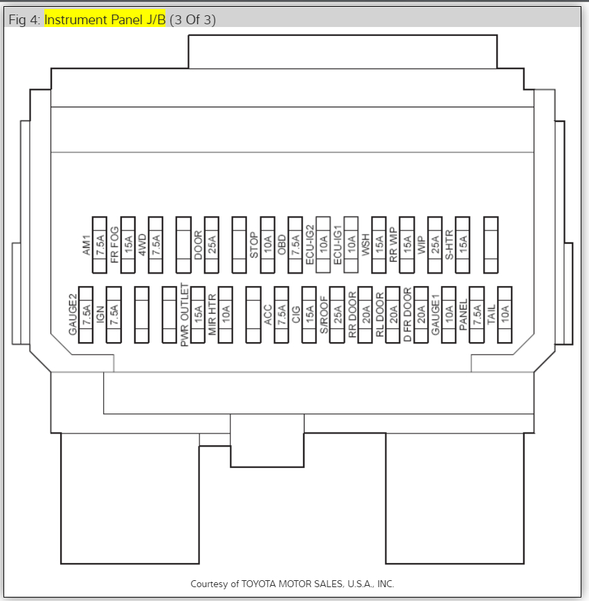

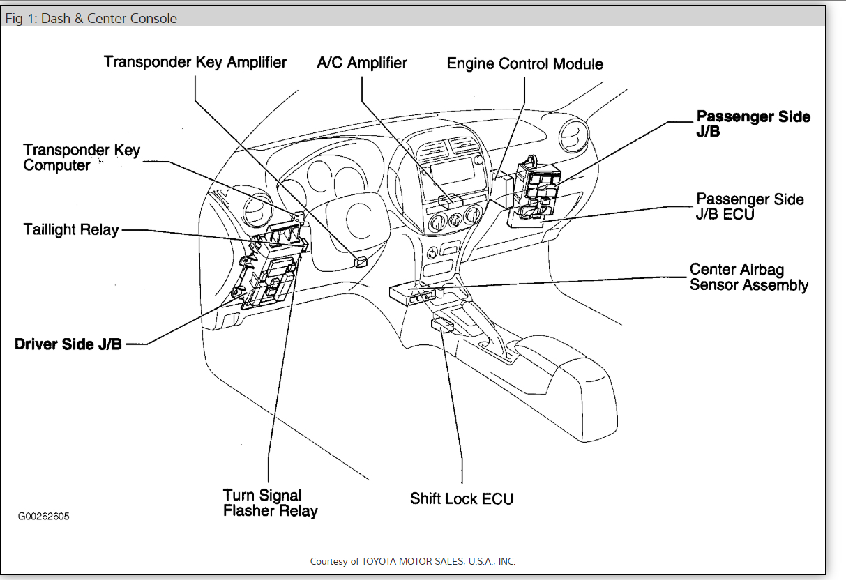

My problem is when I go to click the button to unlock the doors with the security fob it only opens back doors. It does not open front doors. And you have to manually unlock the front doors both inside and out. I am not sure what I need to check first the motor or is there an actuator? One more thing you can unlock the other doors from the inside from driver side just not passenger. Thank you for any help.

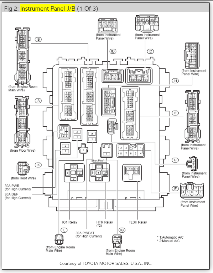

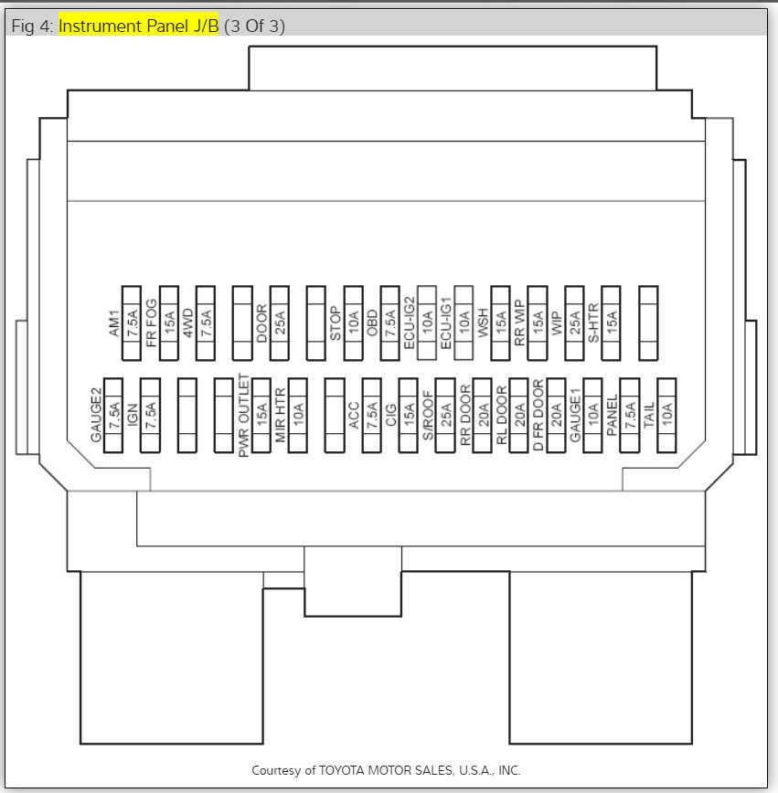

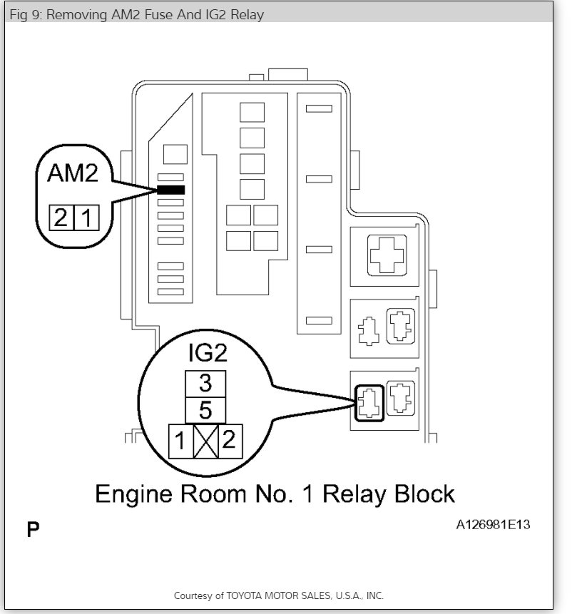

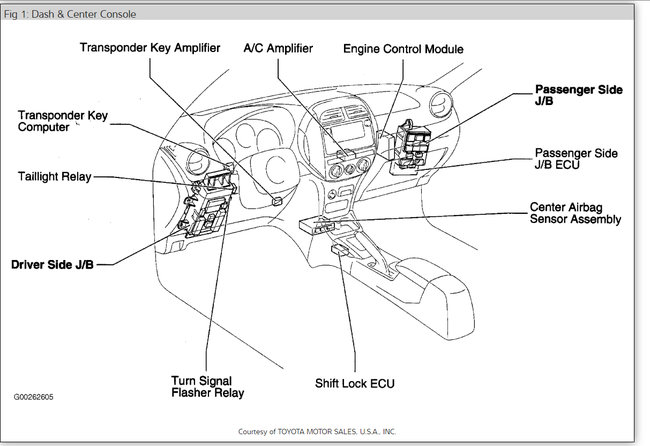

There are four fuses (dome-gauge-acc-door) that run the system. Lets start by checking those if all okay it sounds like the passenger side ECU is out. Here is how the system work check out the wiring diagrams below. You could have a lock switch that is out so lets test through it to confirm the ECU failure.
