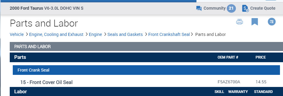

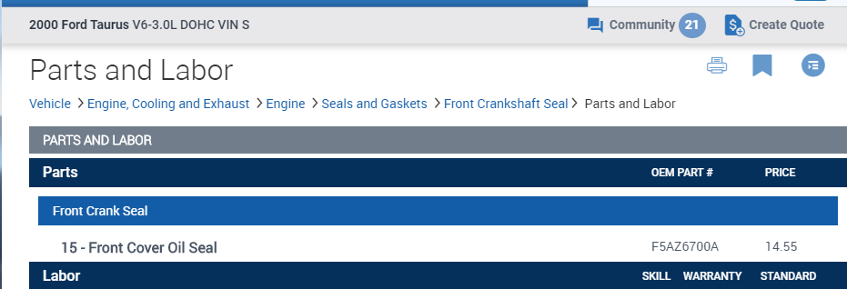

Do you have the DOHC, Flex Fuel (VIN 2), or the OHV VIN U)?
DOHC Crank Seal:
https://www.rockauto.com/en/catalog/ford,2000,taurus,3.0l+v6+dohc,1362811,engine,crankshaft+seal,5604
OHV and Flex Fuel appear to be the same. However, if you can measure the shaft, it gives you diameters so you can be sure to get the correct one.
https://www.rockauto.com/en/catalog/ford,2000,taurus,3.0l+v6+ohv,1362822,engine,crankshaft+seal,5604
If all else fails, call a dealer and give them your VIN and then will look the part up for your specific vehicle. Then you can either buy it there or cross reference it to get it somewhere else.

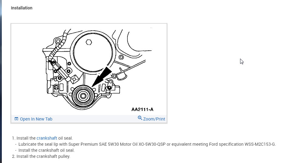

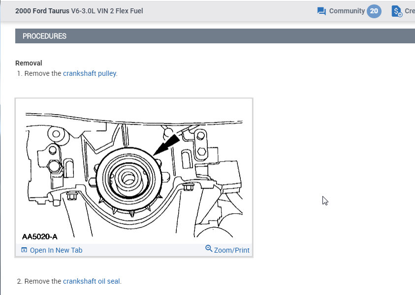

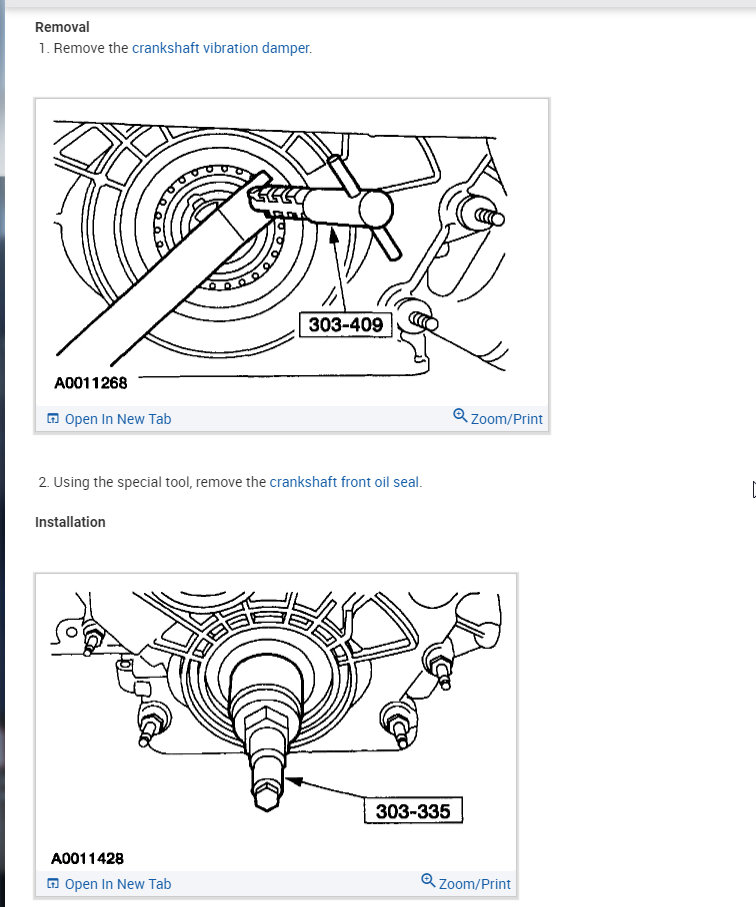

This guide can help walk you through the repair:
https://www.2carpros.com/articles/front-main-seal-replacement
