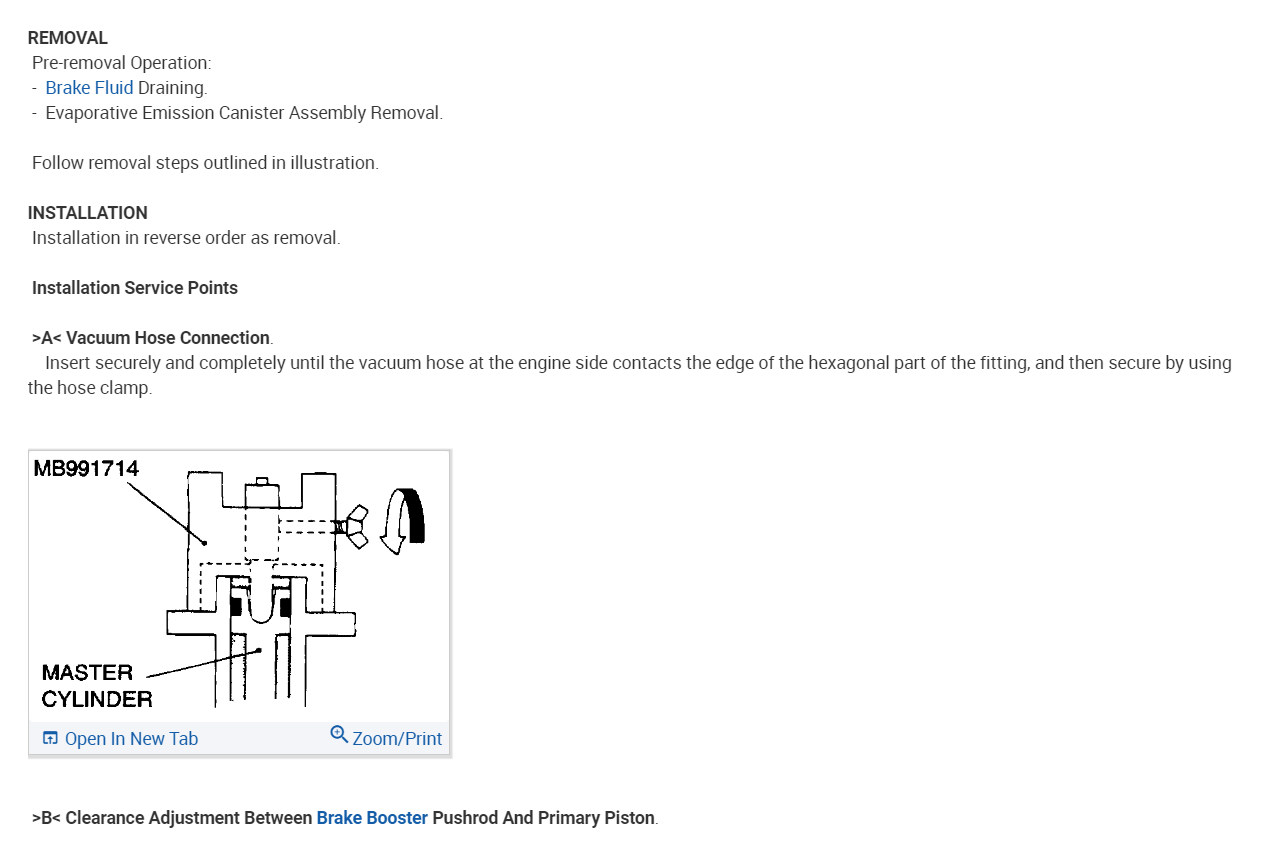

Hi, I owned the car for only a couple months. My brakes completely locked up (at least in the front) when driving at 45 MPH. I had to get all new pads, rotors, calipers, and hoses. The problem remained. As I'm driving after about 10 minutes, they slowly start to lock up again. I replaced the master cylinder and am having the same issue. I looked to see if I could adjust the push rod and to me it doesn't seem adjustable. When I remove the vacuum hose from the booster it does release the brakes and I can drive again until it starts happening after another 10min then I repeat the process and it releases the brakes again. I'm not sure if I need a new booster (which I can't find online) or if there's another issue going on. Any suggestions?
Aug 15, 2022 at 10:28 AM
  • 54,840 POSTS

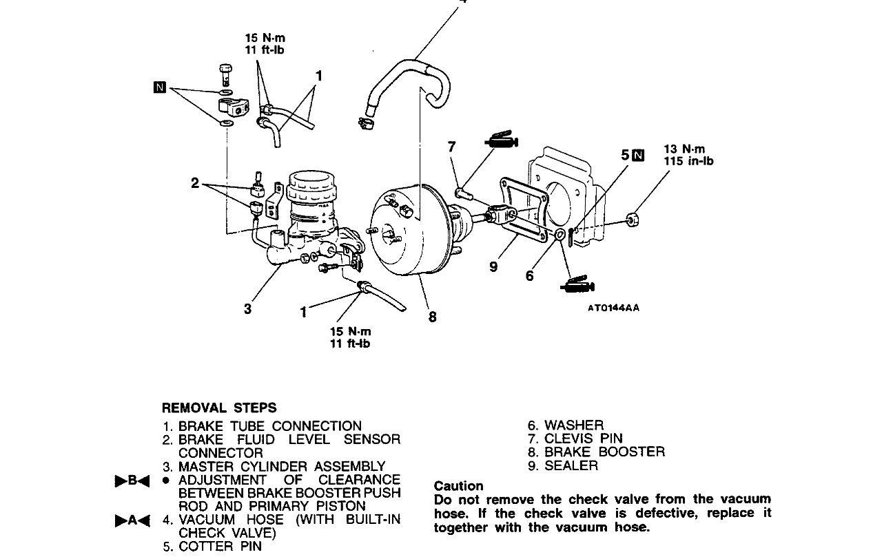

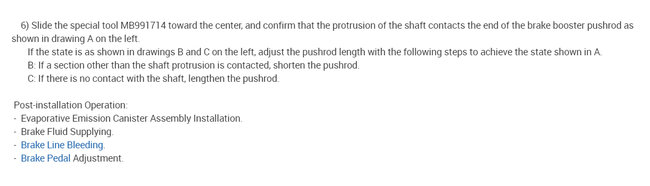

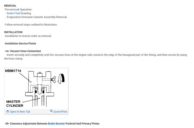

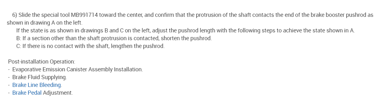

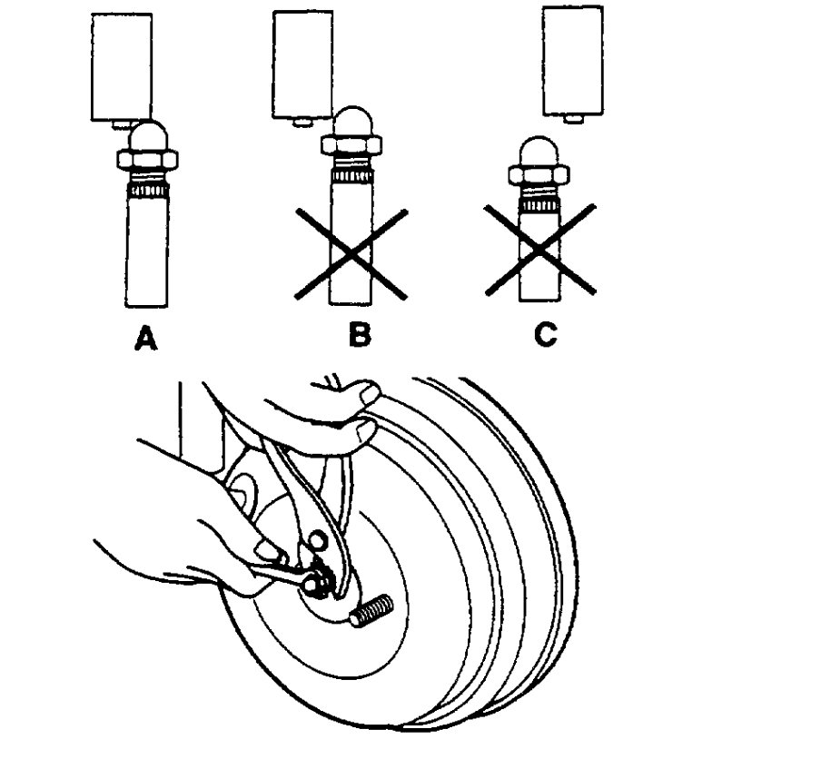

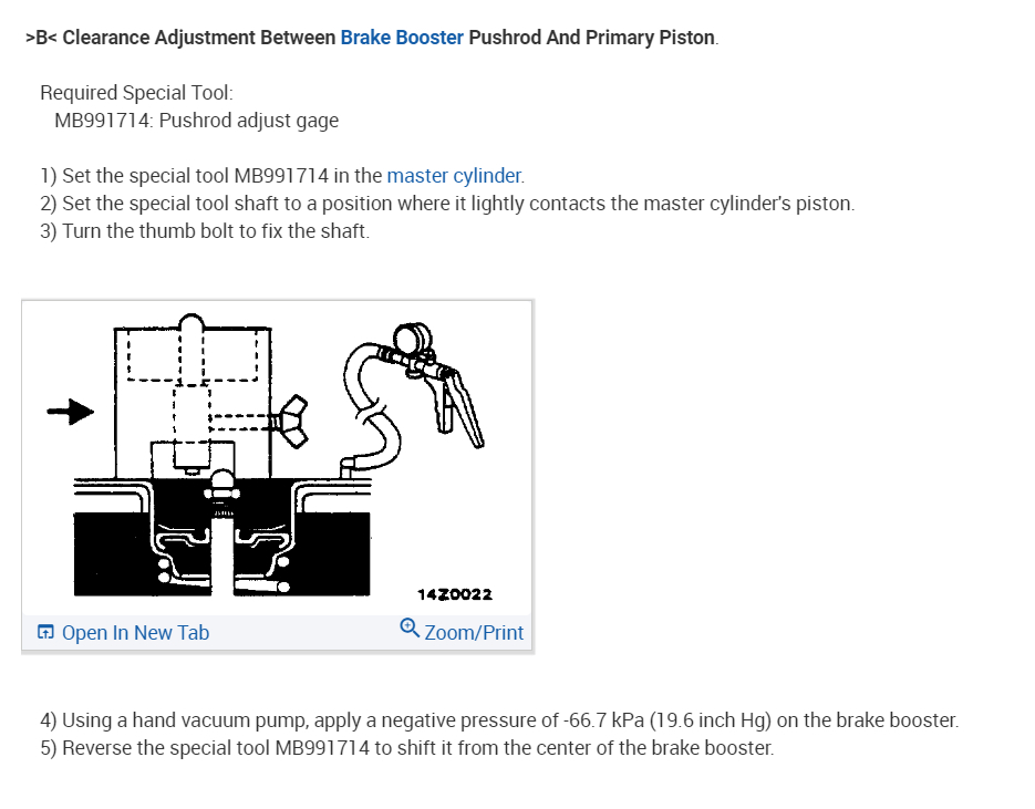

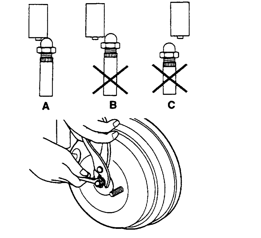

Yes, you need adjust the brake booster rod because the valve inside the master cylinder is not returning fully so it holds the brakes on. Here is how you can adjust the rod in the images below. Check out the diagrams (below). Please let us know if you need anything else to get the problem fixed.

Hi, I really appreciate your response and I feel that I'm on the right track, but I hope right now I've not done more harm than good. When I went to adjust the pushrod prior to seeing this diagram the pushrod came loose and was sort free floating inside the booster and I could nearly pull it out if it wasn't for a nut or something on the opposite side preventing it from being fully removed. I was able to get it sitting snug again just by pushing it into place, but I'm not sure that was supposed to happen. I wasn't able to break the rounded nut and spline looking thing on the pushrod with pliers. I can try again though. Is there any possibility it's on the brake pedal side of the booster? Is it more likely an adjustment than a booster failure or is there any possibility the issue is between the MC and brake lines? I installed the MC myself...seemed to go in fine etc. ...I'm no mechanic and even the mechanic I typically use suggested changing the booster since the MC didn't fix it (it seemed like all guess work for him) and didn't even suggest any adjustments. Is there any way the proportions are off between the rear drums and front disc's? Sorry to ask all of this but I'm trying to rule everything else out I can think of. All signs point to the initial suggestion though.
Aug 15, 2022 at 6:37 PM
  • 54,840 POSTS
You are on the right track, nothing other than what we are working on can cause the issue except for the brake pedal being held down somehow, can you reach down and pull the pedal upward? Also, the push rod inside the booster does come loose like that and can be reinserted into the booster which is okay. So, was this problem the same with both master cylinders?
