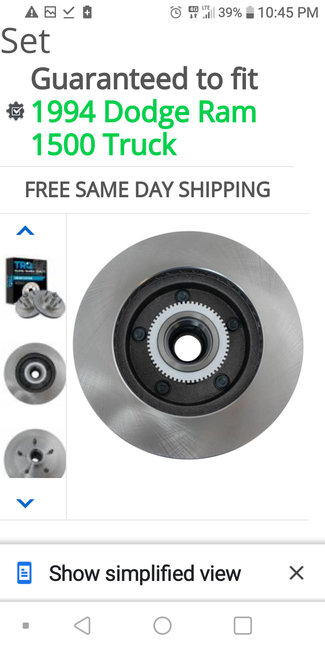

Can't find brake rotor. I bought one. It had ABS sprockets. Mine did not. I can't find one without. So can I remove sprockets. Or should I check 1993 Dodge truck rotor? Since I purchased it 1993. But it is a 1994.
Dec 18, 2020 at 2:56 PM
ANNA LEE MILLER

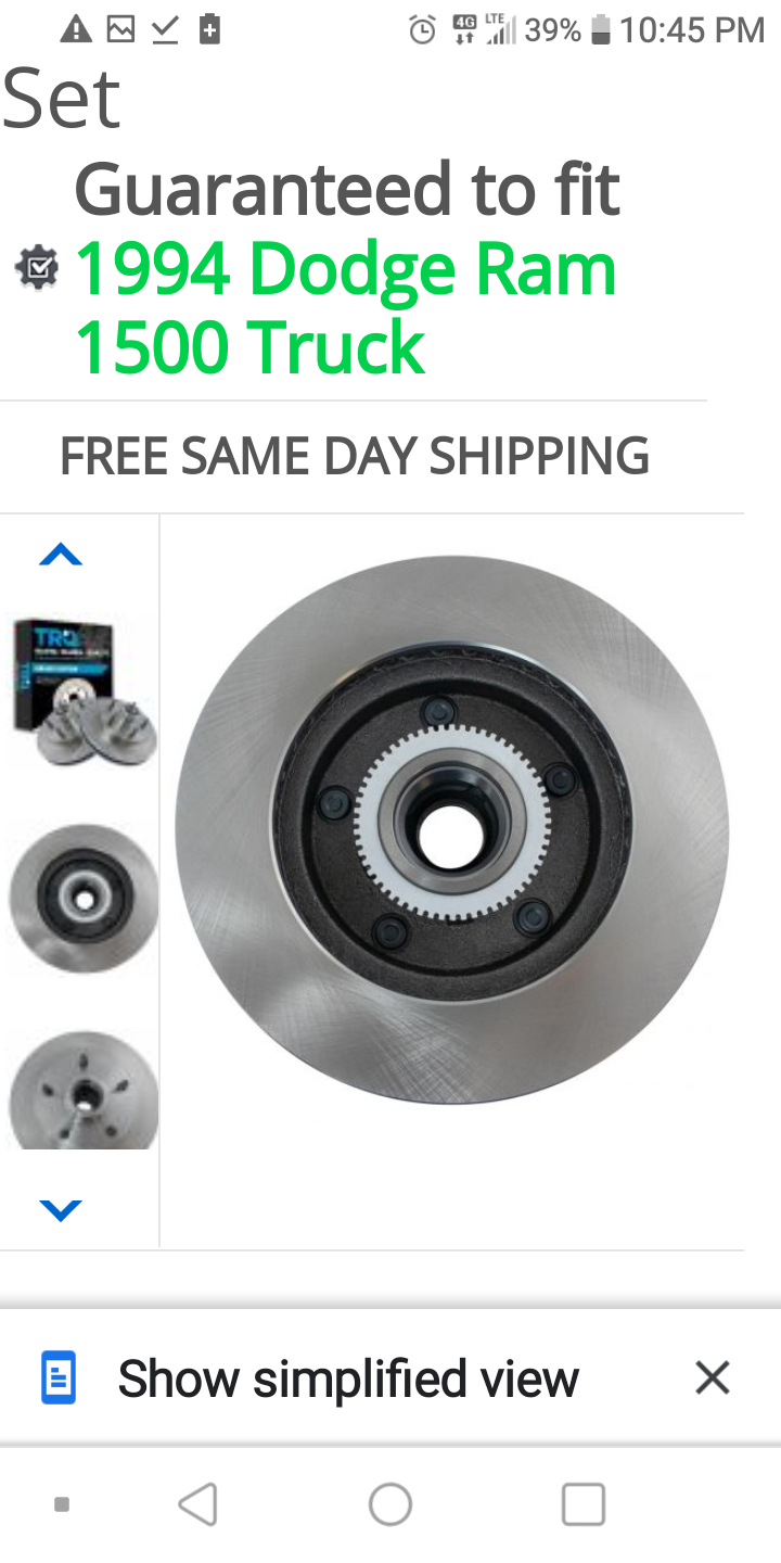

This is a picture of sprockets on new rotors. Mine doesn't have that.
Mar 30, 2021 at 2:36 AM
Yes, you are correct. The only difference of them is the sprocket. You can just use a 3 jaw puller and take it off. Also, if you just want to leave it, you can. It is not going to hurt anything because if you don't have the speed sensor then they are just going to spin and not bother anything.
