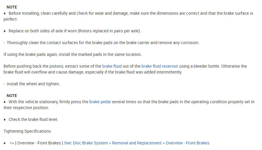

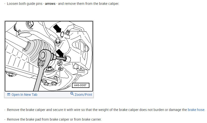

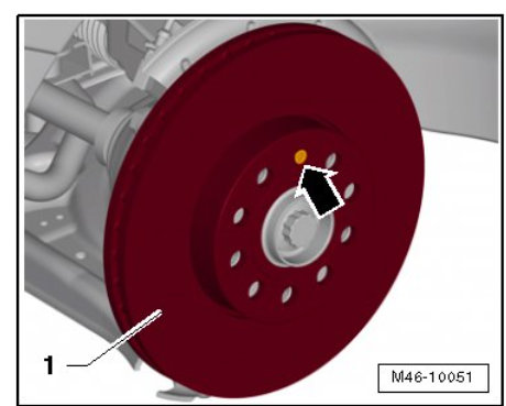

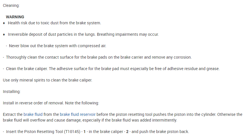

can just the front brake pads be changed w/o changing any other parts. I was told the rotors and hubs were one piece?
Jan 27, 2016 at 9:20 PM
DANNY L
  • 5,648 POSTS
Hello, I'm Danny.

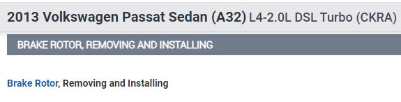

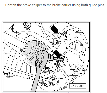

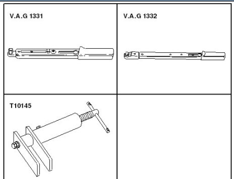

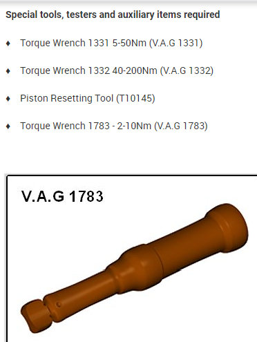

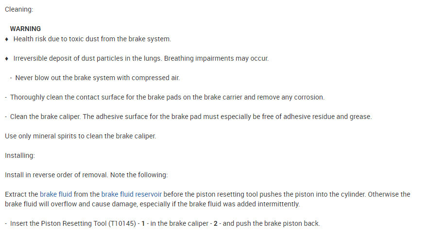

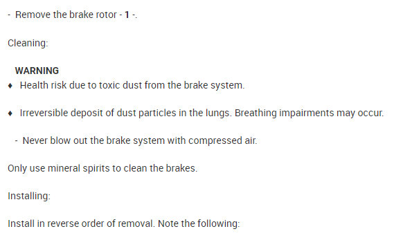

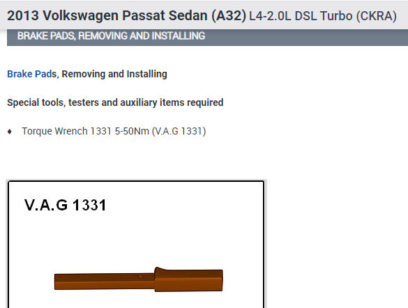

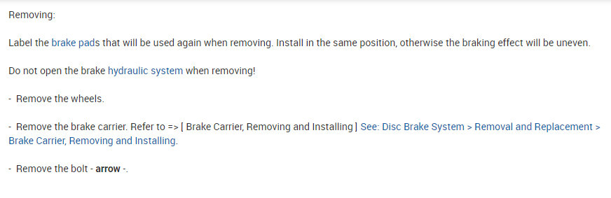

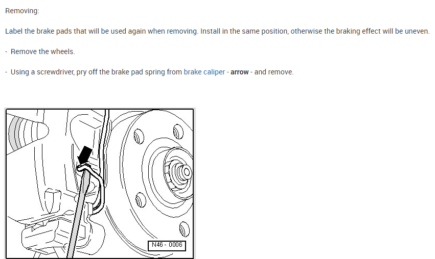

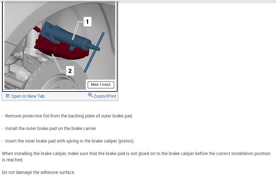

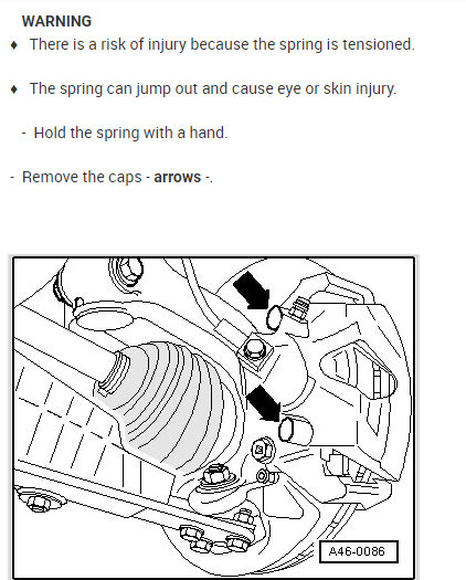

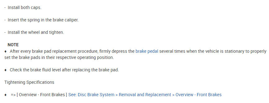

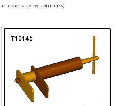

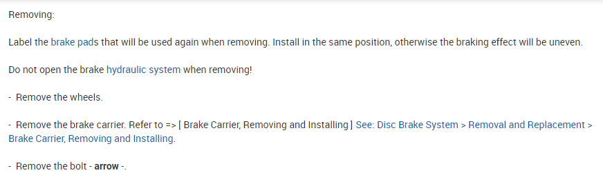

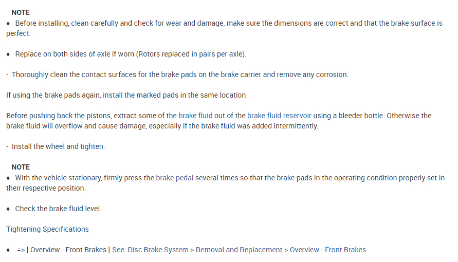

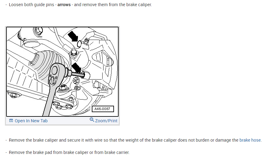

No, to answer your question the front brake pads and rotors are separate from each other. Here is a tutorial showing what is involved on how to change front brake pads and brake rotors:
I've attached picture steps below on how to change the front brake pads and rotors on your car. Hope this helps and thanks for using 2CarPros.
