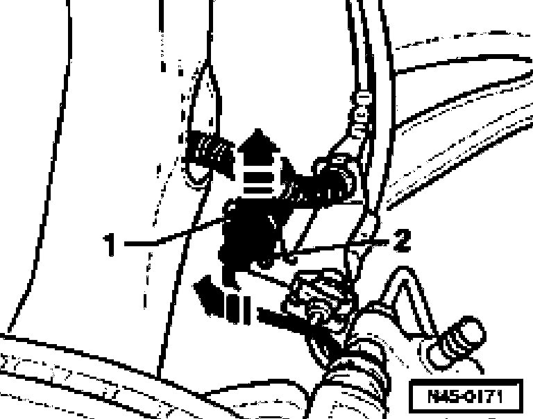

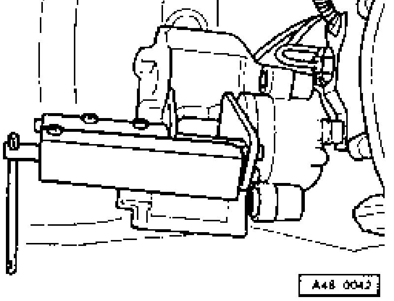

Front brake pads are not hard to replace. You can expect them to last approx 25,000 miles, but that can change based on driving habits and terrain.
First, here is a link that you may find helpful. It explains in general how it's done. You can use this as a guide.
Here are directions specific to your vehicle. The attached pics correlate with the directions.

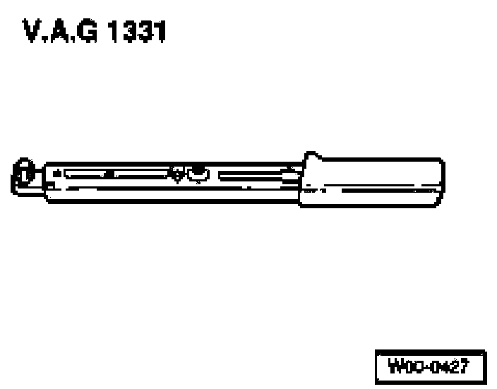

^ VAG 1331 Torque wrench (or equivalent)

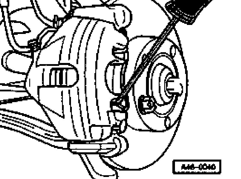

Note: When reusing brake pads mark location and install in same position, otherwise uneven braking will occur!
pic 2

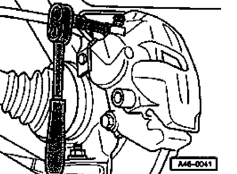

^ Remove protective caps -arrows-.
pic 3

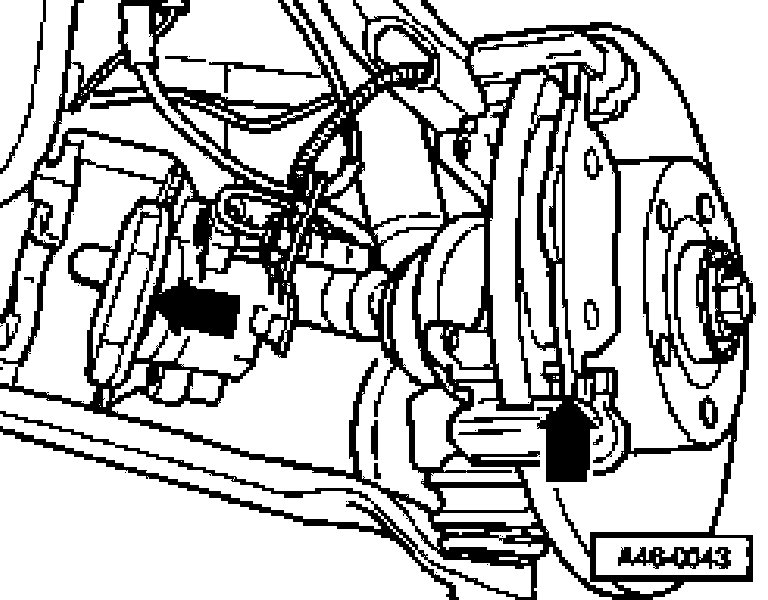

^ For vehicles with brake wear indicator disconnect the connector -1-.
^ Lift locking tab slightly on connector lower part -2- and then turn 90°.
^ Pull connector lower part out of bracket.

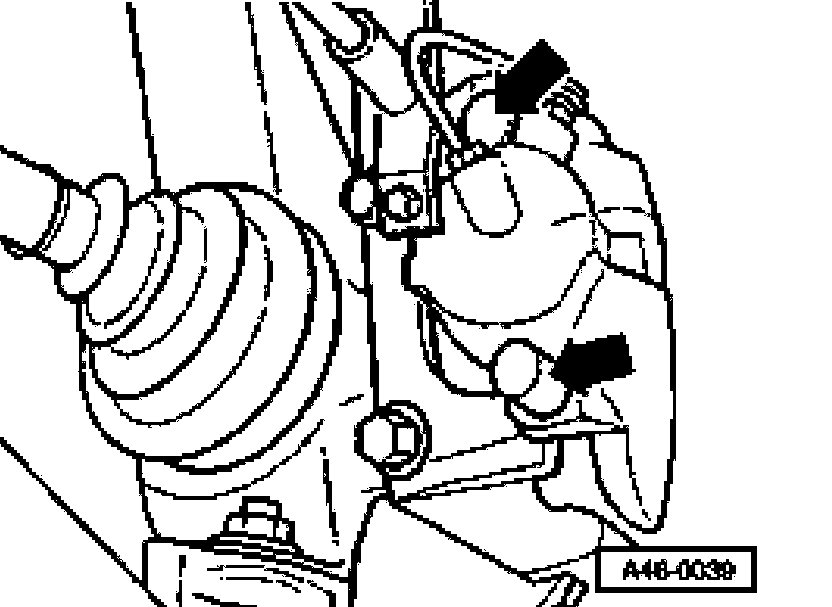

^ Using a screwdriver pry off brake pad retaining spring from brake caliper housing and remove.

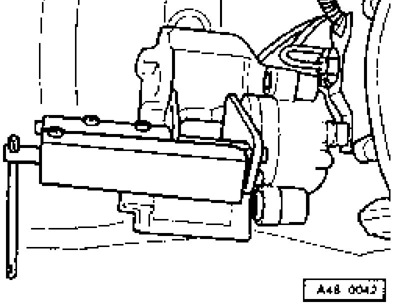

^ Remove both guide pins from brake caliper.
^ Remove brake caliper housing and lay to one side so that the weight of the brake caliper does not stress or damage the brake hose.
^ Remove brake pads out of brake caliper housing or from brake carrier.

pic 7
^ Insert brake pad with retaining spring in brake caliper housing (piston).
Note: The inner pad (with spring) has an arrow. The arrow must point in the direction of the forward rotation of the disc brake. May create noises if incorrectly installed.
^ Remove protective foil on backing plate of outer brake pad.
^ Install outer brake pad to brake carrier.
