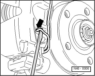

- Using screwdriver, pry off brake pad retaining spring from brake caliper - arrow - and remove.

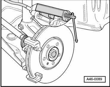

- Separate the connector - 1 - for brake pad wear indicator.

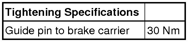

- Remove caps - arrows -.

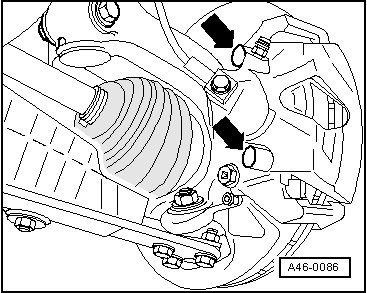

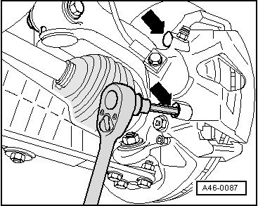

- Loosen both guide pins - arrows - and remove from brake caliper.
pic 4
- Remove brake caliper and secure with wire so that the weight of the brake caliper does not burden or damage the brake hose.
- Remove brake pad from brake caliper or from brake carrier.

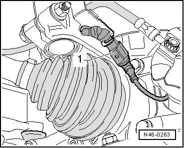

Before pressing piston into cylinder using piston resetting tool, brake fluid must be extracted from brake fluid reservoir. Otherwise, especially if reservoir has been topped off, fluid will overflow and cause damage.
- Press piston back.

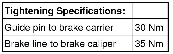

- Tighten brake caliper to brake carrier using both guide pins.
