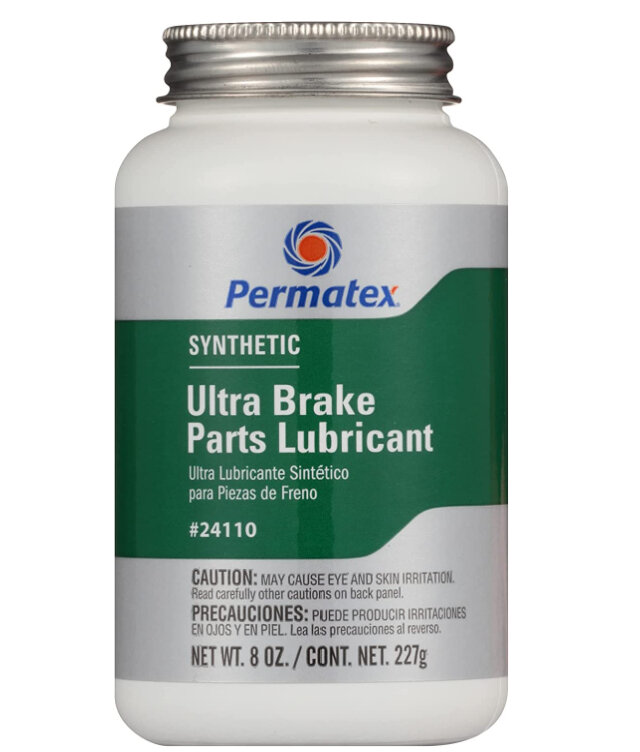

Also, what kind of grease did you use? Was it a high temp brake grease?
I use Permatex myself I will add a picture of it for you. The grease that comes with the pads is usually not that great and can break down with heat if it isn't made to the right specs.
If too much is used on the slide pins, the caliper may not compress fully since grease isn't compressible. If one pin has more than another, it could cause the caliper to tweak and cause noise.
