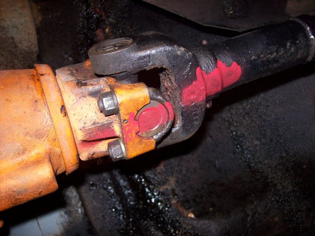

CJ MEDEVAC
  • 11,004 POSTS

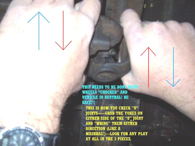

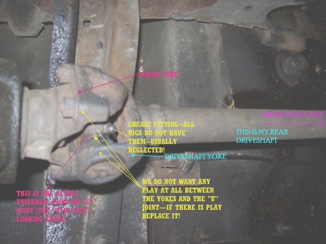

Have you checked the u-joints on either end of the drive shaft?

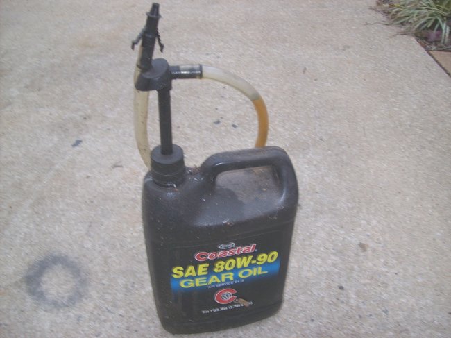

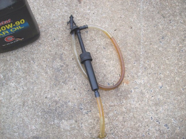

Gonna leave you a few pics,
1-2) a pump you can get for $5-$7 at a parts store to make it ez-ier to install the fluid (disregard the type I'm using SATURNTECH9 will tell you what you need)
3-4) checking a u-joint, chock wheels, put it in neutral
I'll let y'all continue!
The Medic

The u-joints were one thing I thought about, thanks for the images, I'm new to the 4wd drivetrain, hopefully it one of the two, I got kinda confused thought, I asked a ford dealership what type of differential fluid to use and he asked for the last 8 digits of the vin and looked it up and told me to use 80-90 on both front and rear, but autozone's computer recommended a different type, which do you think I should use? And should it be synthetic limited slip? Thanks.

I would go with what Ford tells you also you need to ask Ford if you need to add there additive for limited slip for the front or the rear.Also I use Valvoline synthetic gear oil when I change rear end fluid.Usually when a u joint is that bad it will make noise when putting it in drive with your foot on the brake.But check the u joints.

TMCINTOSH11
  • 176 POSTS
Looks like it's the rear u-joint, it has some play in it, it should be an easy job, if I can unbolt the yoke from the rear axle that is, but if all goes well it's gonna save me $$$$$$$$$ in labor, I'll just have to get the drive shaft rebalanced.

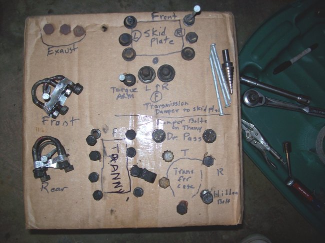

SATURNTECH9
  • 30,869 POSTS
I always mark how everything was lined up before I took it apart?
Aug 16, 2016 at 3:33 PM
CJ MEDEVAC
  • 11,004 POSTS
SAT-TEC
Good thing you are on here, I always get carried away assuming the other guy does what I do, keeping things straight, inspecting, and cleaning, I reckon that too is part of the fix.
I have a 'nuther couple of how to put parts back into their original positions.
The Medic
