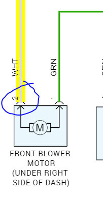

If the vehicle is hot when starting, the front fan will not work at any speed?
2016 ACURA MDX
140,000 MILES • 3.3L • V6 • 4WD • AUTOMATIC
DANBKARL
The rear fan still works. When the vehicle is cold the front fan works and will keep working until, I restart the vehicle.
Nov 25, 2023 at 4:28 AM
  • 110,244 POSTS
The fan has a relay that powers it. However, I don't feel that would be causing the issue. At the blower motor itself, there is a white wire and a green one. When it isn't working, turn the key to the on position (engine off) and check the white wire for power when the fan is requested on.
here is a link you may find helpful:
Let me know what you find.
See pic below.
Nov 25, 2023 at 1:38 PM
