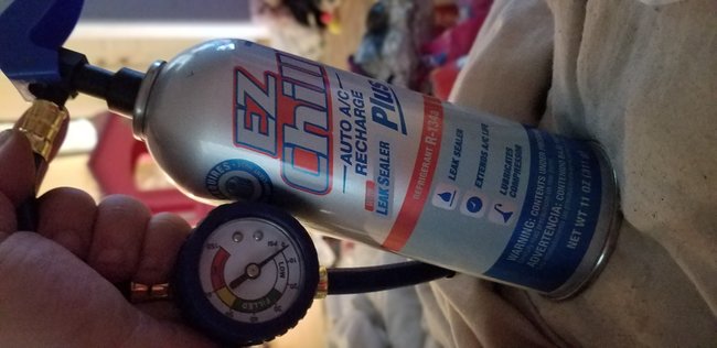

We just put Freon in today that's the picture that showed green.
Wednesday, June 3rd, 2020 AT 5:31 PM
LMAX2014
  • 19 POSTS
Never mind just checked and it says no Freon.

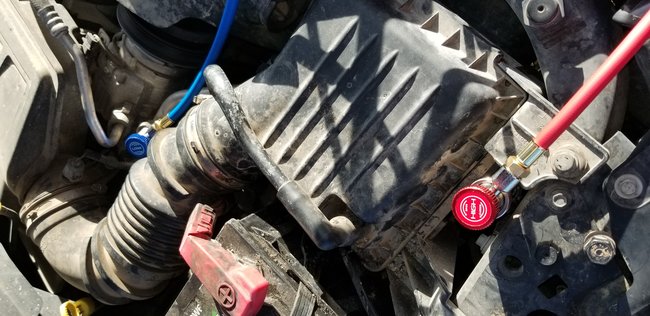

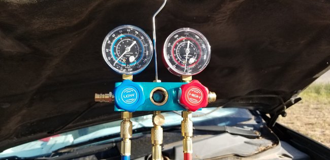

Okay. Give me the high and low side readings with the compressor running.

Went to put more Freon as suggested pushed the nozzle down and the gauge went to yellow, I pressed again and it went to red then down to yellow. I didn't want to press it all in there and put to much Freon because we had just put an 11 oz can in there earlier that day. Either the manifold gauge set (i ended up finding and buying, brand new) doesn't work or something is wonky
Thursday, June 4th, 2020 AT 10:08 AM
  • 52,797 POSTS
Okay, the third hose attaches to the can to be added. Once you attach the can, then open both low and high side valves for the Freon to enter.
Do this with the engine off, not running
