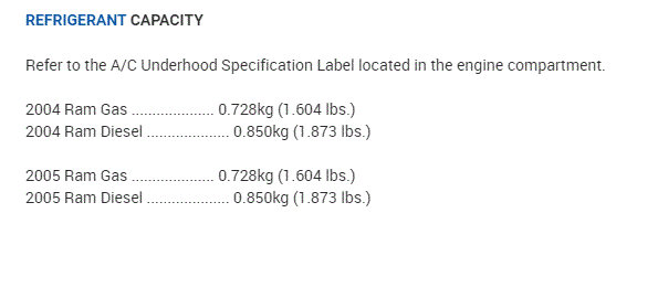

What should my A/C high and low side be on the truck listed above 1500? can you provide me with the capacity chart, in case I need to ad Freon? Thanks

Good afternoon,
First, you cannot tell Freon level by pressures.
https://www.2carpros.com/articles/air-conditioner-how-to-add-freon
The high side should be 2 times ambient temperature plus 15%.
The low side should be 25-30 pounds rock solid.
I attached the specs for you below.
What is the issue?

So how do I know if it needs Freon? The issue is the A/C is blowing cold, but not as cold as it use to it feels like so I think it may need Freon. I have never added Freon before so I wanted to make sure I know how to do it properly if it is low on Freon so as to not over charge the system. Thanks
Apr 23, 2021 at 4:08 AM
The only way is to recover the Freon and see how much was recovered.
Then you need to evacuate the system for 1 hour and charge the exact amount.
You cannot tell Freon level by pressures.
