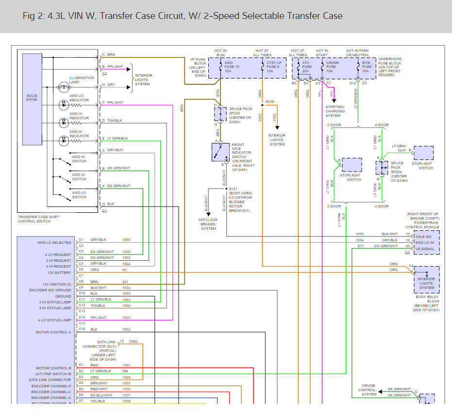

transfer case wiring diagrams my vehicle will not go back into two wheel drive
2001 CHEVROLET BLAZER
170,000 MILES • 4.2L • 6 CYL • 4WD • AUTOMATIC
AMY ROSS

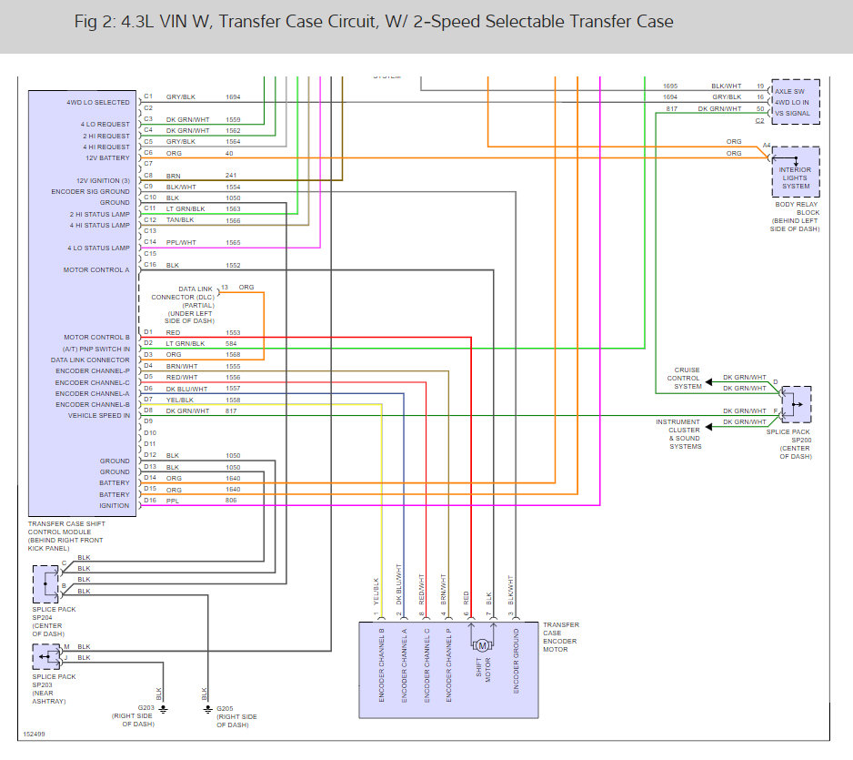

i changed my transfer case control module and now my vehicle will not go back into two wheel drive. it is stuck in neutral position, when i try to change positions with the switch it blinks and all the lights go out, then my service light comes on.
Dec 24, 2017 at 1:52 AM
  • 55,423 POSTS

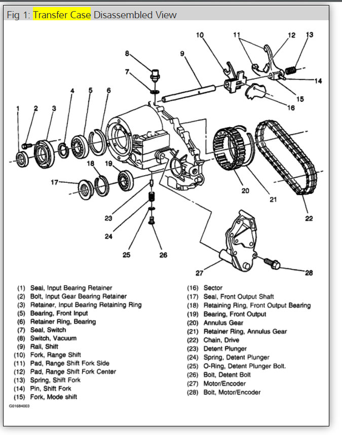

Is sounds like you have a fuse or the transfer case encoder actuator is out but to be sure lets run a simple test. There are five fuses that run the system.
Check to see if the encoder is getting a signal and if so replace the actuator.
You will need to raise the car up safely to get the job done.
