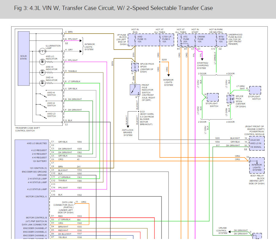

My Blazer is stuck in 4 low. If I push the button for 2 wheel it flashes then goes back to 4 low. I have checked the relay wiring and also have disconnected the negative cables to try and reset computer. No luck. I was told that the majority of the time it is the actuator as they have a history of going out before the vacuum switch. Is there a way to tell which it is without having to spend 70 bucks for a diagnostics. Or is there possibly a fuse?
Thanks
Don
May 11, 2010 at 4:36 AM
BMRFIXIT
  • 19,053 POSTS

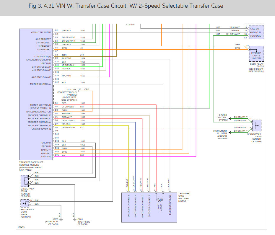

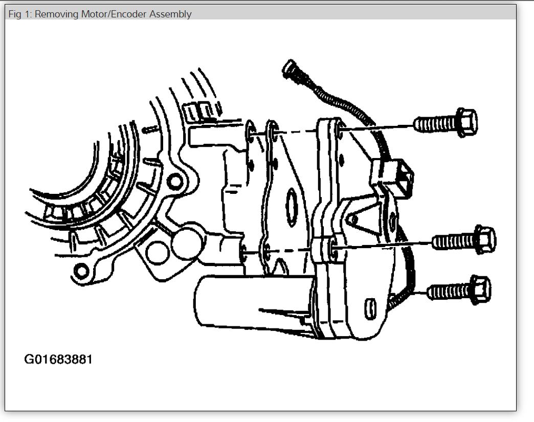

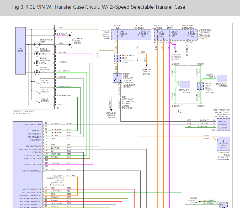

The transfer case encoder go out on these trucks but to be sure here is the wiring diagrams and a guide so you can check for power and ground to confirm the failure.
It might be the controller.
Check out the diagrams (Below). Please let us know what happens. Cheers,

Yep it was the encoder motor it took me about an hour to install and cost me $145.00 all fixed! I love this site.
