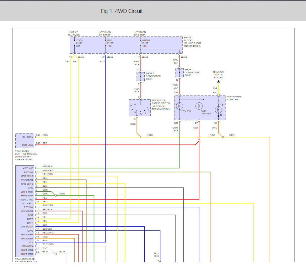

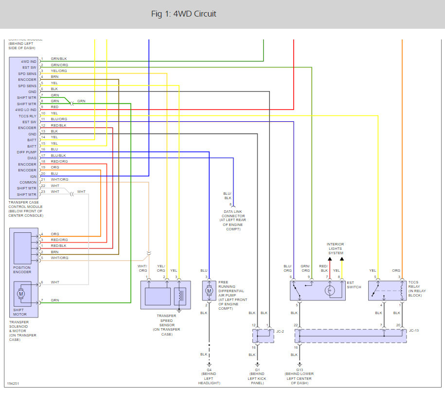

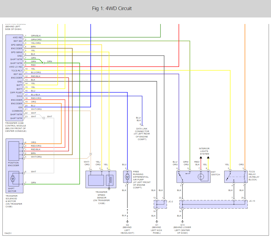

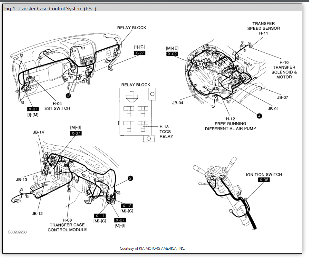

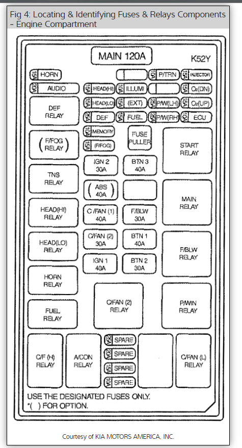

four wheel drive not working
109,000 MILES • 2.5L • 4 CYL • TURBO • 4WD • AUTOMATIC
DAFYDD HIGGINS
the four wheel drive does not come on no light nothing.
Aug 2, 2017 at 4:07 PM
  • 55,737 POSTS

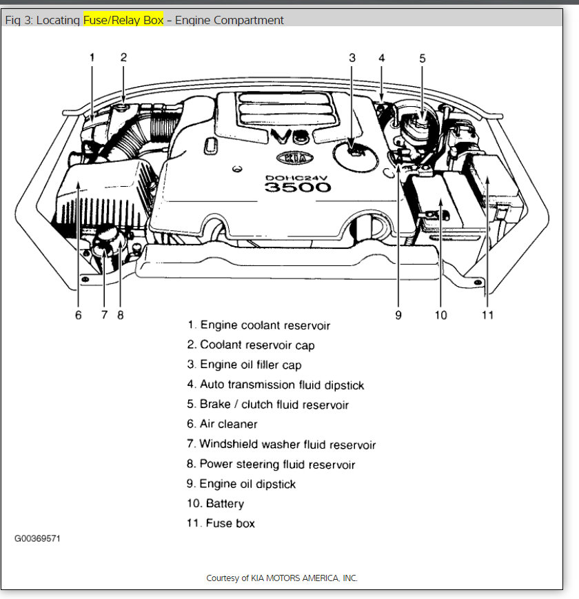

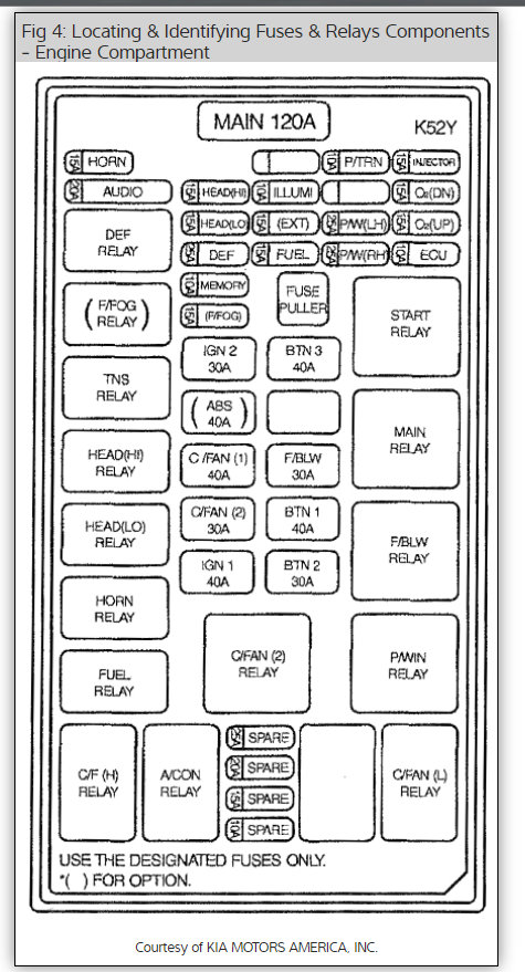

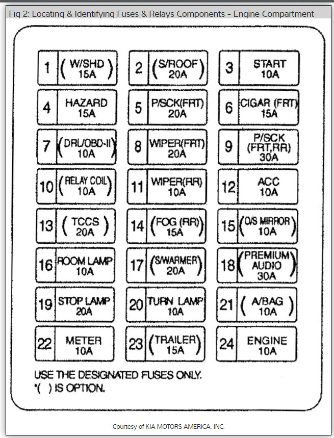

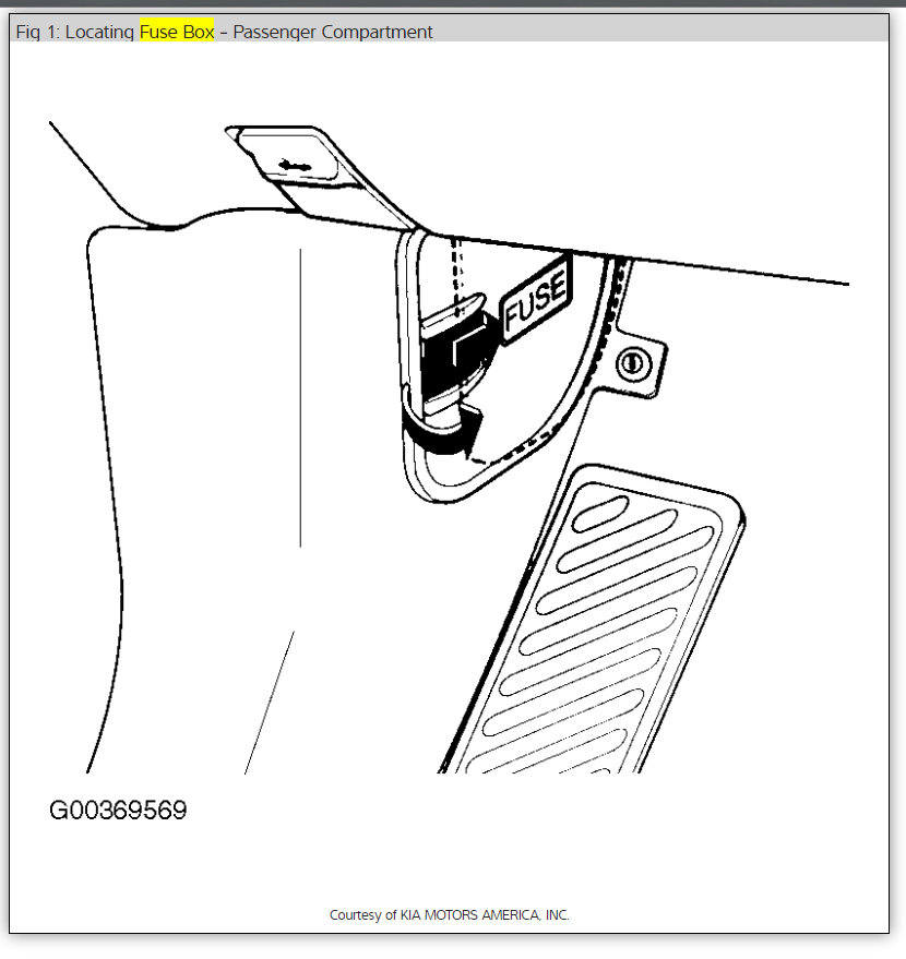

It sounds like you lost power somewhere or the transfer case module is out. To confirm the problem please follow this guide and check out the diagrams (Below).
and
Aug 3, 2017 at 8:14 AM
